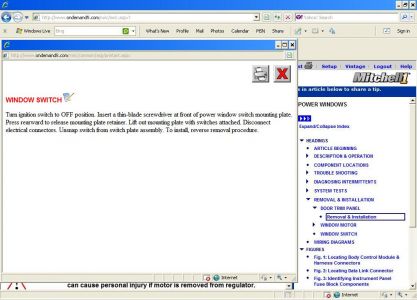

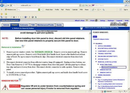

Our rear window on the drivers side has come off track. I can't seem to get the panel off. How do i get the door panel to come off?

https://images.2carpros.com/forum/automotive_pictures/416332_2001_buick_regal_LS_door_panel_removal_1.jpg
https://images.2carpros.com/forum/automotive_pictures/416332_2001_buick_regal_LS_window_switch_removal_1.jpg
This is for the regal LS model the GS looks like same instructions.
