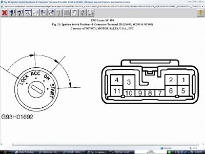

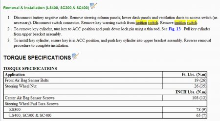

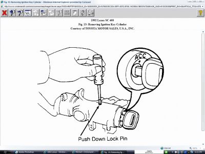

I have a SC 400 and need to change the IGNITION -SWITCH please tell me how its done, it has 220,000 miles
Dec 8, 2007 at 8:36 AM
MERLIN2021
  • 17,250 POSTS
The following comes from Toyota, via Mitchell on Demand...if you have air bags, disable them by disconnecting negative cable for 2 mins, If the car has RADIO codes, retrieve them first! Your radio won't work again till you punch them in, this is mostly German trypes, but you never know!
