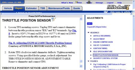

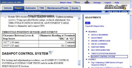

Hello guys, I just put on a new throttle position sensor on my 1991 lexus ls400 and now its shifting hard when i put it in drive. I know it has to be at a certain degree but i dont know the answer to that. maybe you guys can help. thank you Derrick, Jax fl.

Hi Derrick and welcome to 2carpros Good Luck -below is the instructions to set the TPS
https://images.2carpros.com/forum/automotive_pictures/12900_tps_25.jpg
https://images.2carpros.com/forum/automotive_pictures/12900_tps1_10.jpg
https://images.2carpros.com/forum/automotive_pictures/12900_tps2_8.jpg
