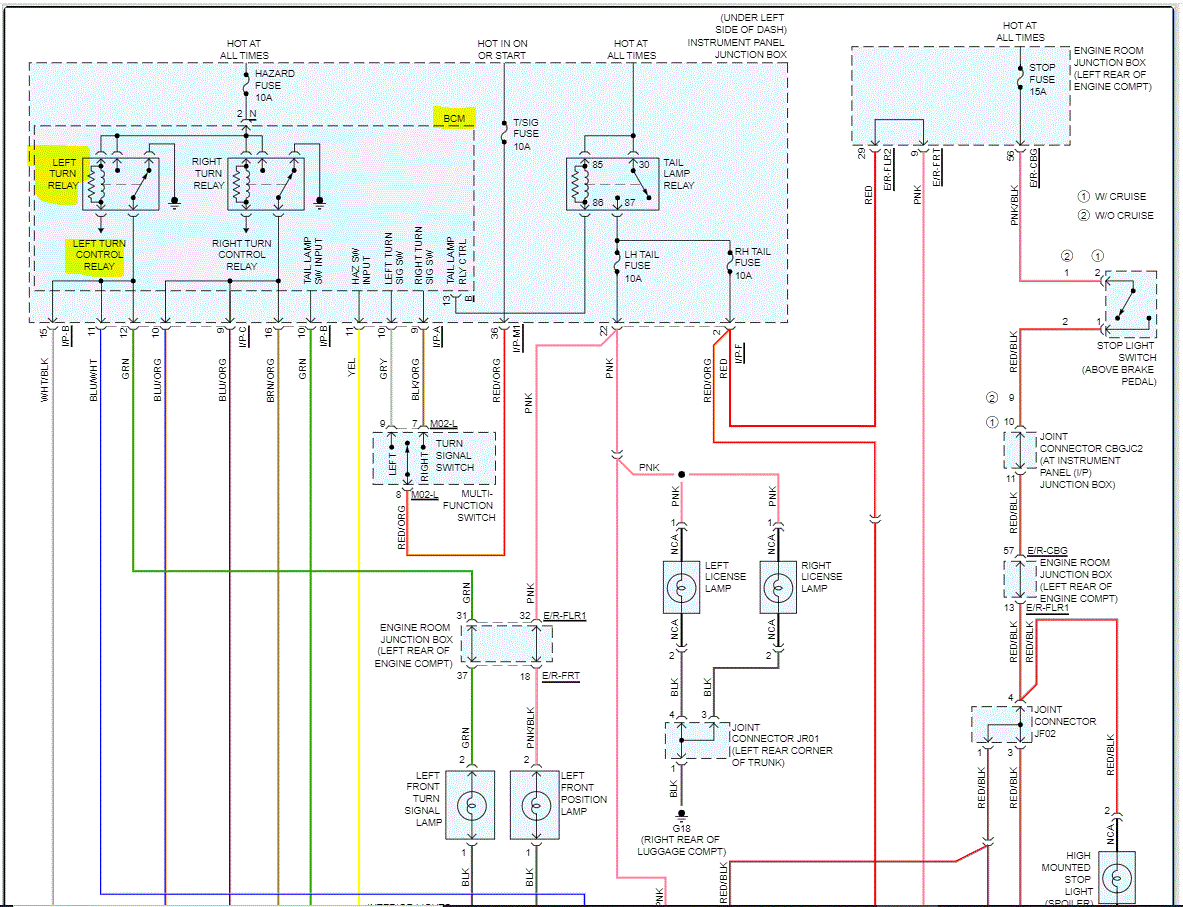

If the BCM is being considered as a cause, then the best thing to do is go to the BCM and check for power out at the wires indicated in pic 1 below. That is the wiring schematic for exterior lighting. It does indicate a left signal relay, but I don't believe that is something that is replaceable.
Let me know as much as you can and if you have other questions.

To add a bit to Joe's answer, neither front nor rear work, correct? A quick test will tell you if it's the switch, turn on the hazard lights, does it now flash? If yes it isn't the BCM but could be the switch. If neither the turn nor hazards work, then it's likely the BCM's internal relay that has failed. It is not a user replaceable part though as it is soldered inside the BCM.

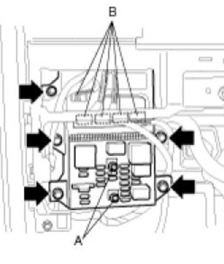

Okay, if you turn on the left signal you can hear the BCM click like it's turning on the signal? But no lights except once in a while, What about the dash indicator? Does it flash on the left side or is it the same, one flash now and then? If so, then it's likely that the contact on the relay or the wire that feeds the moving contact inside the relay is bad. I would probably say to use https://www.car-part.com/ and look at salvage yards near you and see if anyone has an 07 on hand. The ETACS module isn't hard to replace and unless you have the optional alarm, I don't believe it needs programming. You basically disconnect the negative battery cable, remove the trim panel in the driver's foot well and remove the connectors from the ETACS, then remove the 5 bolts and pull the unit down. Replace it by reversing the process.
