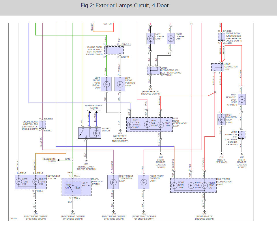

Our left turning signal light is not working neither outside or indicator on dash. The right one is. Can you help?
Monday, May 31st, 2010 AT 11:59 AM
13 Replies
BLUELIGHTNIN6
  • 16,542 POSTS

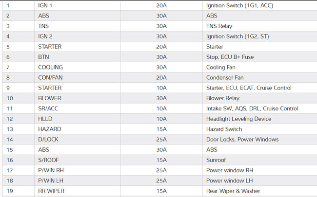

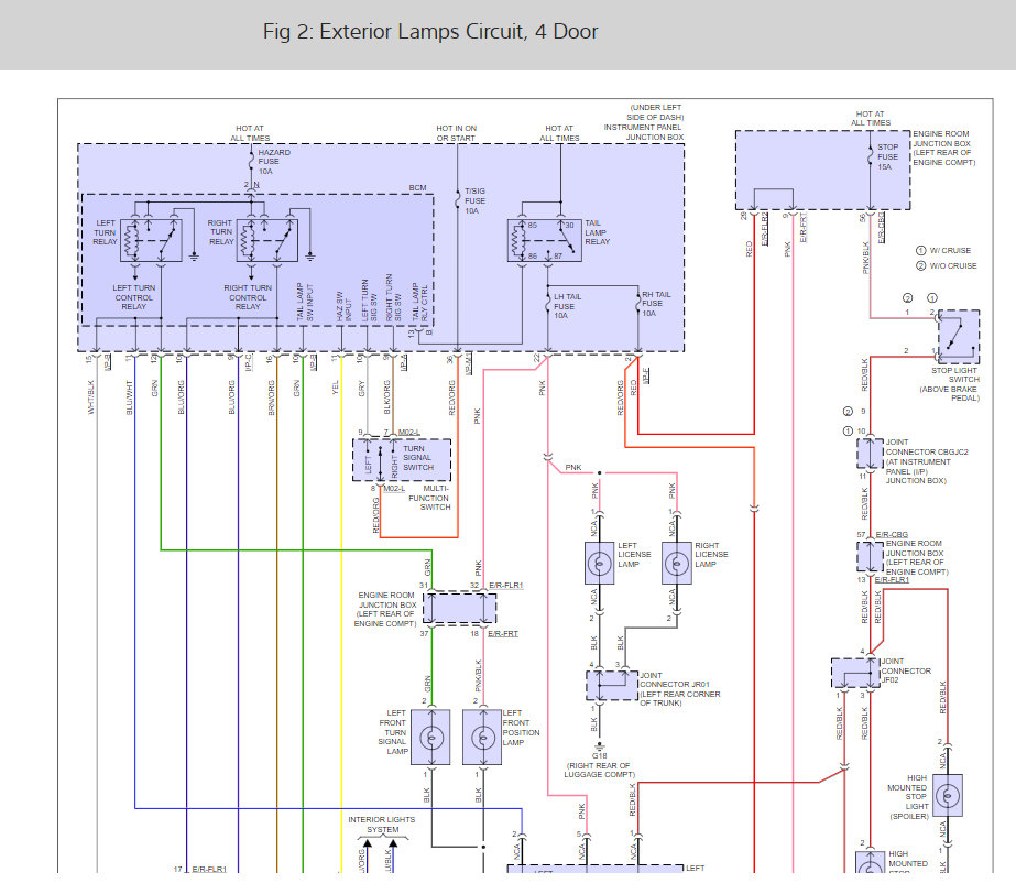

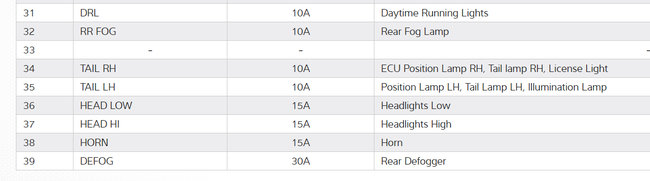

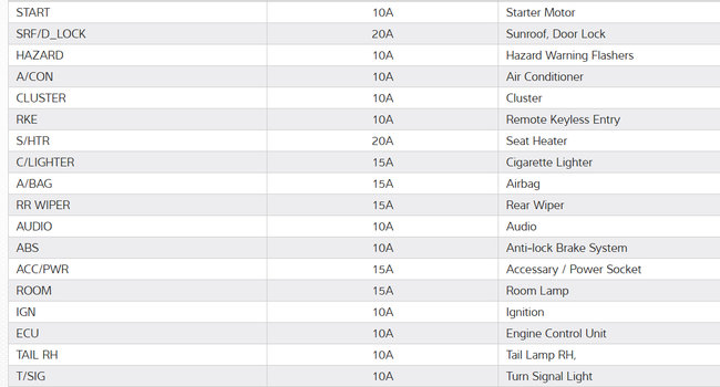

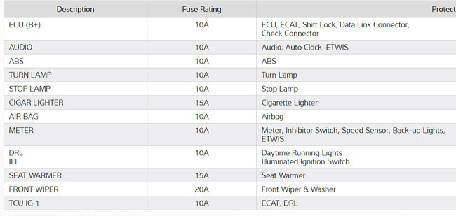

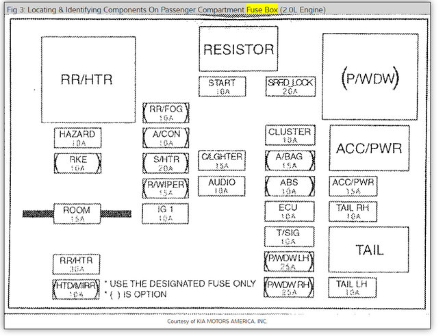

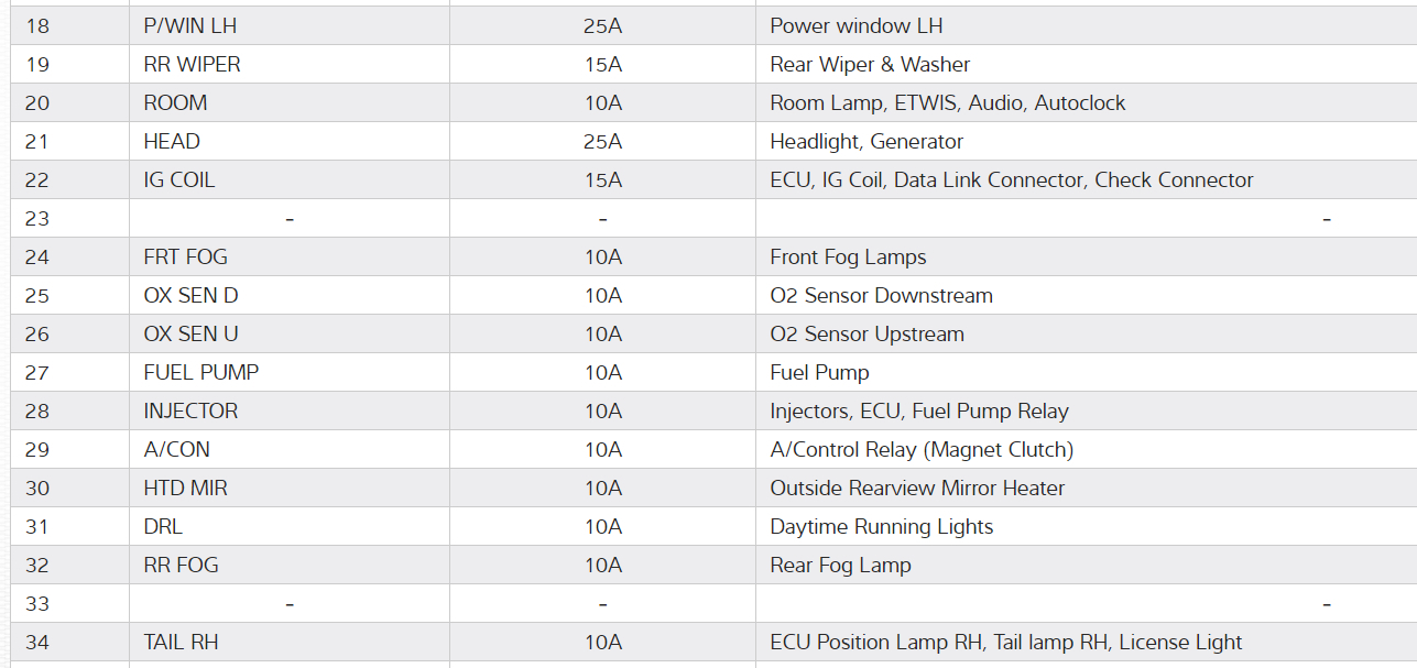

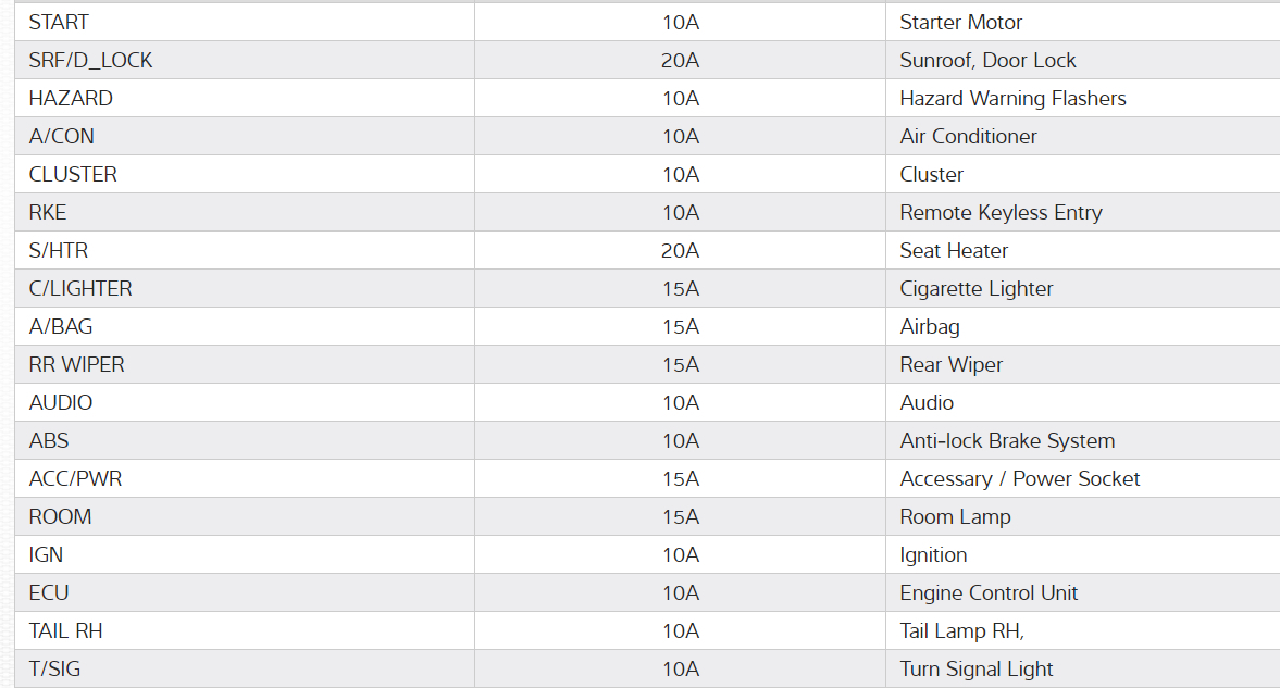

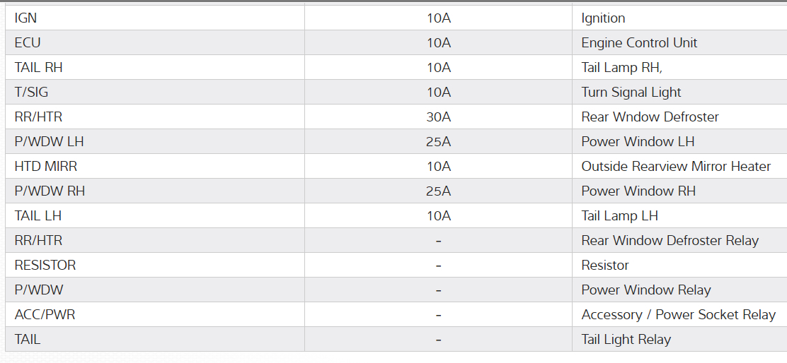

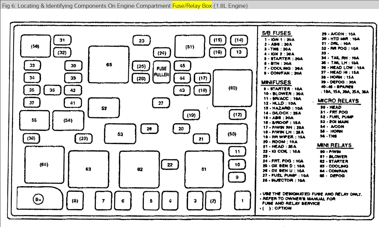

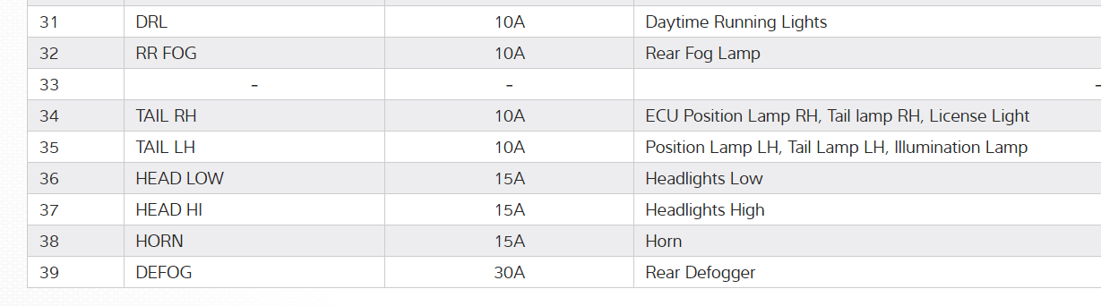

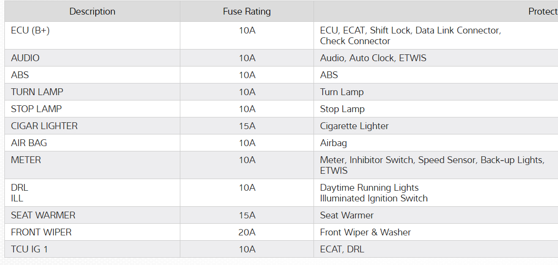

There is a left hand turn relay and fuse that needs to be checked here are tow guides to help test for power at the fuse and how to test the relay with wiring diagrams for the blinker so you can see how they work and the relay locations as well below.
and
Check out the diagrams (Below). Please let us know what you find. We are interested to see what it is.

Thanks for this post I had to get a new relay cost me $34.00 all fixed! I love this site.

My turn signals just stopped working and I've checked the fuses and put known good ones in to replace it and still my turn signals do not work. When I set the alarm on my car they work but they do not work inside or out when I use the turn signal or the hazards. What could be causing this?
+2
Tuesday, January 22nd, 2019 AT 11:19 AM (Merged)
KEN L
  • MASTER CERTIFIED MECHANIC
  • 54,494 POSTS

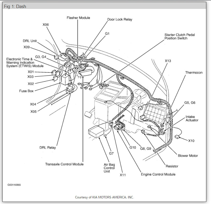

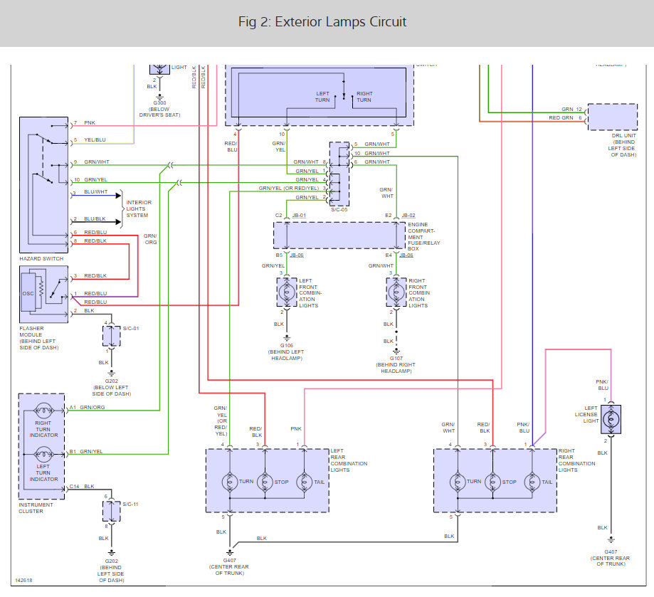

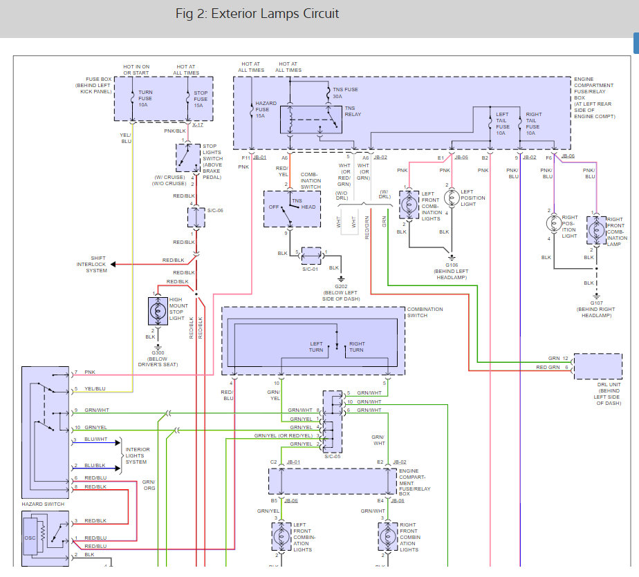

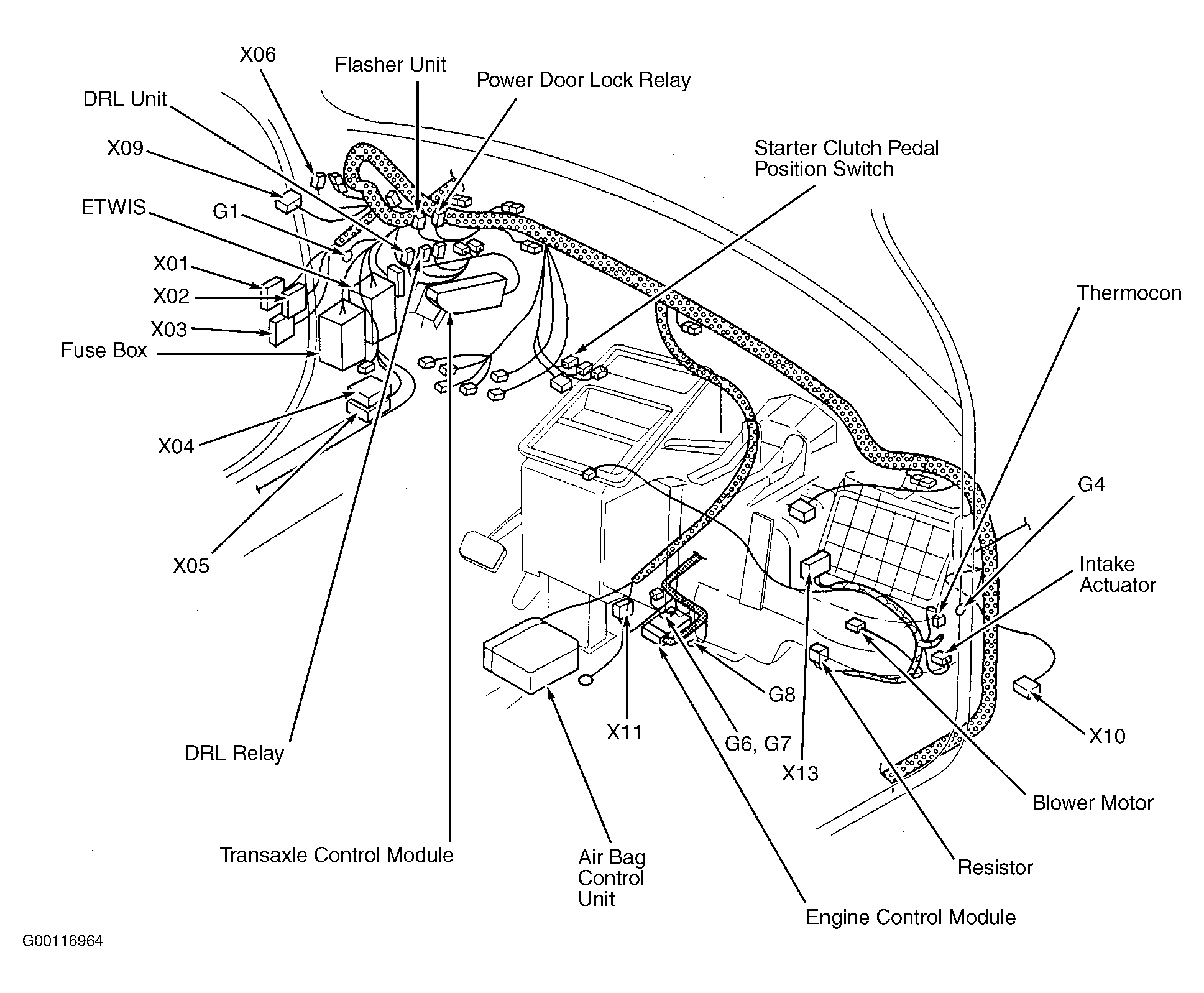

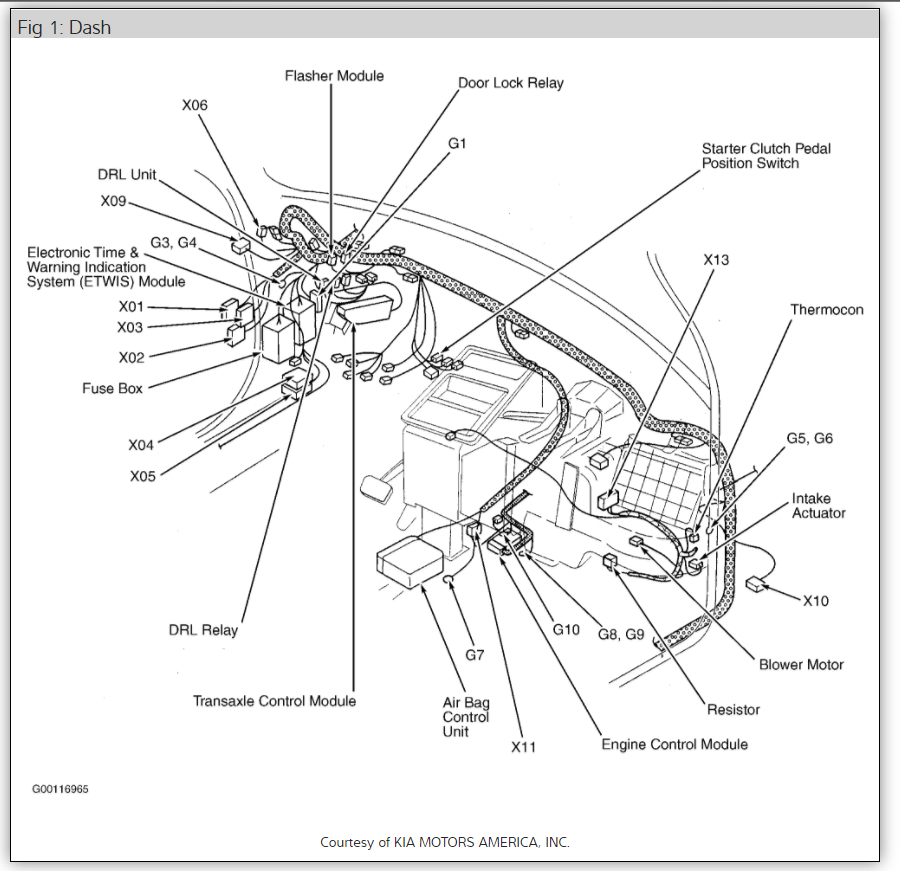

It sounds like you have a flasher module that is out. But to be sure we must check to see where we are losing power. here is a guide to show you how:
Here are the blinker wiring diagrams and the flasher location.
Check out the diagrams (below)

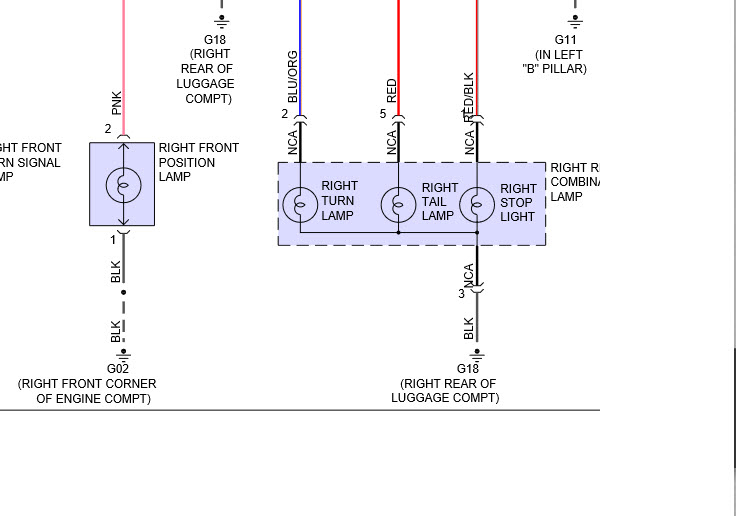

My girlfriend's car was having turn signal issues, indicating one of the turn signal bulbs were burnt out in the rear. I checked in the trunk to see how easy it would be to replace the bulbs and pulled out the break light and right turn signal bulbs from the rear of the vehicle and then replaced them. On the way to the auto parts store, the right turn signal suddenly started working.
Working off of prior electrical knowledge, my first thought is a broken wire somewhere in the turn signal. I checked the bulbs a second time to make sure the issue was not being caused by the broken filament suddenly jostling into place from my screwing around. I found the turn bulb in nearly pristine condition, but noticed one of the filaments in the break light looked worn. I don't see how a break light could cause the turn signal to act as if the bulb is burnt out, unless if the bulbs are wired in series together.
I was wondering if anyone had any knowledge of the electrical systems on the KIA 2007 Spectra line. I can replace all of the bulbs and see if the issue doesn't come back, but I would like to eliminate the seemingly obvious possibility before dragging the car into a dealer to check the entire line on a vehicle nearly a decade old.

All three on that side ground in luggage compartment check that for tight and not corroded. There is a right turn signal control relay check the prongs for corrosion. Relay is in junction block inside car left hand side.

-Check the flasher unit behind left side of dash
