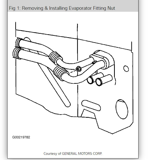

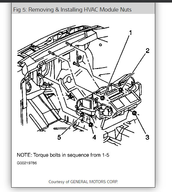

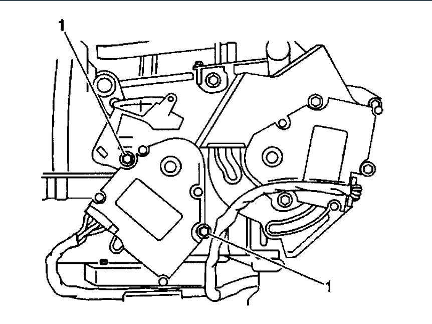

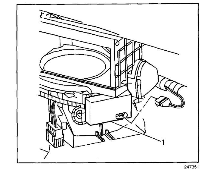

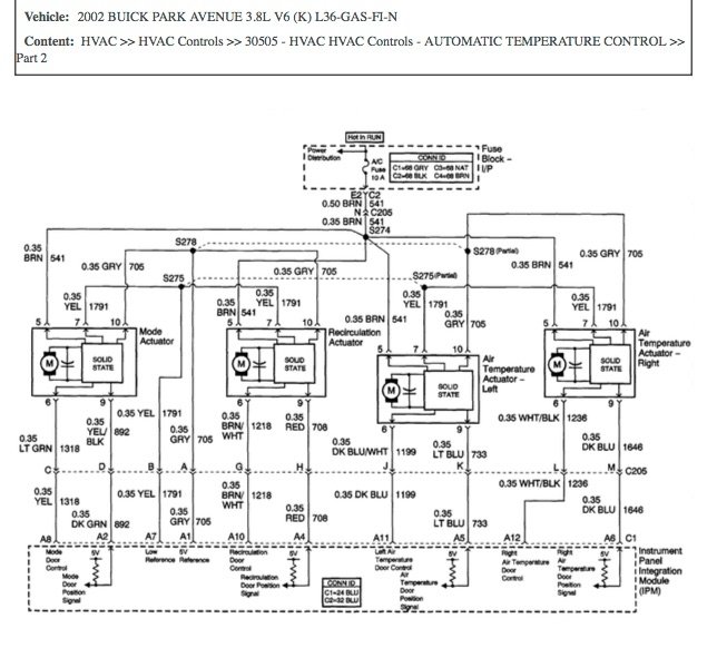

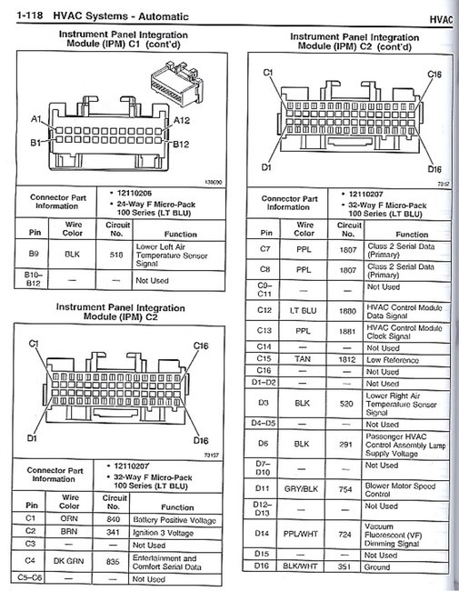

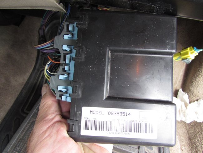

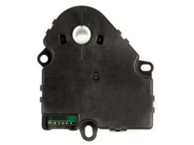

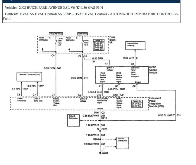

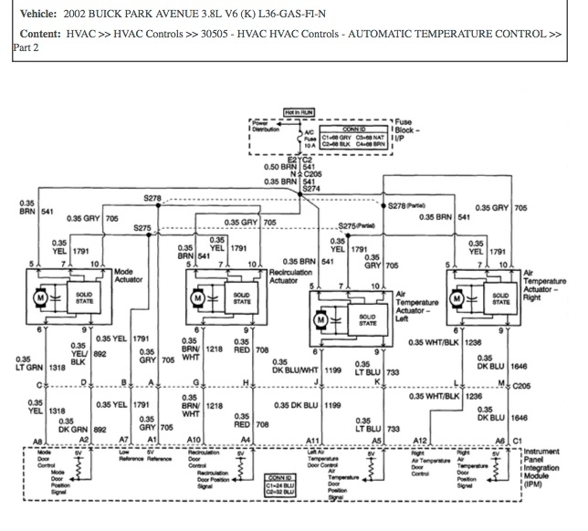

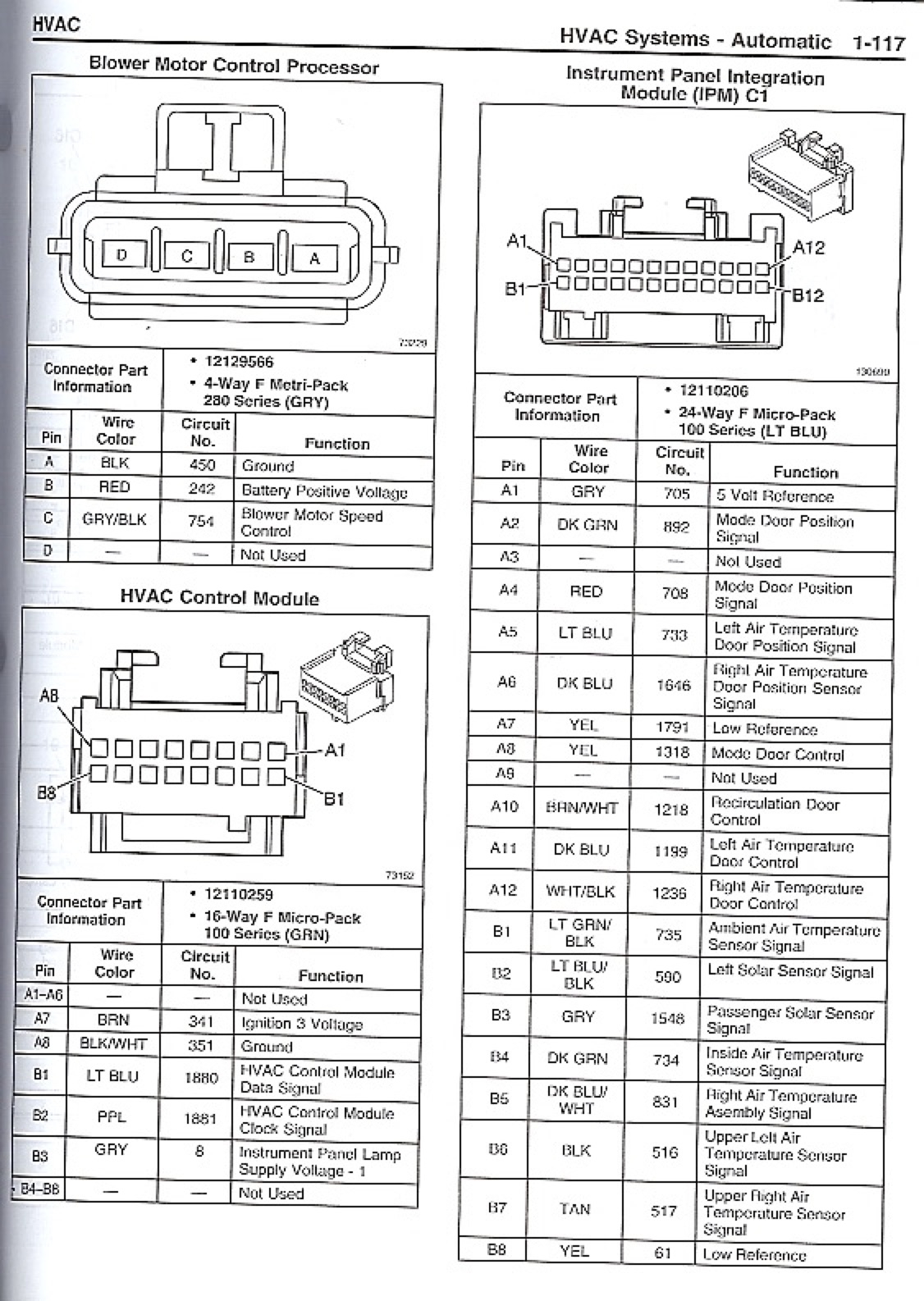

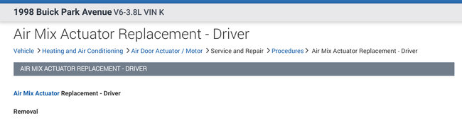

Which module did you replace? I attached 2 pictures for you. Can you identify what was replaced?
Jul 22, 2020 at 9:38 PM
RON G
I would agree a junkyard part is of unknown quality and I try to diagnose and verify a problem and not take the route of throwing parts at it but I have been unsuccessful at identifying the issue, other mechanics I have contacted are unable to identify the problem, and if I were to purchase new parts I doubt a $500.00 bill would cover the parts alone not to mention flashing the unit, the auto part stores I have checked don't have a listing for the HVAC module making it a dealer part, and I would not be able to return parts if they did not correct the problem.
Being the junkyard parts are acting exactly the same as the modules that were in the car I think it is highly unlikely I would have found modules with the exact same issues. Short of purchasing new modules I suppose I could reaffirm the modules were not the issue, by returning to the junkyard and trying modules from different vehicles if they also make no difference I would be confident the modules were not the issue.

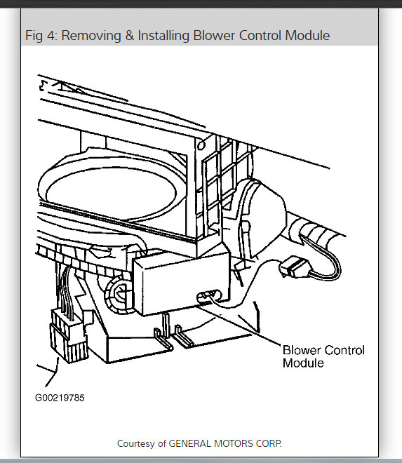

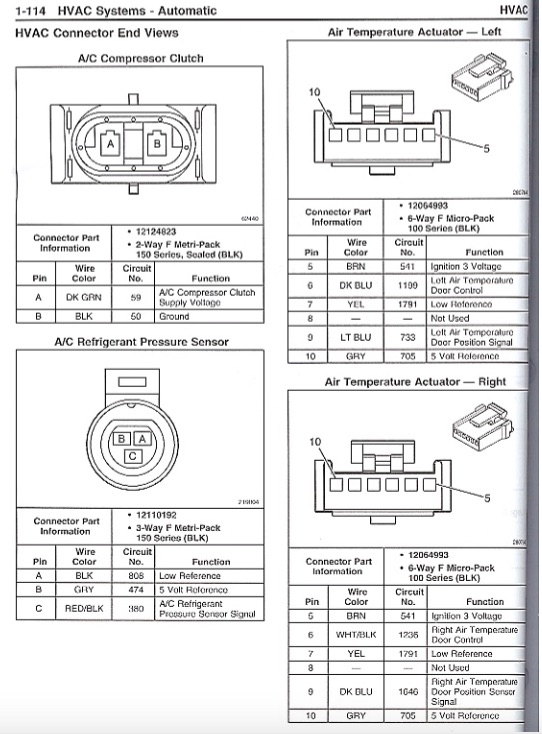

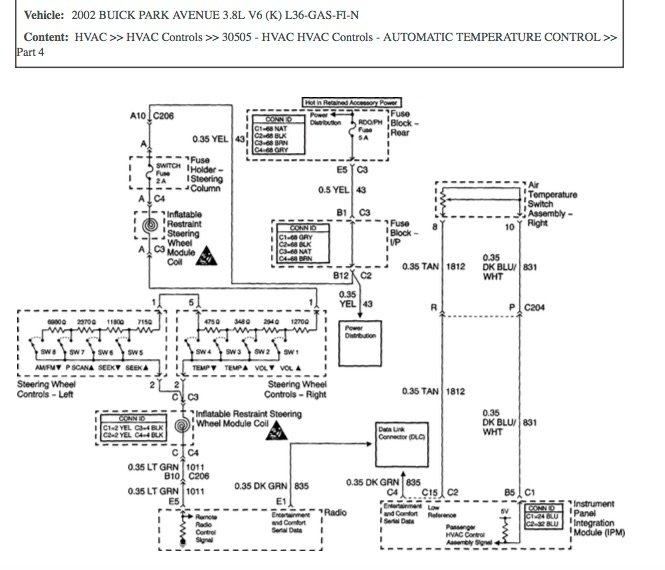

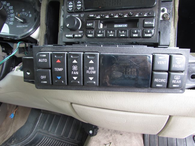

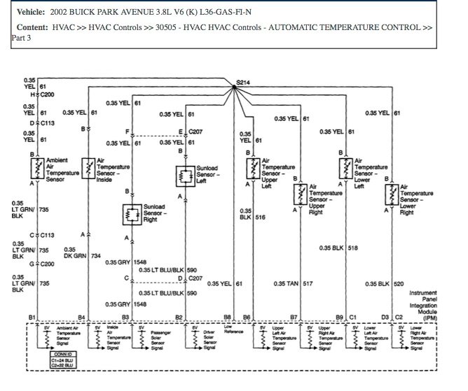

The pictures below are of the modules I had replaced the originals are now back in place. I have also included a component locator diagram from my shop manual it's a little different than the one you sent, the view is looking at the location of the IPM module from the viewpoint of the firewall under dash in area of glove box.
Since I have already looked up the necessary information and to minimize the time you invest in doing the same I have included connector end views of the pins or cavities I have listed in the text that I have used to obtain values with my VOM, wiring diagrams, data values for actuators, and system operation overview.
One last thing my shop manual was somewhat confusing in describing the fuse to remove for a minimum of one minute, I had referred back to (wiring diagram 1) being the CSTR/SBM fuse was hot at all times, I felt this was the fuse referred to but I also pulled the HVAC fuse to be sure I had the correct fuse and instruction covered.
I'm not always on the computer but I will check and if you require additional information I will get back to you as soon as can. Thank you
Jul 23, 2020 at 2:17 AM
Thank you. I have all those diagrams as well.

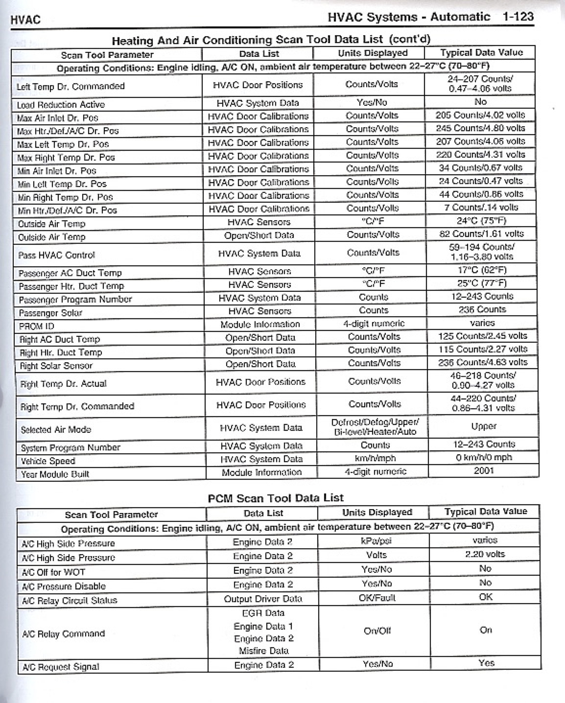

Do you have an advanced scan tool that can access the climate control and move all the mode doors from the scan tool?

No, I do not I only have a code reader. When contacting a local repair shop I asked if scanning the vehicle would help in diagnosing the problem and they said it would not.
Jul 28, 2020 at 6:14 AM
That is correct. Most scan tools will not pick up A/C codes. That is where you need an advanced scan tool to access the A/C system to check for the codes.
Just so you know, there is no programming new parts on the old systems. They are plug and plays. That was only required when we moved to OBD 2.

Hello Roy I posted a question in regards to an inoperative blend door actuator which you responded to I couldn't find your URL or I would have gotten back to you sooner.
The reason I contacted you originally was because after checking and rechecking my wiring and replacing the original blend door actuator it still was in operative.
After having tried two new actuators and trying a different HVAC module and the module under the glove box and still not making the repair I thought I would try the actuators from vehicles in a local salvage yard. I single handedly emptied every car there and had mixed results of faulty actuators to some that move somewhat. I had stopped in a local auto parts store and talked to one of the counter people and asked him is it possible I could have two new actuators that were bad, he smiled at me and said he went through three before installing a fourth which worked. Since the cold weather was coming and I needed to have it working I ordered a third actuator this time from Rock Auto,
STANDARD MOTOR PRODUCTS F04009 {#16164972, 89018375} TechSmart Info
Left; w/ Dual Zone Temp Control; Front
Part image $89.79
Which had a three-year warranty, voila it worked !!! Apparently there seems to be a quality control and also a dependability issue with these parts, what made this so frustrating is that my wiring checked out but the new units still did not work. Being you offered to help me I thought you would appreciate knowing as well as your readers in the event someone else ran into the same issue that you may offer them this insight and may prevent a lot of frustration and wasted time looking for a defect that doesn't exist.

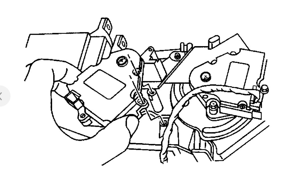

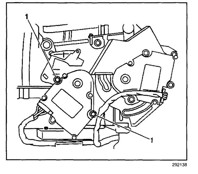

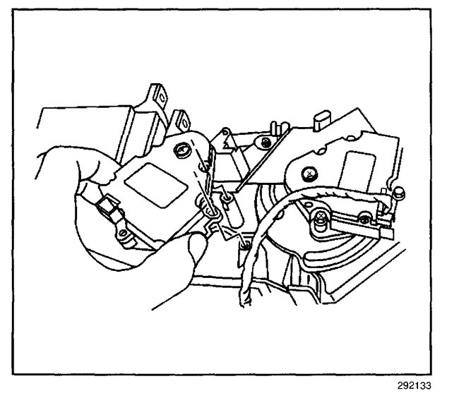

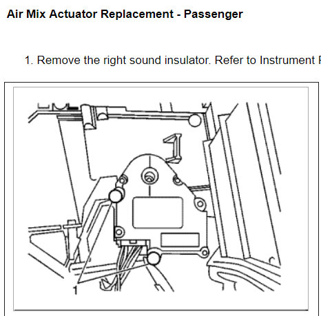

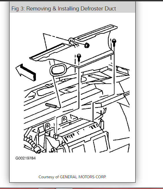

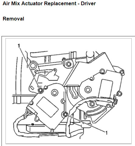

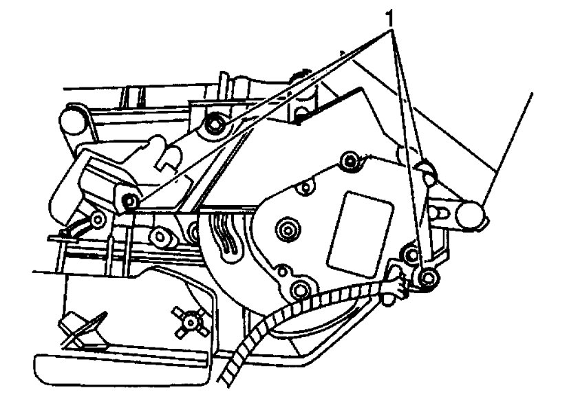

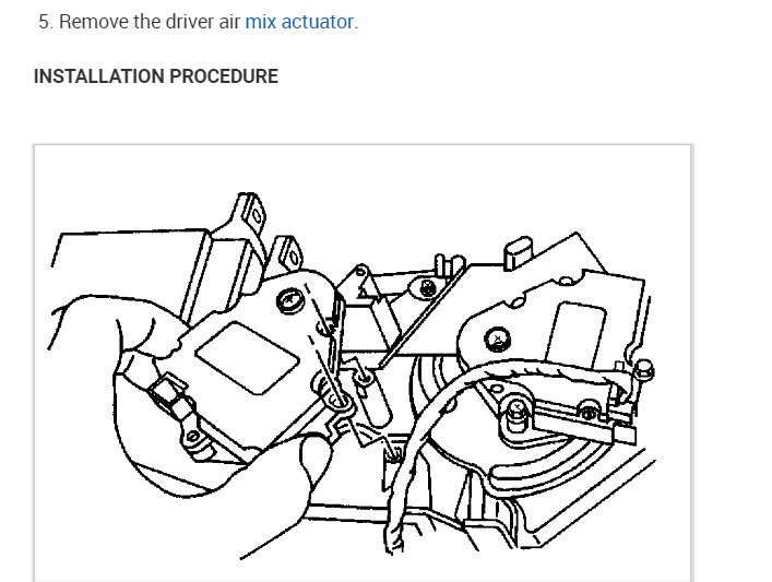

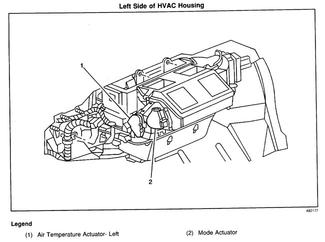

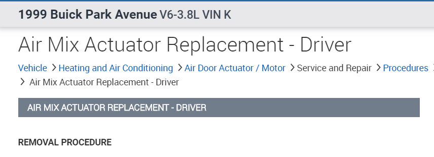

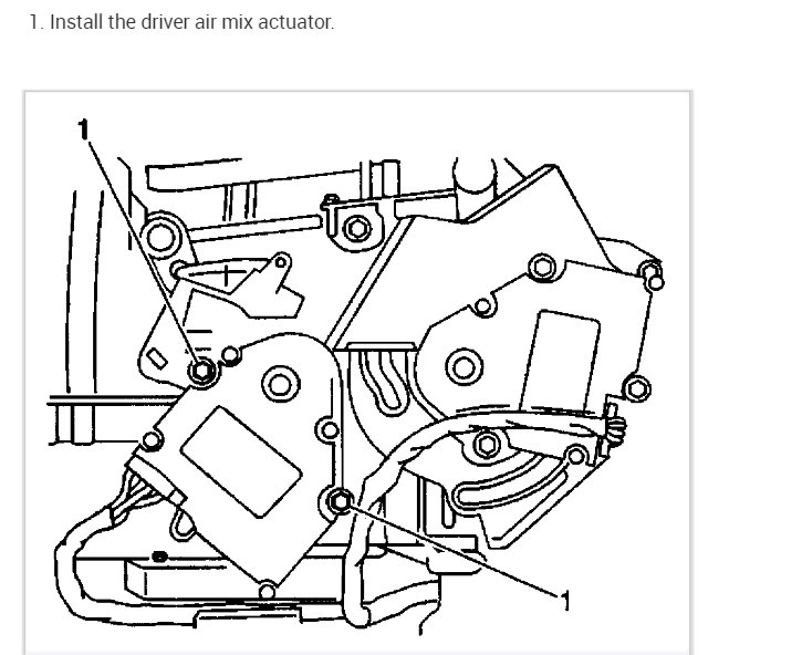

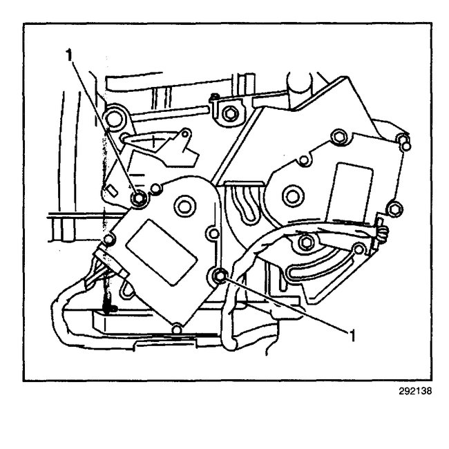

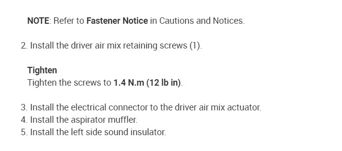

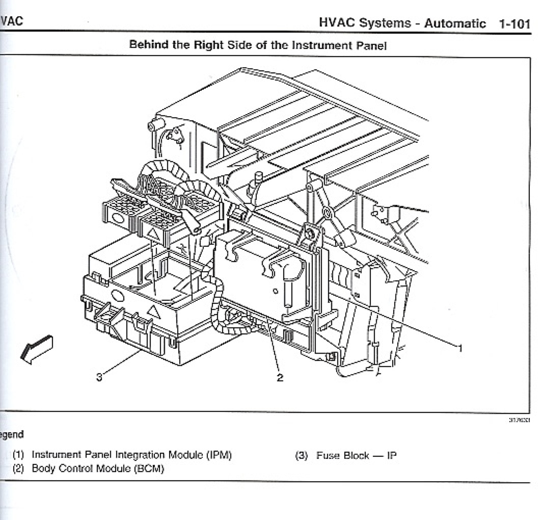

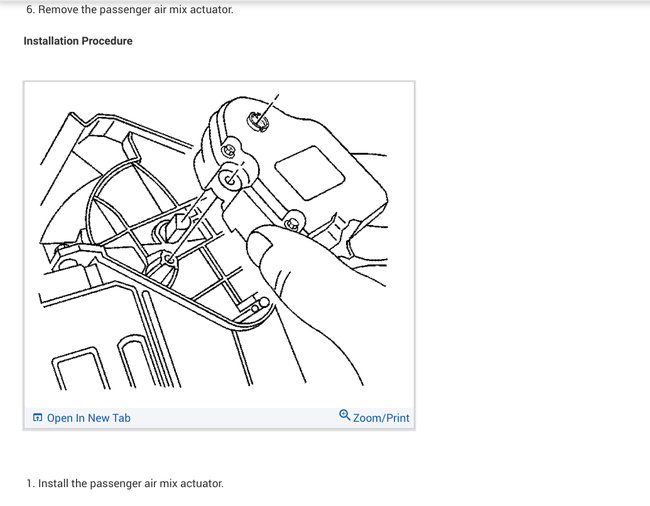

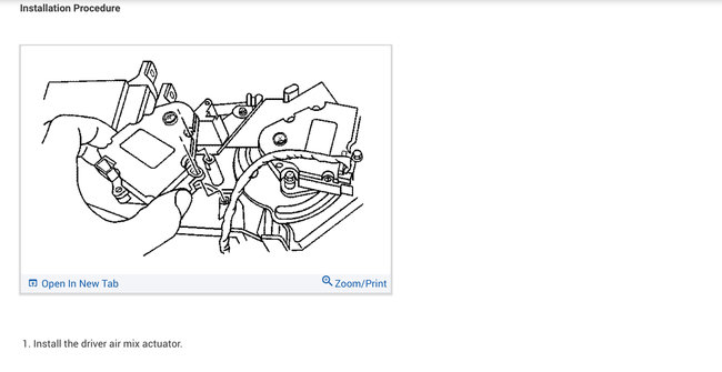

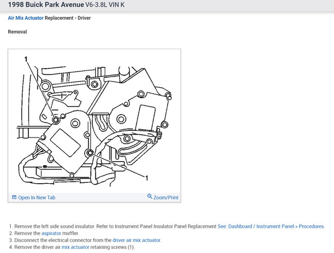

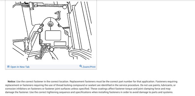

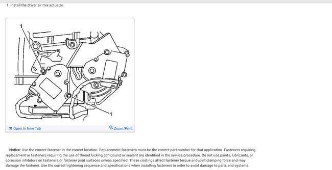

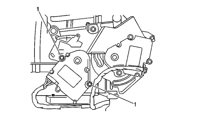

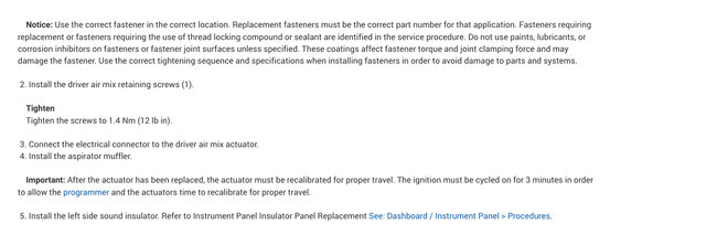

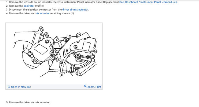

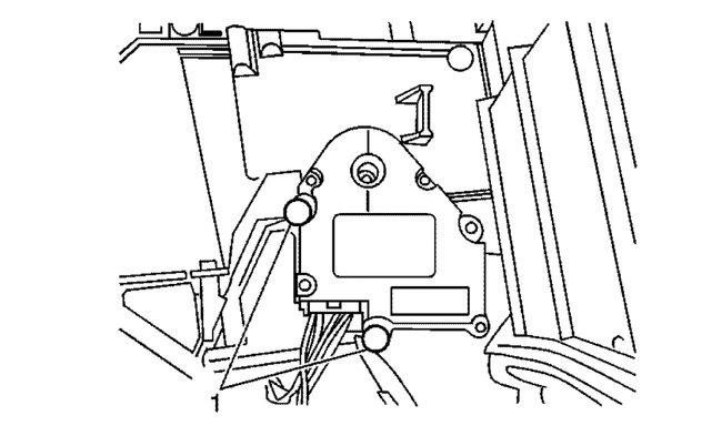

Here are the directions for replacing the left side actuator. All attached pictures correlate with these directions.
Picture 5 shows location.
______________________
Air Temperature Actuator Replacement - Left
Vehicle Heating and Air Conditioning Air Door Actuator / Motor Service and Repair Procedures HVAC System - Automatic Air Temperature Actuator Replacement - Left
AIR TEMPERATURE ACTUATOR REPLACEMENT - LEFT
REMOVAL PROCEDURE

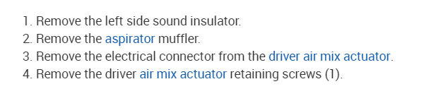

1. Remove the left side sound insulator. Refer to Closeout/Insulator Panel Replacement - Left in Instrument Panel, Gauges and Warning Indicators.
2. Remove the aspirator muffler.
3. Remove the electrical connector from the left air temperature actuator.
4. Remove the left air temperature actuator retaining screws (1).
5. Remove the left air temperature actuator.
INSTALLATION PROCEDURE
1. Install the left air temperature actuator.
NOTE: Refer to Fastener Notice in Service Precautions.
2. Install the left air temperature actuator retaining screws (1).
Tighten
Tighten the screws to 1.4 N.m (12 lb in).
3. Install the electrical connector to the left air temperature actuator.
4. Install the aspirator muffler.
5. Install the left side sound insulator. Refer to Closeout/Insulator Panel Replacement - Left in Instrument Panel, Gauges and Warning Indicators.
____________________________________________
Let me know if this is what you need.

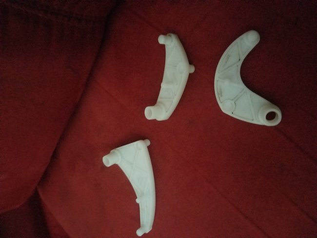

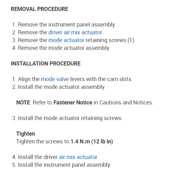

I have three plastic pieces that goes before you put the panel mode actuator on. don't know what order they go in.
Jan 22, 2021 at 4:51 AM (Merged)
SCGRANTURISMO
  • 4,897 POSTS

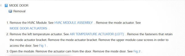

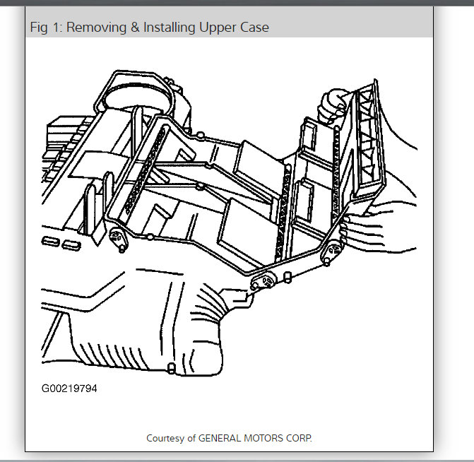

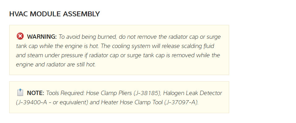

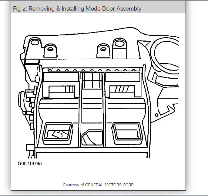

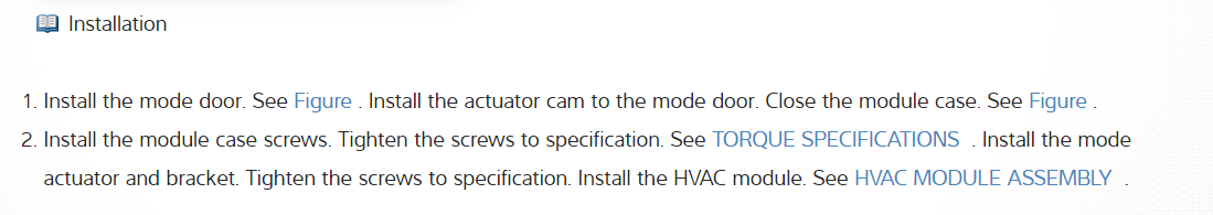

In the diagrams down below I have included the factory guide for the removal and installation of the mode actuator for you. Please go through this guide and get back to us with how everything turns out.
Thanks,
Alex
2CarPros

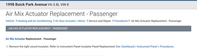

Heat blend actuator door, where is it on a 1998 buick park avenue ultra?

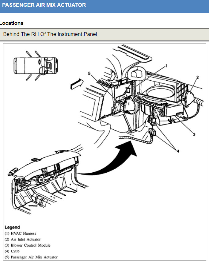

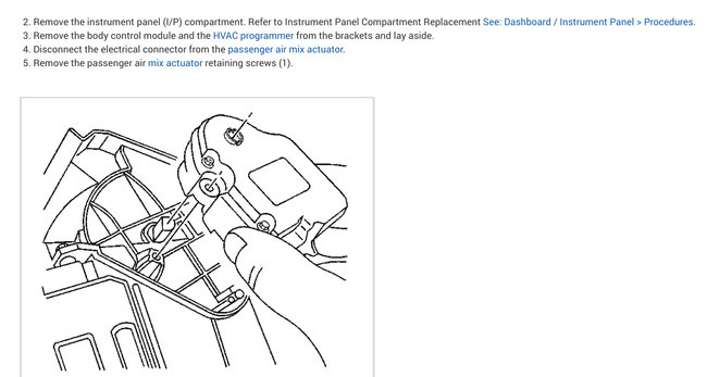

There are three that I'm aware of. Two left side under dash. One for driver side blend door and the other controls defrost/vent/floor position door. This one is very difficult maybe impossible to remove and check without removing entire dash. You can manipulate it by moving the linkages with your finger. It has a semi-circular lever that the actuator causes to pivot around to move the blend doors. I had to manually move mine to the defrost position for winter weather. I going to replace the programmer before I attempt to remove the entire dash. The programmer is inexpensive and can be googled online if you dont want to pay dealer.
Here is a guide to help you see what you are in for when doing the job.
Cheers
GINO500
  • 9 POSTS
How would I get to the linkages because i think some debris is causing it to get stuck open or something. It blows hot air on the drivers side but cold air on the passenger side. Could I manipulate it to stay "open"?
EDEHART
Probably not debris. Could be the heater programmer or control module in dash. Control module has four resistors that overheat in circuit board and cause solder joints to loosen and malfunction.
To answer your question there is an actuator on the passenger side as well. There are three small 11/32 bolts fastening the actuator. You can remove the actuator (See picture) and move the blend door rod (end of white rod under actuator counterclockwise with your fingers. Down fully counterclockwise is heat mode.

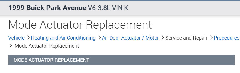

It sounds like you have a mode blend door actuator that is not working right. here is guide to help show you the repair with diagrams below to help you with your car. Check out the diagrams (Below). Please let us know what you find.
Jan 22, 2021 at 4:52 AM (Merged)
FOOLZRUSHN
The Park Avenues (PA) of this series (1997 through 2005) have electrically controlled air doors. This is a symptom of the "mode actuator" not working. It is common for a plastic gear inside the HVAC system actuators to crack and then fail to move the doors that control the flow of air. It is also possible for the electrical connection (connector etc.) to be intermittent, or the electronic control module to fail, but not as common.

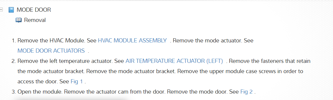

Unfortunately the "mode" actuator is the most difficult to access of the four actuators on this series of PA. It is the aft-most one of two actuators on the driver's side of the HVAC unit (under dash). It is mounted to the forward side of the aluminum dash substructure under the plastic surface pieces. The service manual recommends removal of the complete dash and steering wheel to access this actuator.
I believe it is possible but difficult to remove and replace this actuator without removing the dash completely or the steering wheel. I am in the process of trying to do that.

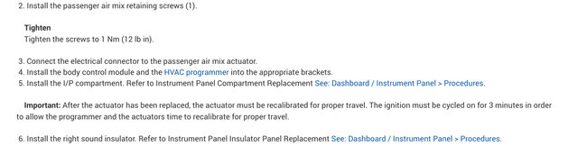

Good evening,
To calibrate the motor, remove the fuse for the AC system for one minute.
Then turn the key to on and wait three minutes. The module will set the motor to the correct position.

Roy, there are a few fuses in the under dash fuse box. could you please direct me as to which one to pull? this one looks to be the logical one:
CSTR/SBM HVAC Programmer, Instrument Panel Cluster, SBM (275 to LCM) (1135 to BTSI SL)
Jan 22, 2021 at 4:53 AM (Merged)
GARYVANTHUL

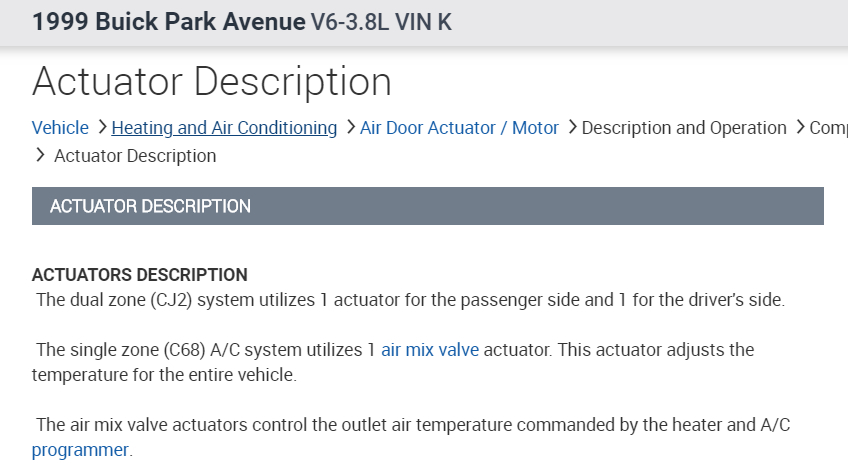

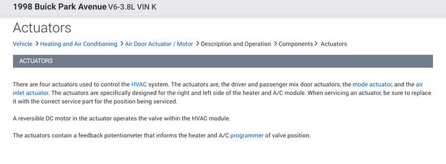

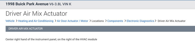

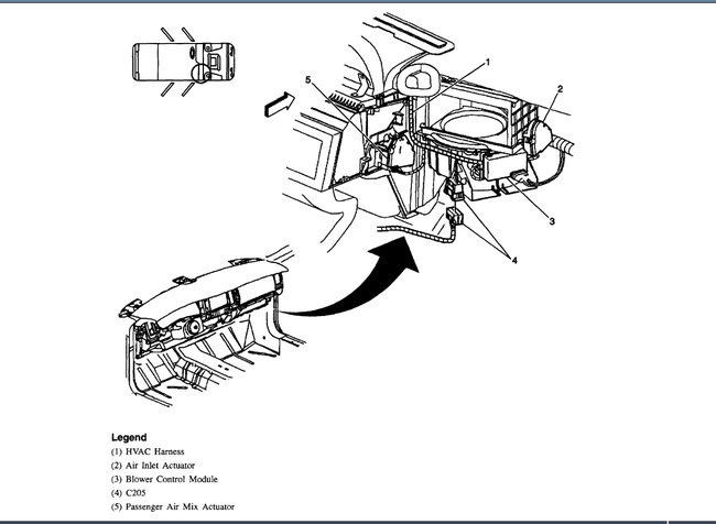

Where specifically is the actuator which controls the flow of the heater and A/C located? I have watched the 2CarPros video several times and find that it is not showing this particular vehicle. Is it indeed located behind the glove compartment?
HVAC programmer is the one.
SCGRANTURISMO
  • 4,897 POSTS

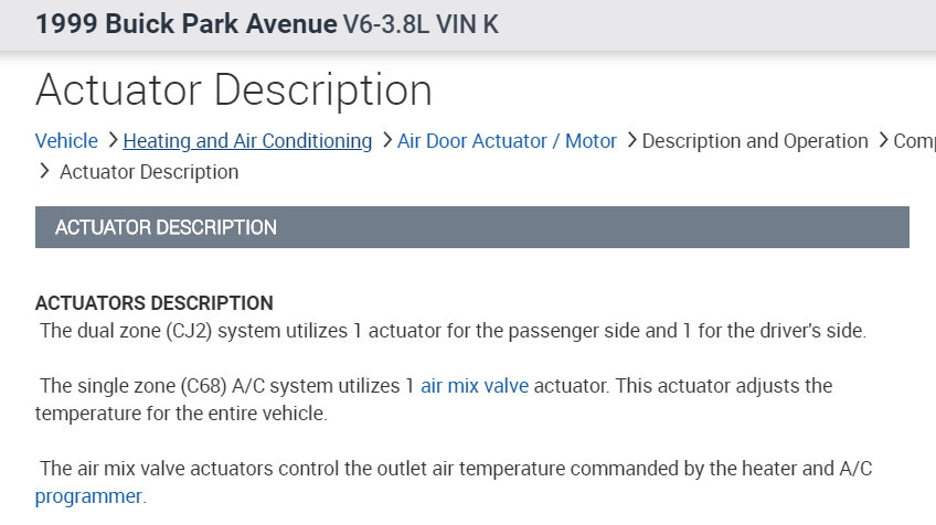

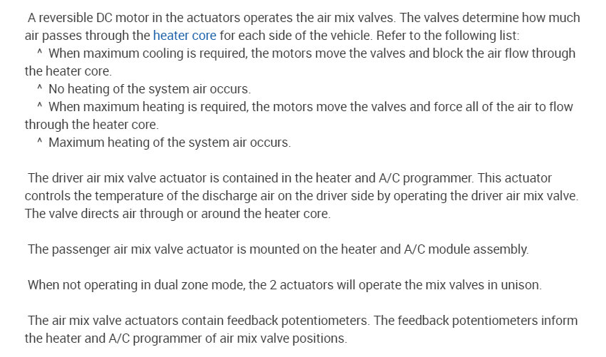

In the diagrams down below I have included the description of the HVAC actuators, their locations, and the instructions for the removal and installation of both the passenger and driver side air mix actuators for your vehicle. Please go through these guides and get back to us with how everything turns out. I hope that this helps.
Thanks,
Alex
2CarPros

i ended up disconnecting the battery to get it to reset. then did the three minute with the key on the on position. i could hear the actuators resetting themselves. so that worked perfectly. unfortunately the blend door actuator is clicking so i'm assuming there is something stuck inside and I'll have to pull it apart to get at the door to see whats blocking or stuck. thanks, Don
if anyone just needs to reset Roy's directions worked perfectly. the only difference is i disconnected the battery.
just know when you disconnect the battery the gas and temperature gauges fall behind the peg and you'll have to take a strong magnet to drag them back around.
