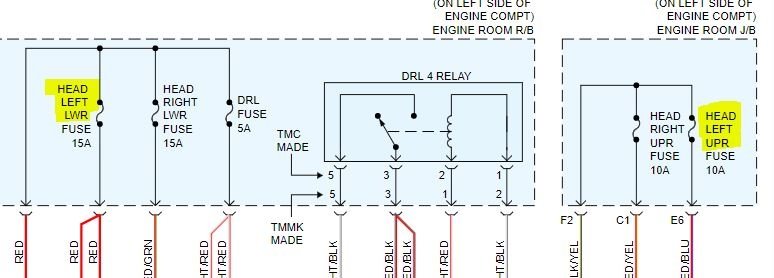

Hi there,
The left side headlight went out a few months ago, figured it was the bulb, and no problem. Got home, and found the bulb and fuse are both okay. Other headlight works fine, so don’t think it’s the relay (unless they’re both on separate ones?) A new socket was installed by previous owner, which had melted, so I pulled that and the butt crimps and replaced both, still to no avail. I’m getting 12v across the wires. Any ideas on how to diagnose where the issue is? Thanks in advance.

If you are getting 12v to the light socket, the bulb is good, and there are no connection issues with the plug, then it has to be a ground related problem. Since you have power, a fuse is unlikely, but each beam and side has its own fuse. See picture 1.

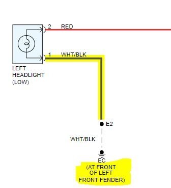

Next, I need you to check for a good ground to the left light. See pic 2 for location.

Thanks for the quick response, Joe! I’m measuring 12v between the hot and ground wires, not the hot wire and the chassis, so is it still likely to be a bad ground, given that the expected potential difference exists across the wires? If the ground was open, wouldn’t that voltage difference be zero?
In terms of checking the ground, what do you recommend? Thanks again!

I’m pretty close to certain that the socket is good, I just replaced it. The bulb matches the designator on the socket and supply voltage, and worked for about a month after I replaced it (old one burnt out) before it suddenly stopped. When I swapped the bulbs out, I noticed the socket was pretty well melted, although it still worked. Either it was really cheap, or things were getting unnecessarily hot in there. As such, I don’t think it’s the socket or the bulb, but something in the wiring (or connections). Is the headlight ground the one in the engine compartment? There’s also a thick bundle of ground wires that goes deep behind the fender, and I can’t see which is which, since everything’s well wrapped in electrical tape. maybe it’s time I bit the bullet and just unwrapped it all. Is there a non visual ground test you know of?

Ben, the easiest thing to do to determine if it is a ground issue is make a new ground. Simply take a wire and attach one side to the light socket ground and the other to the battery ground.
As far as the heat issue with the old socket, that isn't uncommon. I will tell you also that if a connection isn't good and any arcing is happening, that creates a lot of heat.
Try making a temporary ground to see if that resolves the issue.
