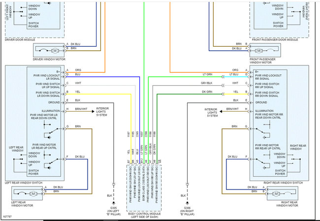

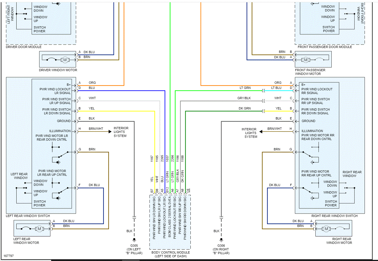

I installed a new actuator/motor, and the right side works great, and the left has no power. I tried the drivers control panel and the left rear window button and no power.

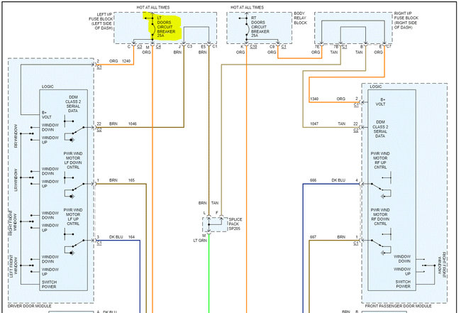

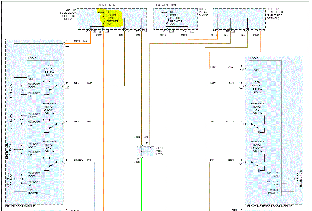

Does the driver's window work? I ask because both left windows get power from the same source, a 25-amp circuit breaker in the fuse box on the left side of the instrument panel.

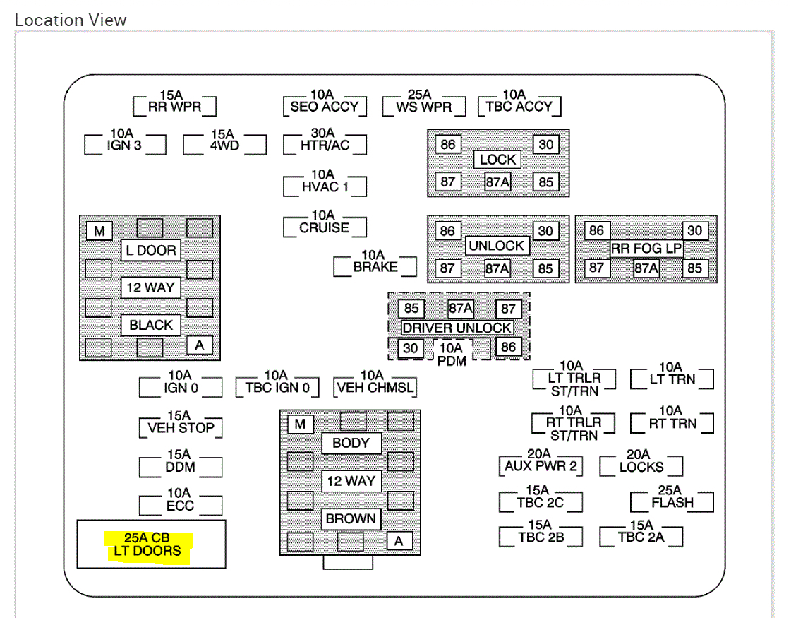

If you look below, the circuit breaker powers the left windows. Also, the last pic shows the location of the circuit breaker. Please keep in mind, this is not a traditional fuse. It works like a circuit breaker in a home. However, it is designed to turn the power back on automatically after a given amount of time.
Let me know if this helps.
