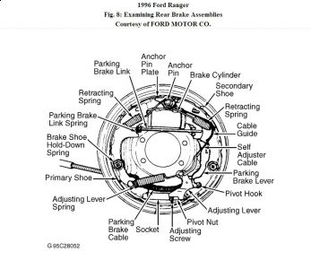

When turning left ,slowly from a parking spot or slow sharp turn from stop sign , it feels like left wheel is stuck and wheel is skidding.
Apr 16, 2020 at 8:21 PM
Good morning,
My first thought is that you may have a frozen emergency brake cable that is partially applying the brakes on the wheel when you turn. It stretches the cable and applies the brakes to the drum.
Have the rear brake cables checked to be sure they are free and working properly.

Thank you . You were correct . I pulled the drum and sure enough every thing was gummed up with heavy brake dust and emergency cable was stuck . I also pulled and cleaned right side to get ahead of similar situation .

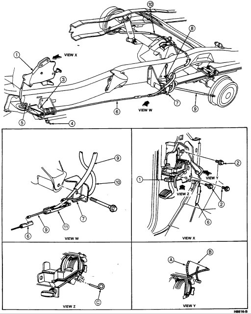

The connection between the front cable and the back cable pulled apart when pushed the e brake harder then normal while at boat ramp the other day. I since have reconnected the two but I am about three inches shy of being able to connect the front cable at the first connection. While investigating the situation I had my wife push and release the parking brake and the front cable has zero movement while doing this. I am in need of a solution. It has to be something I am not familiar with. The musky are done spawning and I got to get out there but I cannot with out the brake. I do not want to lose her at the ramp, again.
Apr 14, 2021 at 3:39 AM (Merged)
  • 110,244 POSTS
Hi and thanks for using 2CarPros.com. I totally understand the need for the parking brake when docking a boat. (lol) I nearly lost my truck, too.

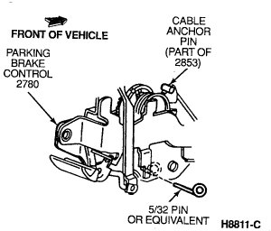

Okay, if the front cable is attached in the cab of the vehicle, but is not moving under the vehicle, something broke. Most likely, it is the cable. What I have done is attach the directions for removal and replacement of the entire cable assembly as well as pictures to follow. Start at the park lever in the cab and following the schematics I have supplied, locate where the break is located. Since the front cable is not moving, chances are the cable anchor pin from the pivot hole in the control assembly ratchet pin has broken or come apart.
Removal:
Relieve tension on the system by having an assistant pull on the parking brake intermediate cable (2A620) or front parking brake cable and conduit while you insert a 5/32-inch drill bit into the hole provided in the parking brake control.
Disconnect the parking brake intermediate cable or front parking brake control cable from the parking brake rear cable and conduit.
To replace the parking brake intermediate cable, disconnect it from the front parking brake cable and conduit and remove it.
To replace the front parking brake cable and conduit, remove the cable anchor pin from the pivot hole in the control assembly ratchet pin.
Guide the front parking brake cable and conduit from the parking brake control and disconnect it from the frame mounting bracket. Remove cable-to-frame attaching screw, if screw is present, and slide cable from vehicle.

As far as releasing pressure from the cables, here are a few ways to do it.
Place the parking brake control (2780) in the "released" position.
Parking Brake Control
While an assistant relieves tension on the system by pulling on the parking brake intermediate cable, insert a 4mm (5/32-inch) , steel pin or equivalent drill bit into the hole provided in the parking brake control.
NOTE: Be careful not to damage the plastic coating on the cable strand. Remove the parking brake rear cable and conduits (2A635) from the parking brake cable bracket (2530).

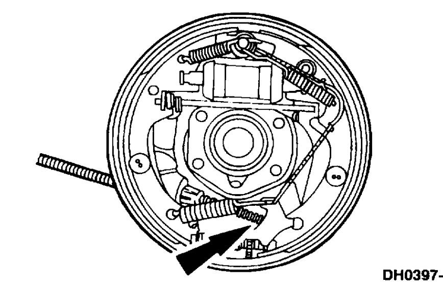

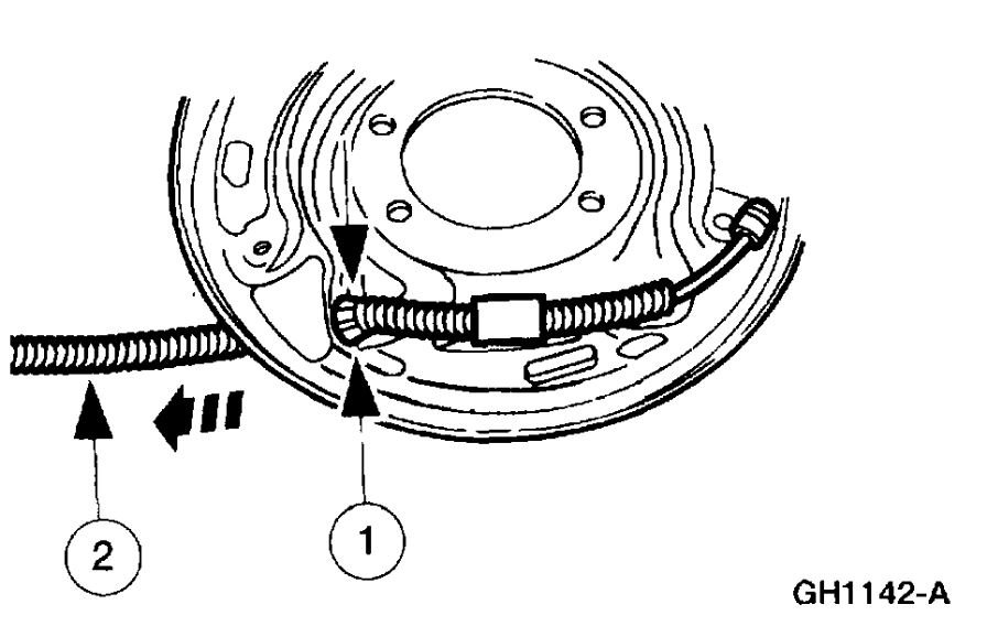

I empathyze with you.....there isn't. On a weekly basis I find myself looking a particular system that has been engineered so oddly that I say to myself.."But there has to be"... I have a 98 ranger. This is what you need to do. Pull the drums back off and apply the e-brake. Does it move the shoes out? Recheck for anything mis-installed.
https://images.2carpros.com/forum/automotive_pictures/30961_brake_shoe_diagram_1.jpg
If either side or both sides are not moving with the parking brake pedal, then look more closely at the cable on the inside of the drum. Does the cable move as it should or does it not return. I'm thinking the cable (s) may either sticky or frozen and not moving the shoes. Since you have the star wheel adjusted to the drums properly, then I doubt the shoes are moving.

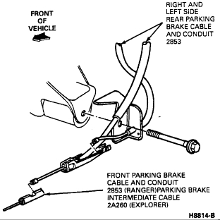

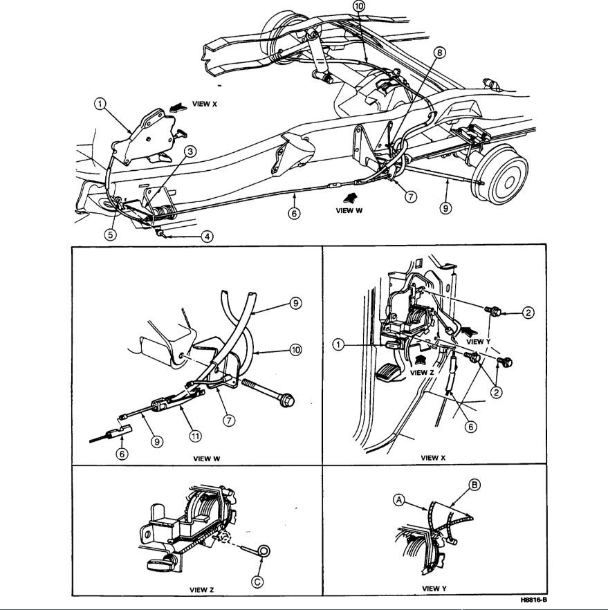

are there any emergency brake cable adjustment other than the one on the shoes inside the drum?
I put new shoes on and the emergency cable is freed up but they is still tension on the cable, I nee some more slack in the cable but did not see any adjustments no where along the cable under the truck. Both wheels are turning very hard.
MIKE H R
  • 3,094 POSTS
See the diagram below (View W). there should be an adjustment for cable length/tension where the two join together
