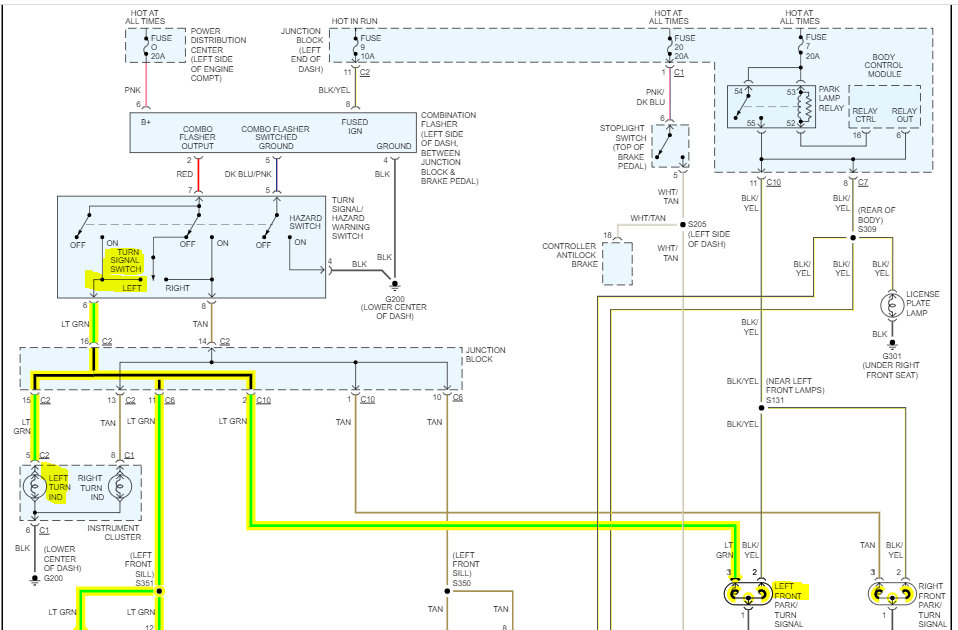

left rear turn signal has no power?
74,000 MILES • 2.7L • 6 CYL • 2WD • AUTOMATIC
DELVEE SOLES
The bulb is good.
Aug 17, 2022 at 5:21 AM
  • 110,248 POSTS
When you turn the left signal on, does the flasher hyper flash? Is the front left working as well as the indicator in the vehicle?

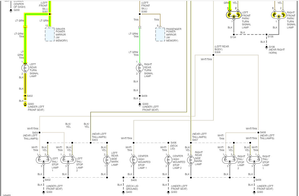

You mentioned there is no power to the left rear. Did you check the light green wire with a tan tracer while the signal was on? If not, use a test light or multimeter to confirm there is power.
If you find there is power, but it still doesn't work, there will also be a black wire at the connector. See if that wire has continuity to ground.
I attached the wiring schematic below and highlighted everything related to the left signal. Note that the front left signal, as well as the indicator in the vehicle, is tied into the same wire. That is why I need to know if anything other is working. If they are, either we lost ground, there is a faulty light socket, or the power supply is broken.
Let me know what you find.
Aug 17, 2022 at 1:56 PM
DELVEE SOLES
Thanks for your help, the bulb was not making good contact. Will replace the socket. Thanks
