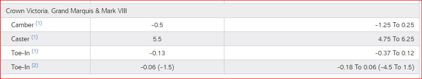

I did not remove the upper control arm but I did remove the upper ball joint and replaced it, could that have anything to do with the ride height? Because they are adjustable for caster and camber but the car has not been realigned. Also, the driver side upper and lower ball joints need to be done as well. should I wait to have the car aligned until that side is done? Thanks!
Dec 18, 2018 at 10:08 PM
DANNY L
  • 5,648 POSTS
Hello again,
Yes! Make sure you do the driver side as well and when finished then do the alignment! Do all the work then you can be be sure everything will be even. I've attached the alignment specifications for your car when ready.The left hand specifications are preferred and the right hand is within range. Hope this helps and thanks again for using 2CarPros.
