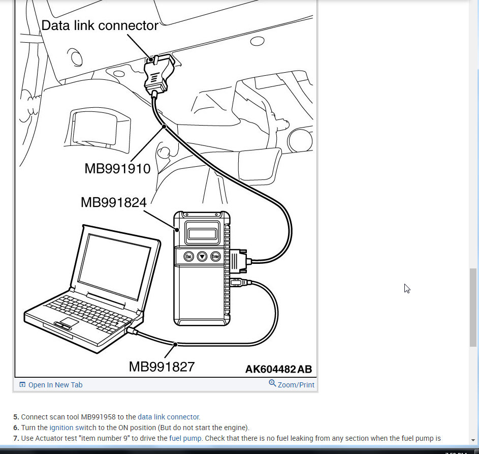

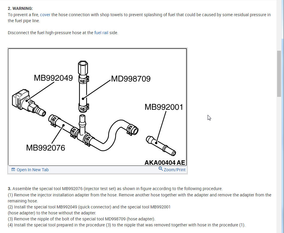

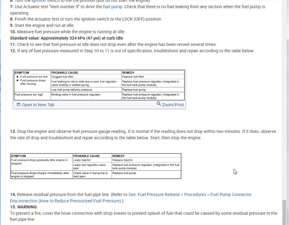

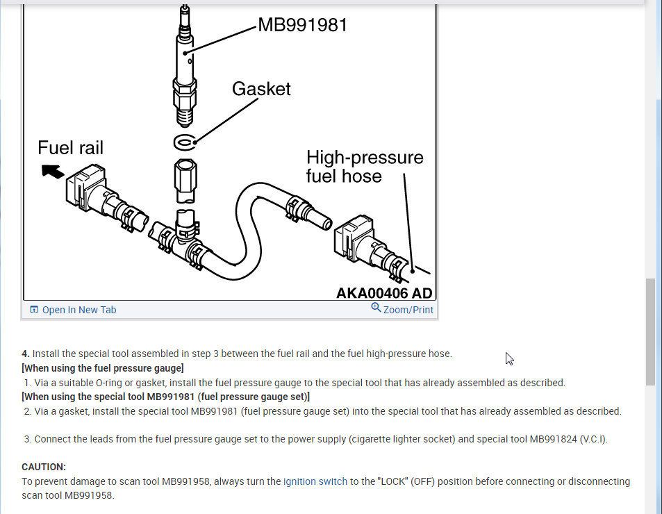

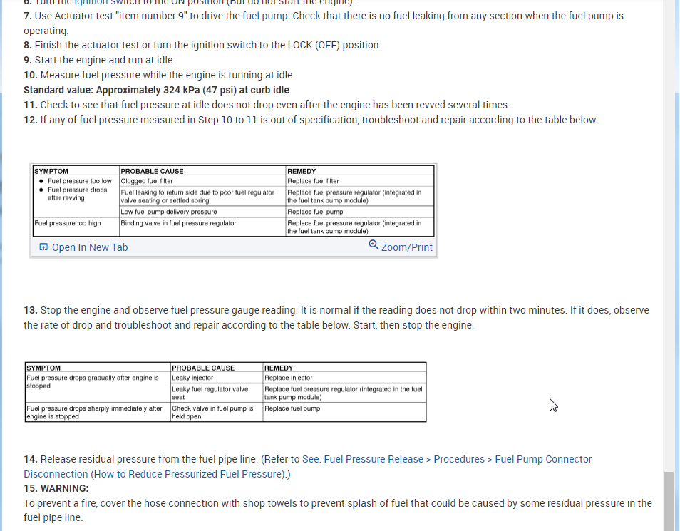

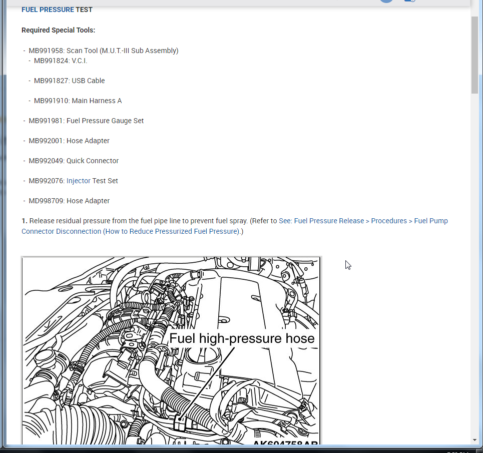

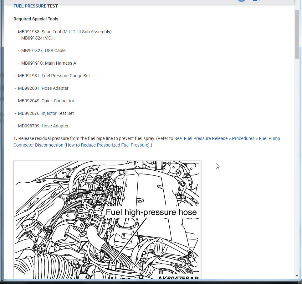

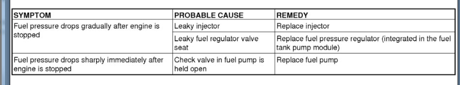

Sounds like you are sniffing all around the issue. If you are able to add fuel and it runs then you do have a fuel issue.
I am concerned with the fact that you only have power at the pump when in the start position so we should start there.

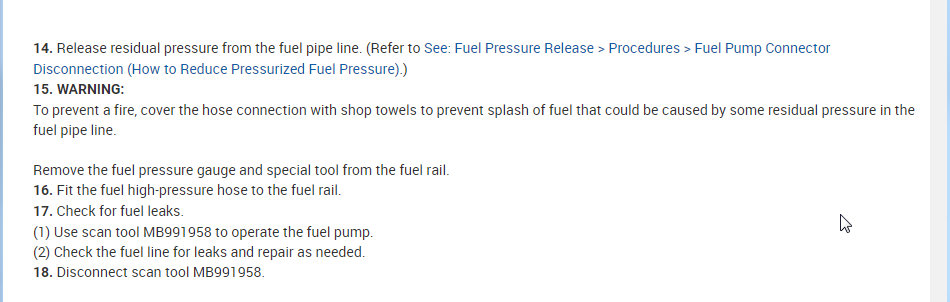

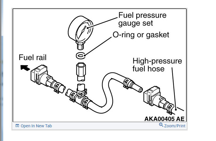

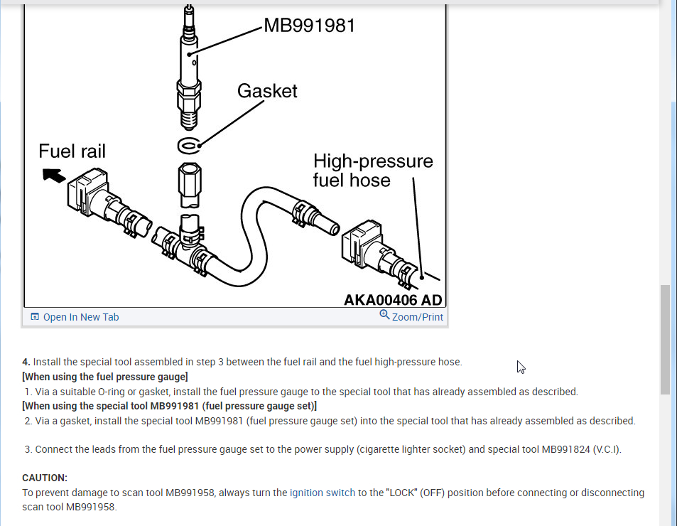

However, here is the way to test the fuel pressure which is where we always have to start on fuel issues. If you don't have pressure even when the pump runs, then there is no sense in figuring the rest out. So let's check the pressure when you turn the key on and then we can determine next steps.
