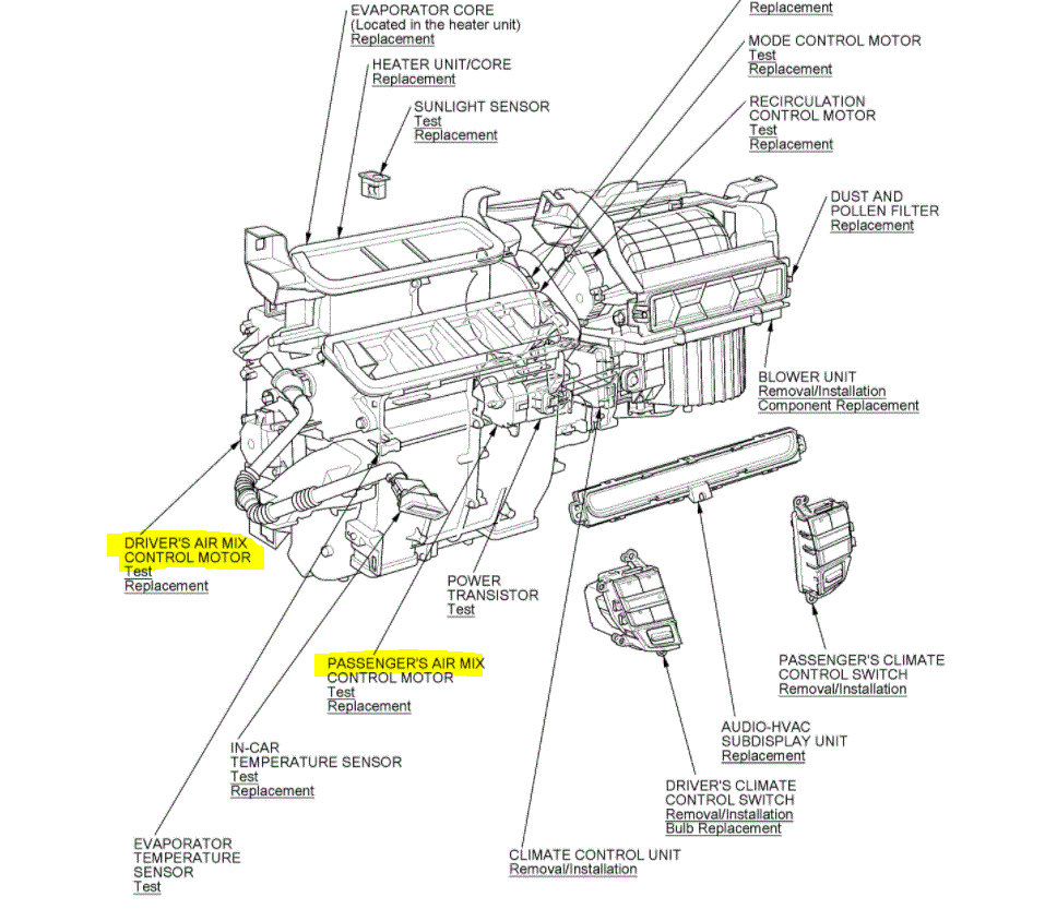

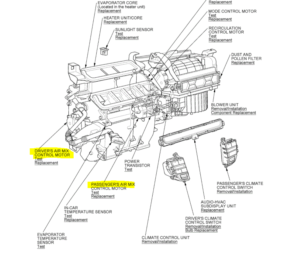

The idea that both heater core hoses are hot leads me to think it could be related to the air mix door actuators. Are both sides (passenger and driver) sides of the vehicle equal in temperature?
See pic below. If the heater core hoses are hot, then we know the coolant is flowing, so the heater core should be hot. Therefore, heat is there but not making it into the cab. The air mix door actuators are what control the temperature entering the cab. Have you checked to make sure they are fully operating?
Let me know. See pic below.

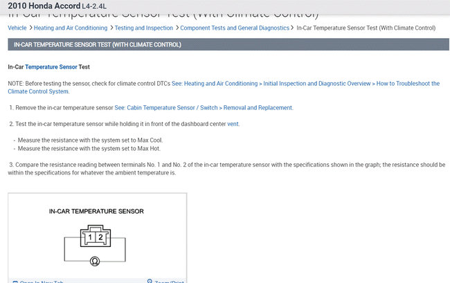

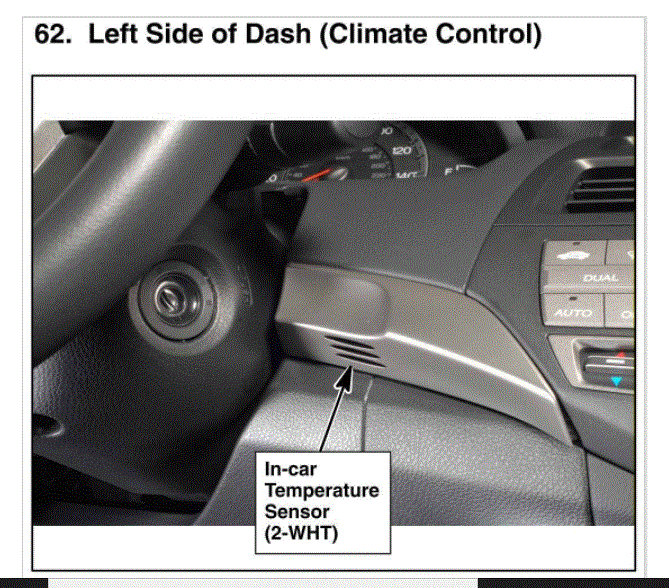

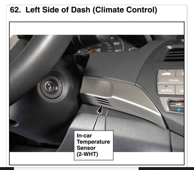

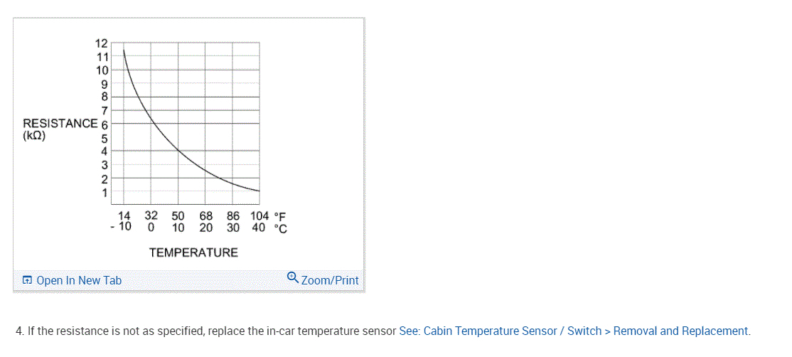

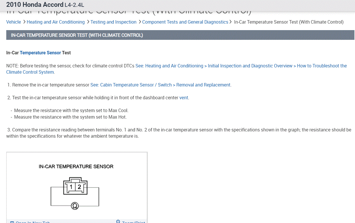

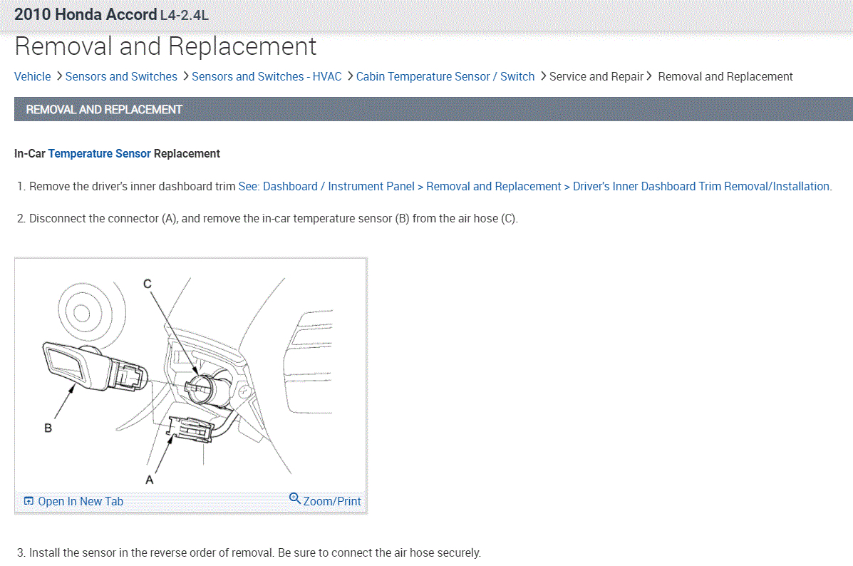

The temperature sensor in the vehicle is for automatic climate control. It is located at approximately the center of the dash. See pic 1.
Pics 2 and 3 explain how it's tested.
The last pic is for the removal and replacement of the sensor.

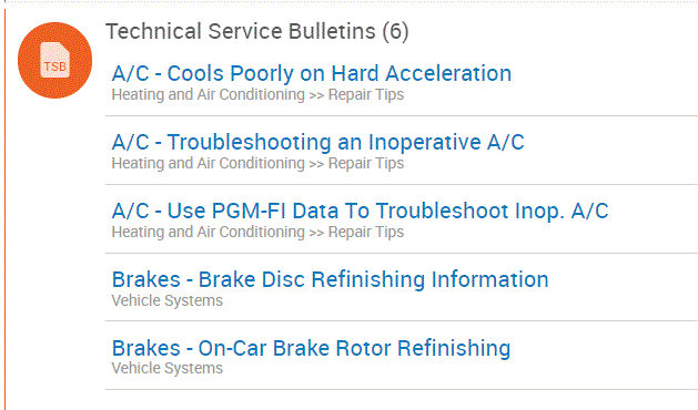

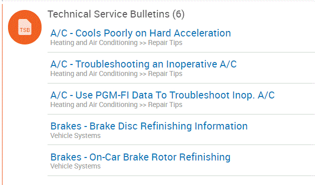

I checked for HVAC technical service bulletins. Everything is AC-related. See pic below.
Let me know if both hoses are hot when you have little heat.
See pic below.
