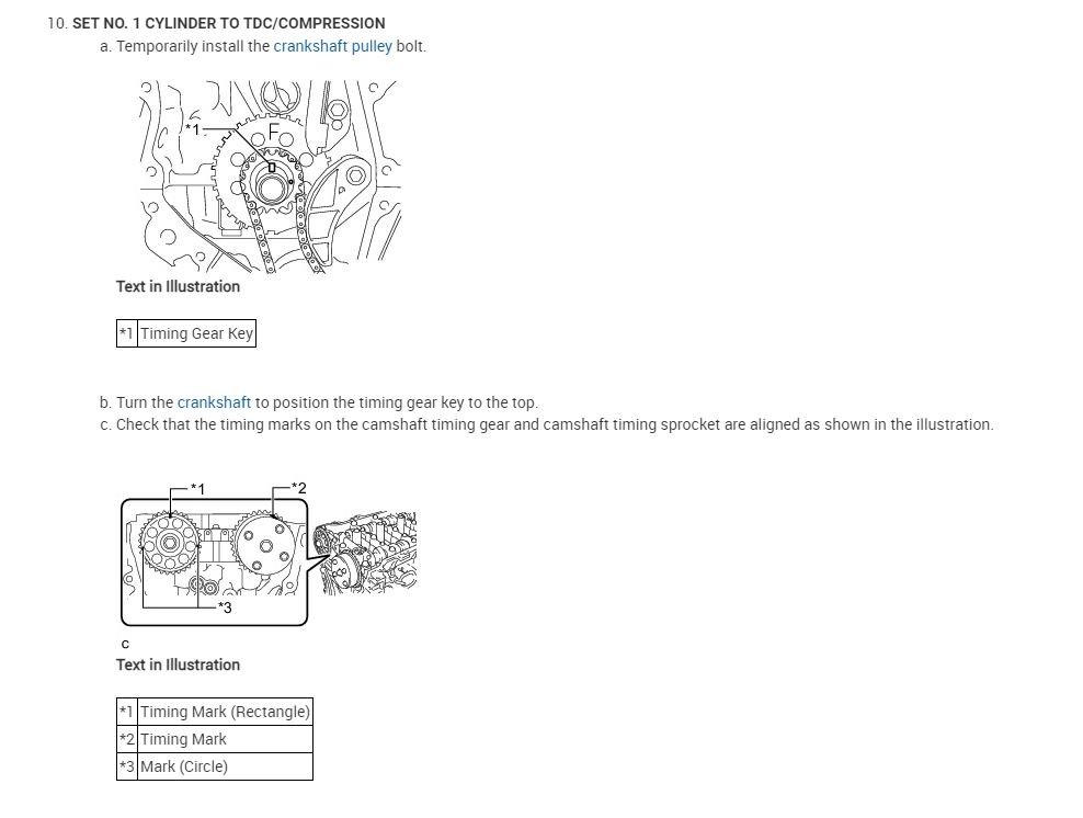

  • 52,797 POSTS
I attached the mark location for you to view.
I would check your marks to be sure and not assume they are correct.

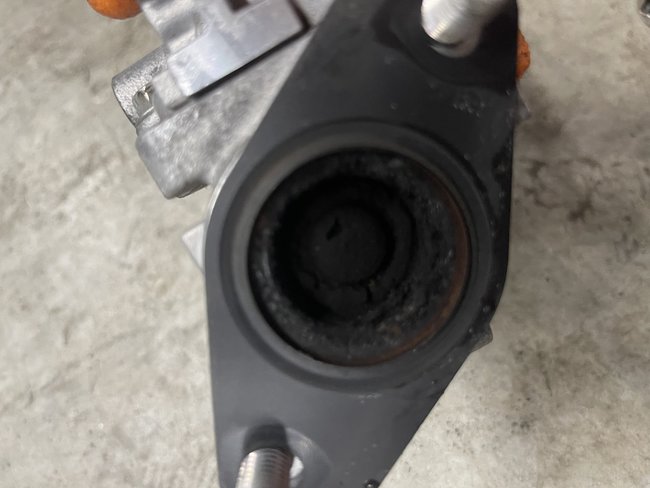

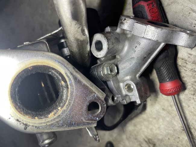

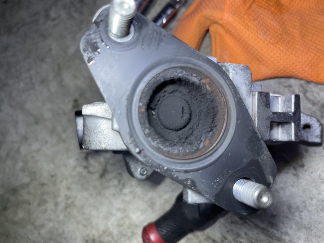

DIVIDES
  • 898 POSTS
We checked the timing and it's perfect. We just removed the cooler and erg. Here are pictures of inside the erg and inside cooler, both have lots of build up.
Wednesday, April 6th, 2022 AT 10:39 AM
  • 52,797 POSTS
Wow, that is loaded with carbon. I would replace that valve and start with new.
