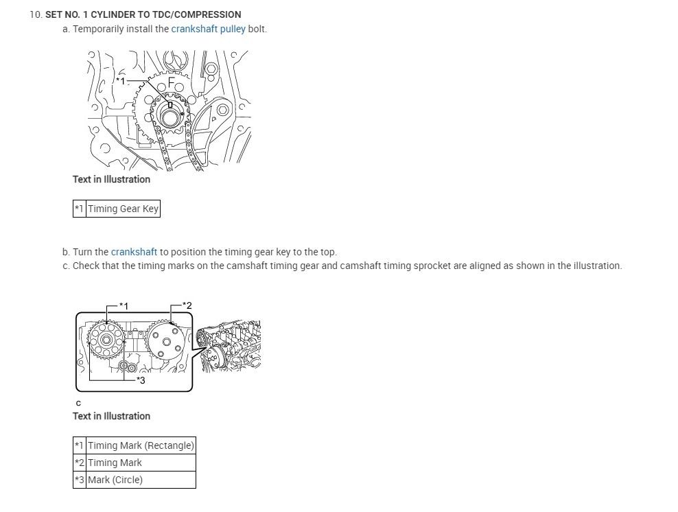

This sounds like carbon in the cylinders causing this issue. There may be some restrictions on the operation of the valve. Otherwise, the timing may be too far advanced causing detonation.
Apr 5, 2022 at 12:53 PM
DIVIDES
  • 903 POSTS
Valves are super clean. I checked the bores and also found no issues. Timing usually has some indications such as continuous rough idle not just morning or random misfires.
Apr 5, 2022 at 1:13 PM
I attached the mark location for you to view.
I would check your marks to be sure and not assume they are correct.

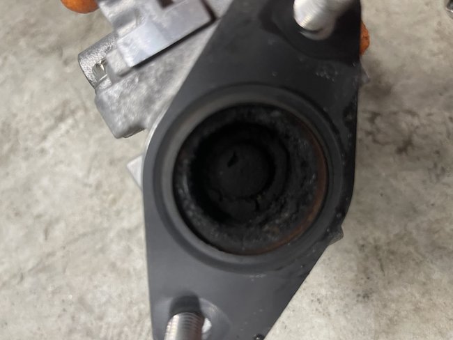

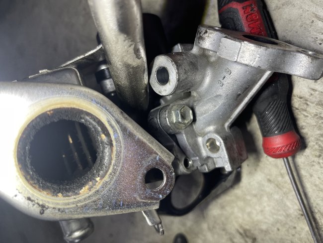

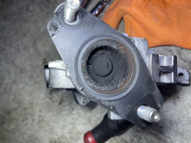

We checked the timing and it's perfect. We just removed the cooler and erg. Here are pictures of inside the erg and inside cooler, both have lots of build up.
Apr 6, 2022 at 3:39 AM
Wow, that is loaded with carbon. I would replace that valve and start with new.

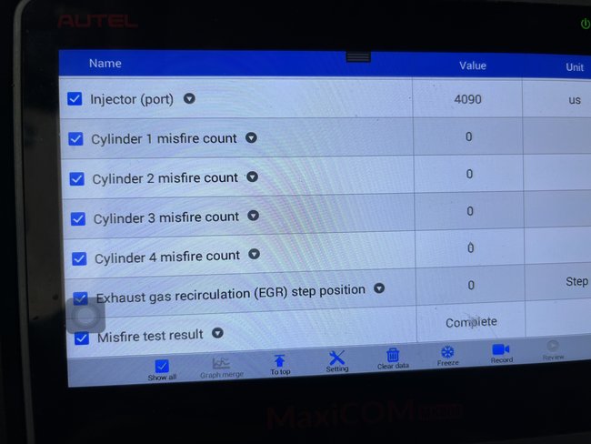

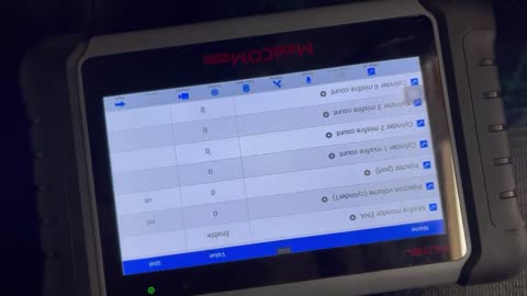

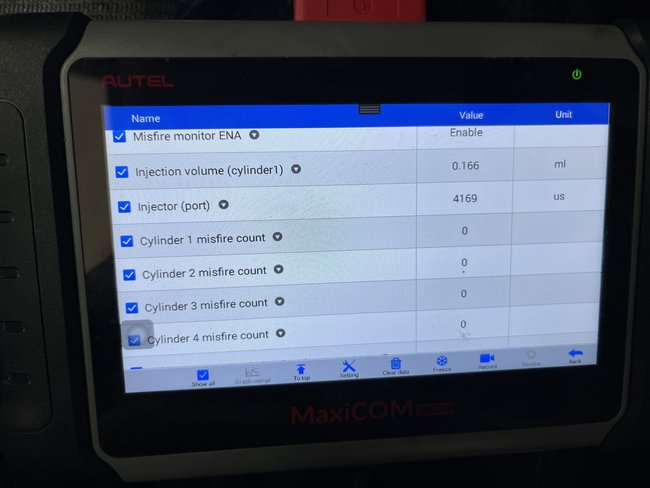

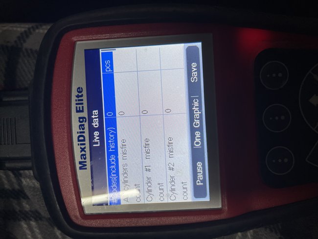

Car is 90% better after cooler, erg and intake were replaced. Still get misfire 1 every once in a while. I looked in the pore and i see it wet, gas, not water. Is this possibly a leaky injector?
Apr 16, 2022 at 9:12 AM
JIS001
  • 3,412 POSTS
If it is fuel, you should be able to smell it. But a leaky injector can cause your start up misfire also.
Apr 16, 2022 at 10:00 AM
DIVIDES
  • 903 POSTS
All solved. Fuel injector cleaner in the tank and its 100% normal.
Apr 26, 2022 at 11:23 AM
