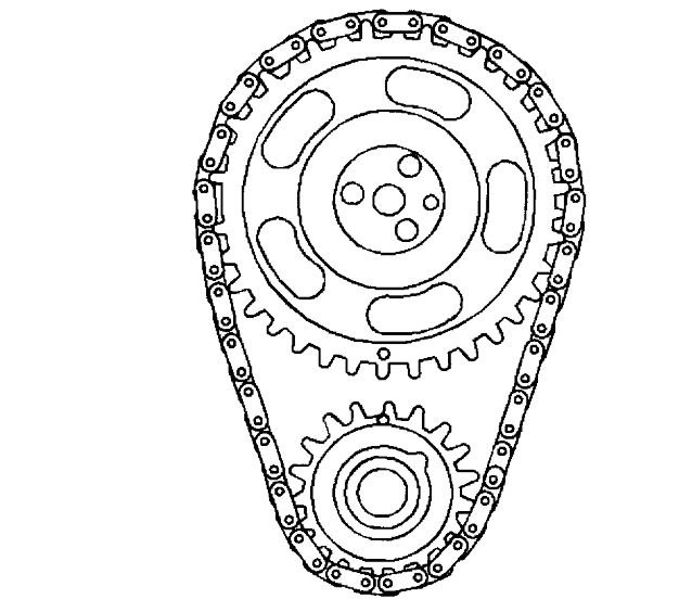

I would like to know if my knock sensor can alter my timing? Everything else is either new or adjusted where it is supposed to be, but my timing marks are off!
Nov 5, 2018 at 3:55 AM
Good afternoon,
Which timing marks? The one with the chain or the distributor?
No, the knock sensor will not effect the timing at all. The PCM will change the timing internally when it detects pinging. If you have a scan tool, you can monitor the knock sensor pids.

Well the only reason that I suspect the knock sensor is because nothing else makes any sense as to why the timing marks will not line up. It's on the #1 TDC and the rotor is pointing to the right mark on the distributor. Compression is good, fuel pressure is good and I have spark on all plugs. What else could it be?
Nov 5, 2018 at 7:55 AM
Okay,
What is the exact fuel pressure?
A clogged catalytic converter will cause this as well.

I do no know what the fuel pressure is because I had put it into a shop and told them to see if they could figure it out. At $115.00 an hour, I could only afford a couple of hours and they gave me another half an hour for free and said that I have spark, fuel, and compression. And said that it is sounding like something mechanical. They said to check the valves which I pulled the valve cover and seen that everything seem to be working like it should. They also said that it could be the cam lobe on the #6 being wore out because that is the cylinder where the misfire is. I get two codes from the scanner, P0300 and a P0306. How does the catalytic converter mess up my timing? And there is a rattle in the cat area which I knew of but I did not think that would cause the timing to mess up.
Nov 5, 2018 at 8:42 AM
300 is common for low fuel pressure.
timing is controlled by the chain and the distributor. did they check that?? did they check to see if it jumped time??
the rattle in the cat could be it is broken inside and clogging up the exhaust. if it is blocking off the exhaust, it will not let the engine breather and it will not start.

I put the chain and gears on and made sure the dots were lined up.
Nov 5, 2018 at 11:16 AM
When you removed the valve covers, were all the valves moving the same distance?
I would also back up and recheck the fuel pressure as well. Low fuel pressure will do this as well.
