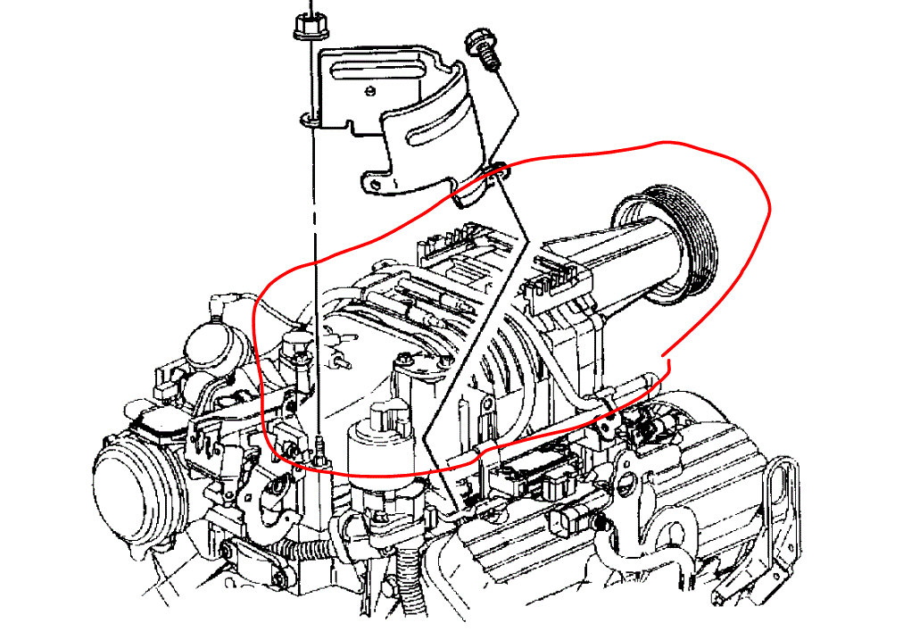

JDOT6
  • 11 POSTS
My supercharger boost gauge is also stuck in the middle now as well, not sure what they did to cause that or if that could have caused a knock ?
Mar 1, 2021 at 7:53 PM
  • 110,194 POSTS
The supercharger had to be removed. See if you can tell if that is where the sound is coming from. I attached a pic of it below.
Let me know,
Mar 1, 2021 at 8:31 PM

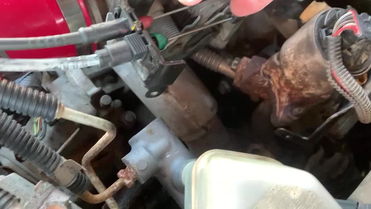

JDOT6
  • 11 POSTS
Here’s another video:
Mar 3, 2021 at 8:06 PM

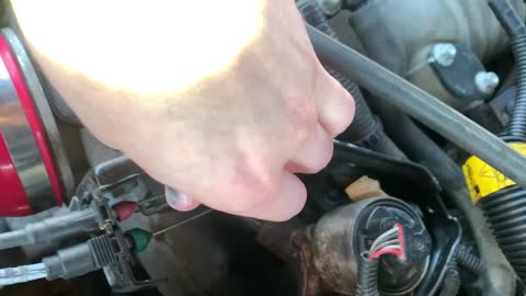

JDOT6
  • 11 POSTS
And another.
Mar 3, 2021 at 8:07 PM
JDOT6
  • 11 POSTS
I think maybe my supercharger belt is worn. pulleys are loose or the supercharger bearings, or the supercharger coupler.
Mar 3, 2021 at 8:08 PM
NICKOLAOSF
  • 69 POSTS
It sounds like lower end noise. if when you raise the idle the noise is heavier, you have lower end noise (rod knock). there is a possibility for your blower to have a failure. determine by removing the drive belt and listen again.
cheers, Nick
