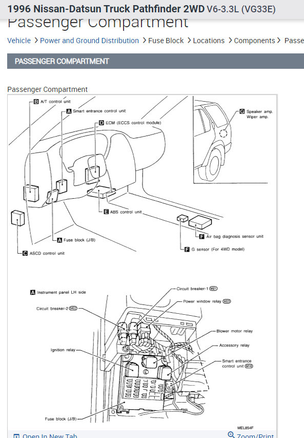

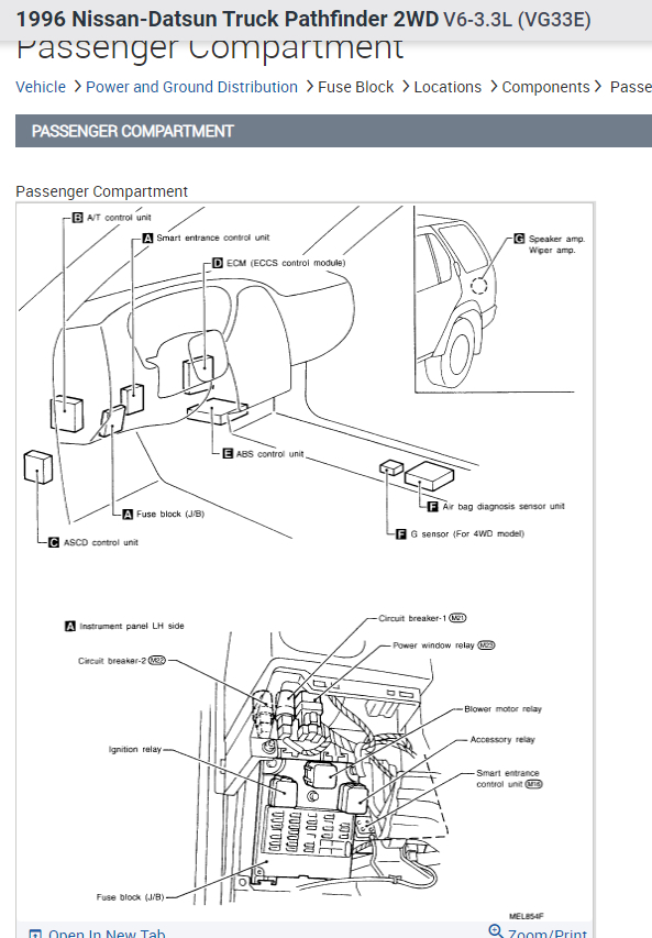

Hi, what is these three relays on the interior junction panel?
Thanks!!!
Aug 20, 2021 at 10:39 AM
SQM
  • 6,383 POSTS
The fuse panel has relays for the blower motor, accessory, ignition, window relay. Along with some other fuses. See attached diagrams for reference.
Is there a specific item you are trying to address?
Here is a relay testing procedure:
Let me know of any questions.

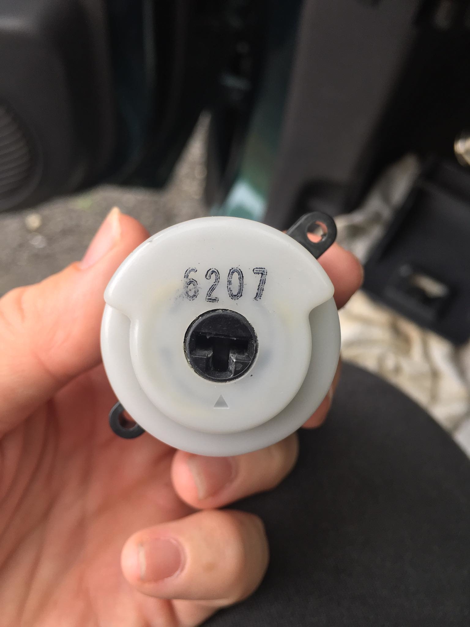

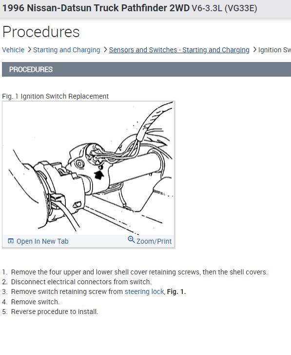

Just to clarify, when you turn the ignition, sometimes you will not have any lights on the dash and the engine will not start, right?
If so this can be a issue with the ignition switch. As overtime the pins on the switch gets worn and fails to connect when you turn the key.
Try this when it happens again, see if you can turn the light using the light switch.

SQM
  • 6,383 POSTS
Okay, so if you can turn on the headlights when the key is inoperative, that will point to a possible bad ignition switch.

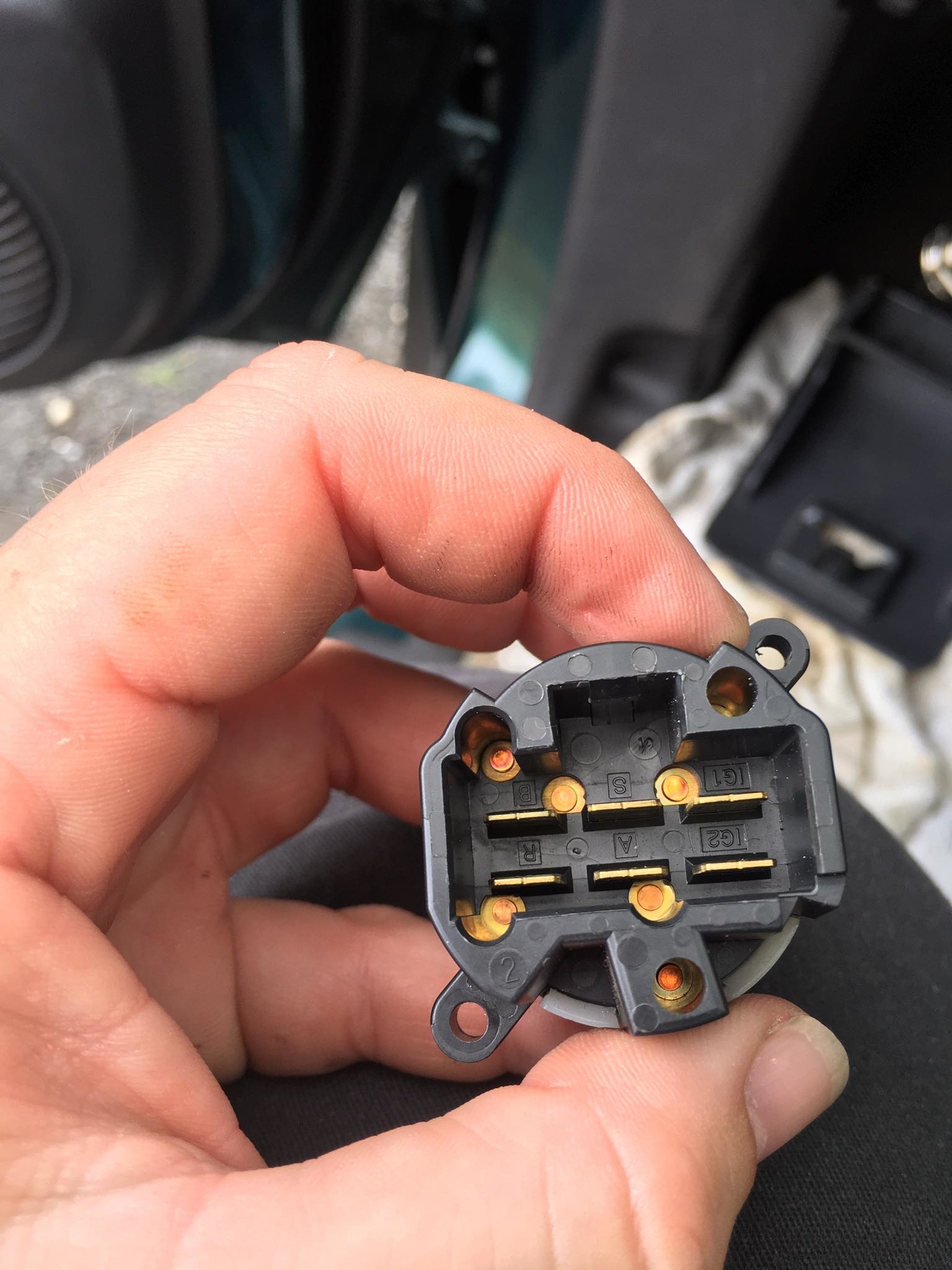

JOSEPH669
  • 14 POSTS
hey, i think is the ignition switch too. i'm going to work with that now. i let you know anything.

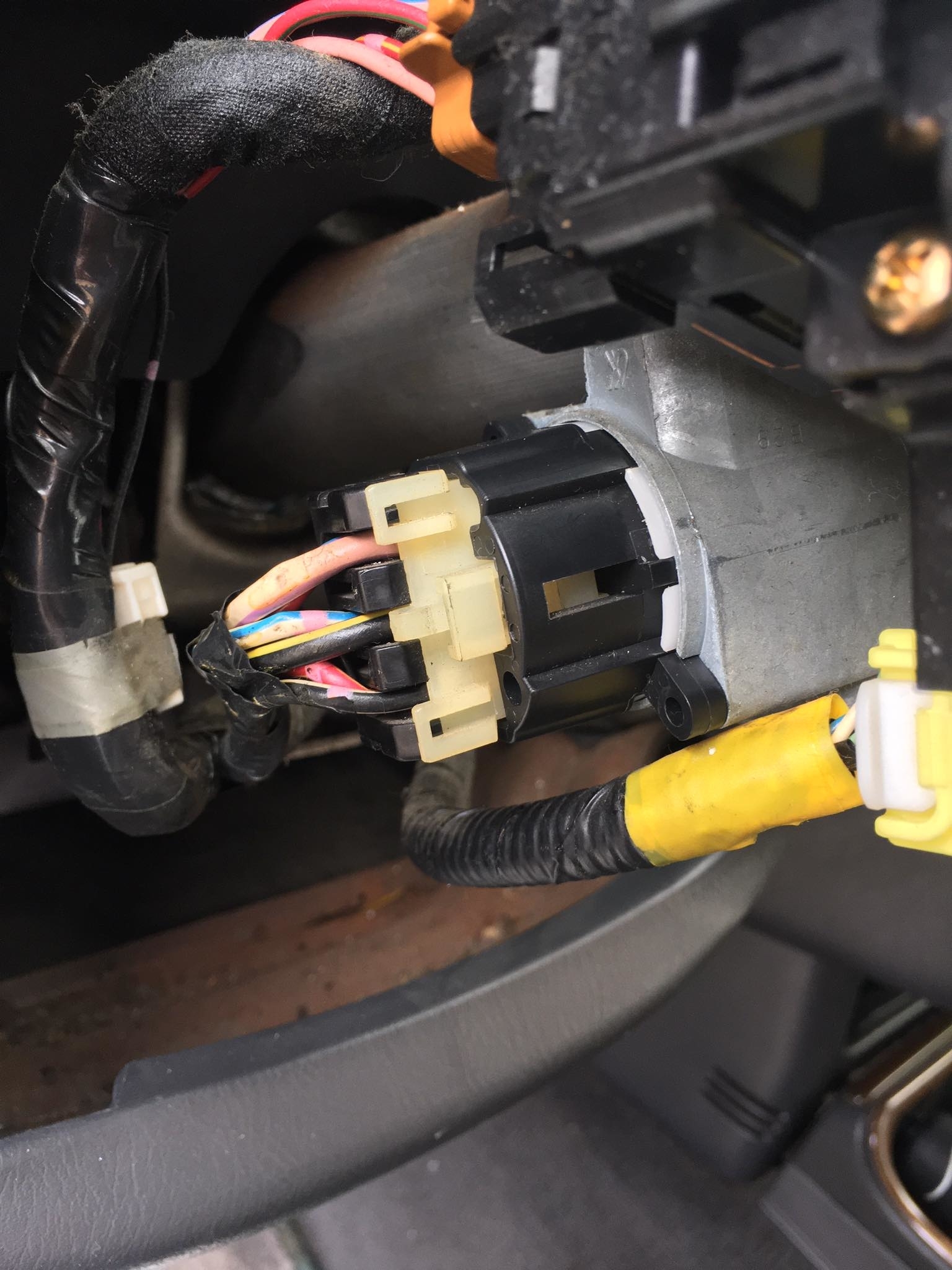

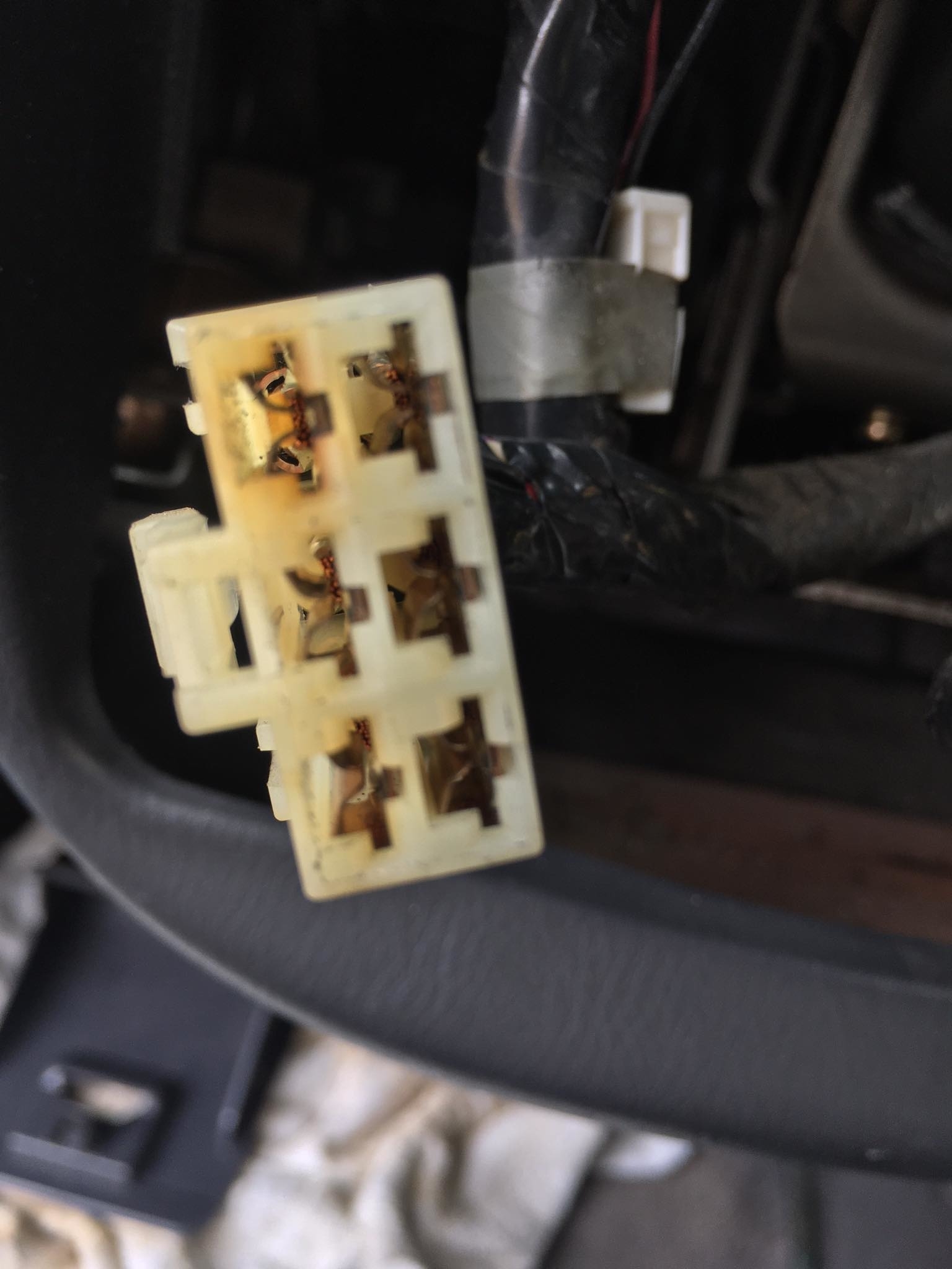

JOSEPH669
  • 14 POSTS

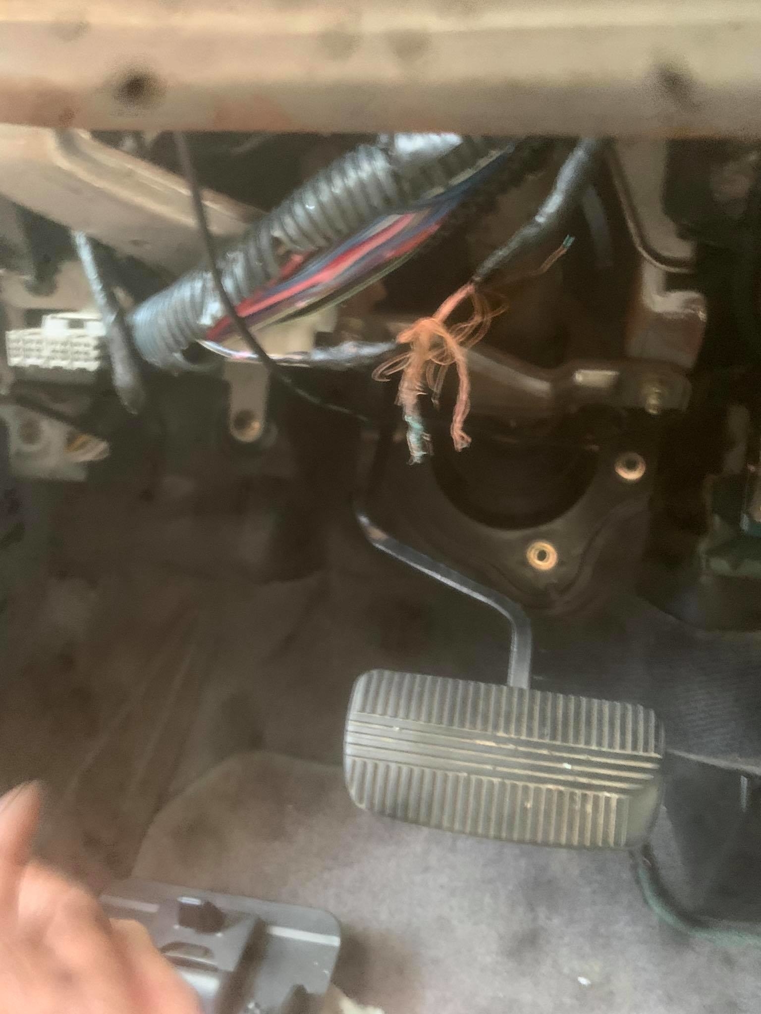

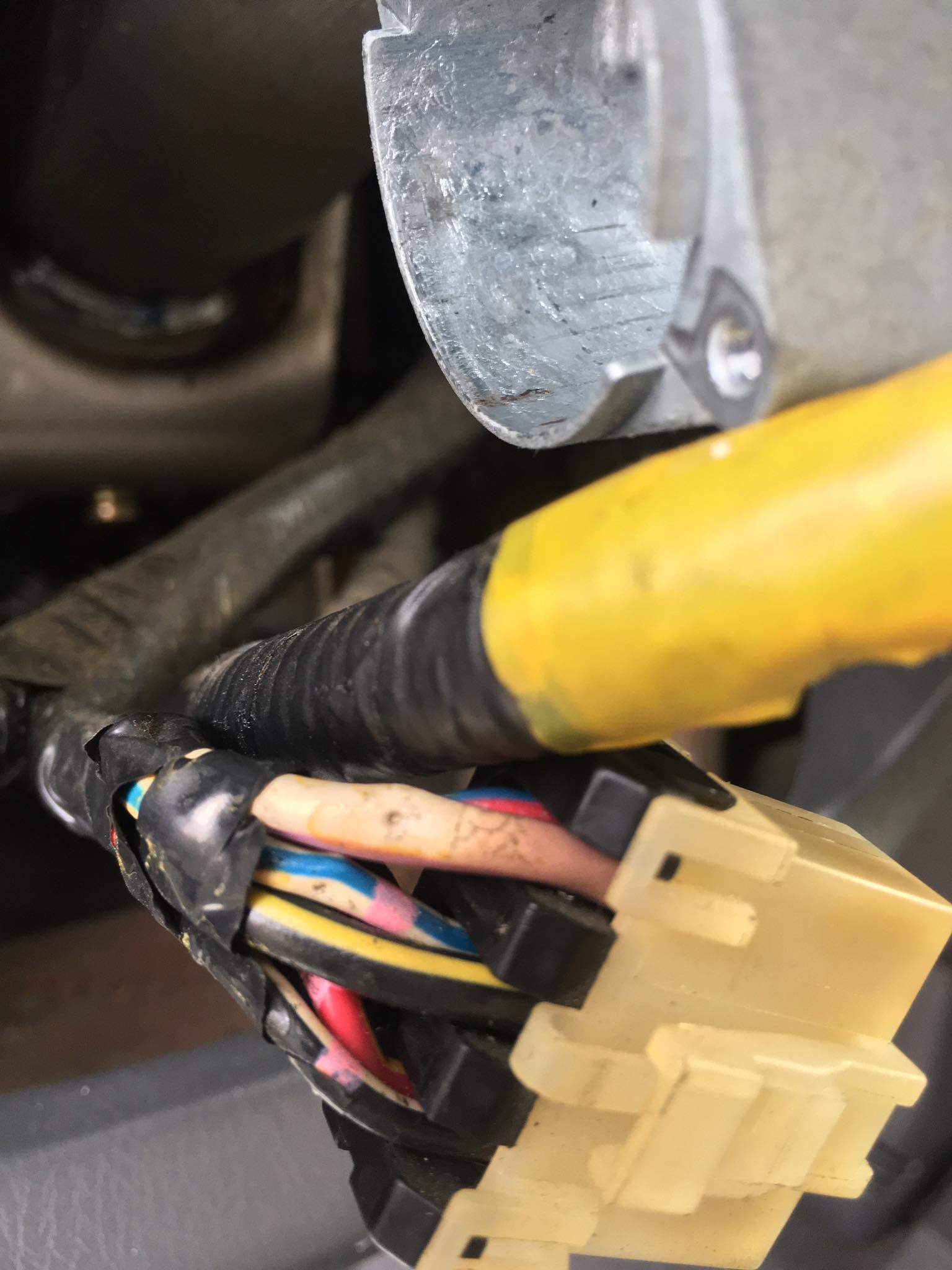

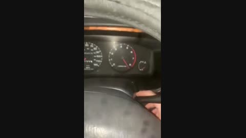

this is what i found. i think that one cable is kind of burned and you can see the plug i think is bad, but i started the truck a couple time and no problem, this is weird (and i upload a video when i turn the key).
Aug 21, 2021 at 11:56 AM
SQM
  • 6,383 POSTS
Since you got at apart clean out the terminals. It is possible to have just a bad connection.
Aug 21, 2021 at 2:59 PM
JOSEPH669
  • 14 POSTS
i clean it,and turn the key a lot of times and no problem,i hope it was just a dirty terminal.

JOSEPH669
  • 14 POSTS

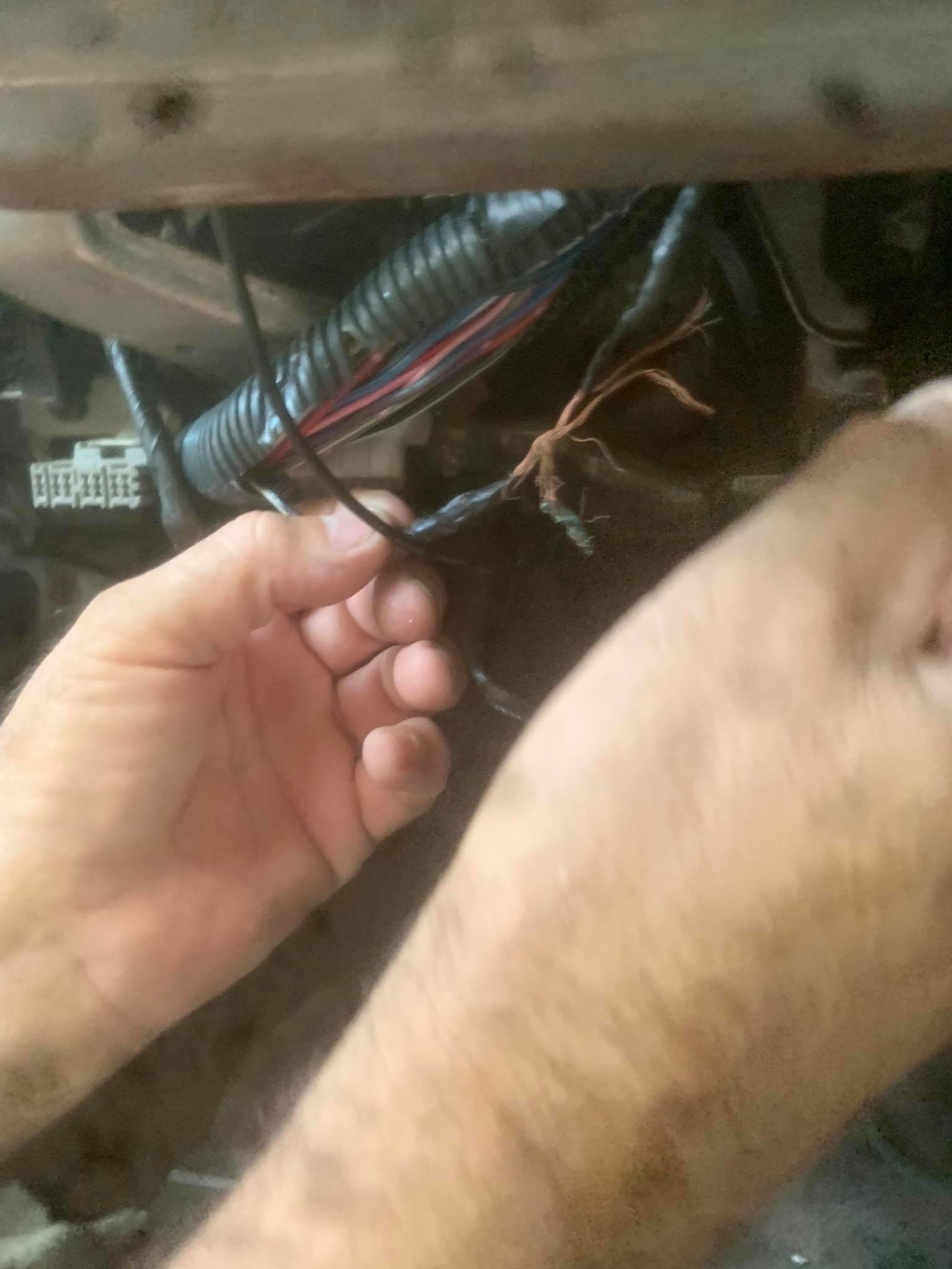

hi, today i have found the problem and fixed it!!! i think in some point the truck have an alarm or a shut off switch to prevent the truck from being stolen, and that was fine the problem was that when i buy the truck i think that they may remove the alarm but instead of doing it right they ripped off the cable and that (the cable on the pic) cable was burned and have oxidized.
i just cut of the bad part of the cable and put a new one!!!
Aug 22, 2021 at 5:32 PM
SQM
  • 6,383 POSTS
You know we come across this many times.
Interestingly when the alarm system gets cut off in this nature, the issue with the vehicle varies. Some will have starting issues others will have issues with how the dash lights works and so on.
Glad you figured it out. Appreciate you sharing the information.
