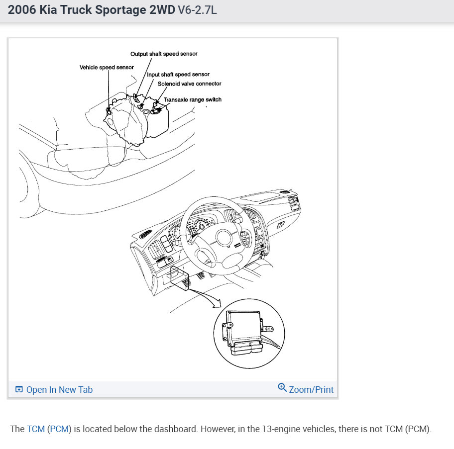

The backup lights on my 2006 4-cyl Kia Sportage won't come on -- even though the bulbs are fine and the fuse is good. I figure it's the neutral safety switch/backup sensor, but need to know where exactly that switch is located so I can change it out. Thanks in advance for any help!

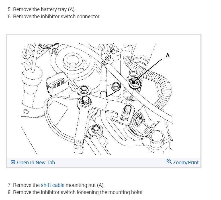

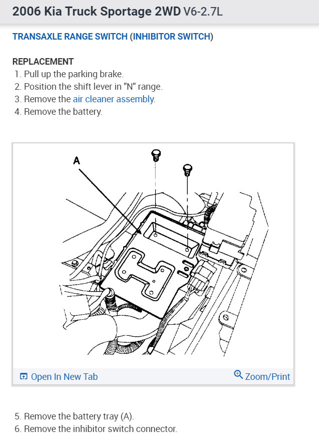

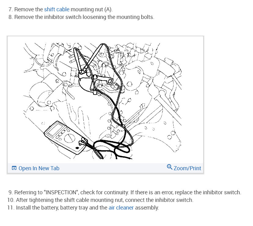

It is on top of the transmission here are the instruction on how to replace the unit in the diagrams below. Check out the diagrams (Below). Please let us know if you need anything else to get the problem fixed.
