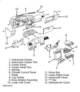

Actually my car is a 2002, but can you tell me how to get to the heater core?
Thany you
Cindy
Feb 22, 2010 at 1:05 PM
DOCFIXIT
  • 18,828 POSTS
It's a BIG job requires removal of instrument panel see diagram
https://images.2carpros.com/forum/automotive_pictures/198357_Graphic_362.jpg
