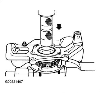

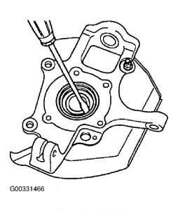

how to change the front wheel bearing on the kia
Aug 4, 2009 at 12:47 PM
MHPAUTOS
  • 31,937 POSTS
HI there,
you need to remove the wheel hub from the car and have access to a large hydraulic press, do you have this equipment to hand? if so let me know and i will post the procedure .

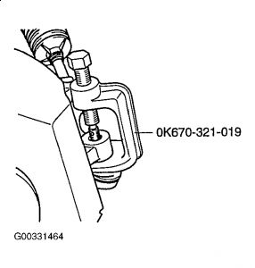

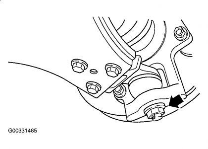

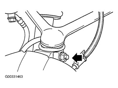

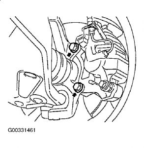

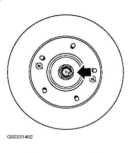

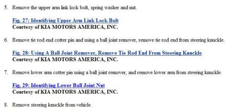

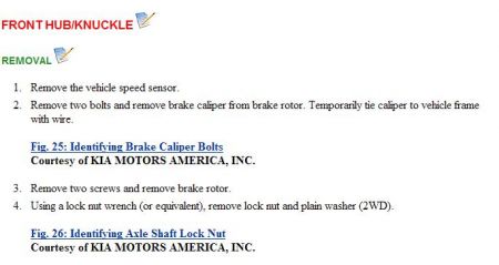

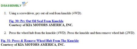

how do u get the hub off of a 2005 kia sorento so i can change the wheel bearing
Aug 5, 2009 at 3:09 PM
MHPAUTOS
  • 31,937 POSTS
I will get the details when i get access to Mitchell 1 a bit later to day and post them here.
mark
Aug 5, 2009 at 3:17 PM
MHPAUTOS
  • 31,937 POSTS
See text for removal of steering hub. mark (mhpautos)
