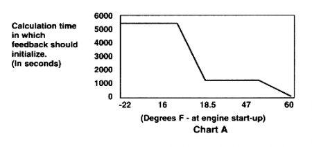

Insufficient engine coolant temperature for closed loop fuel control
After engine start-up, the elapsed time before feedback operation is initiated is too long [Engine Coolant Temperature (ECT) sensor input is insufficient for closed loop operation

3. Clear codes and verify any repairs by driving vehicle while monitoring ECT and Fuel Stat 1 in user data list with SCAN TOOL. Refer to chart "A" for amount of time in which Fuel Stat 1 should show closed loop operation after engine has been started. (Get start-up temperature by accessing user data with ignition key on and engine off before starting vehicle...
