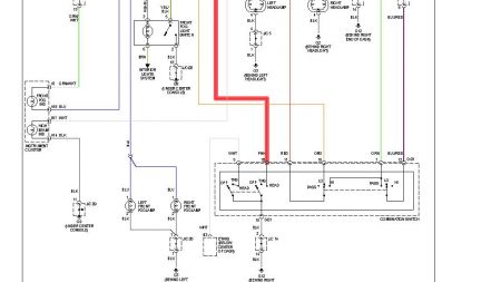

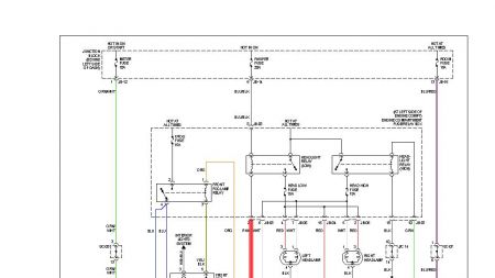

Low beam headlights suddenly quit working at the same time as well as parking lights. High beams work and so does blinkers and emergency flashers. Any ideas? Fuses and relays all checked out fine. I can make them work by "hotwiriing" the relay (putting an unbent paper clip in the holes).
Apr 28, 2008 at 12:40 AM
  • 75,992 POSTS
If you can do magical stuff with a paper clip to make them work by jumping the relay get a voltmeter now and check the circuitry see EWD below
https://images.2carpros.com/forum/automotive_pictures/12900_h1_1.jpg
https://images.2carpros.com/forum/automotive_pictures/12900_h2_1.jpg
