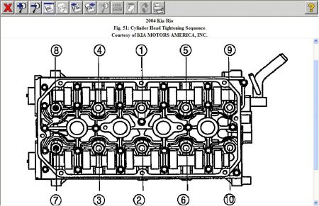

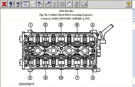

the timing belt broke and i had to replace it .
did that and apparently the pistons bent the valvs so i need to know the unbolt sequence and the torque specs so i can begine taking the head off and get it off to the head shop to be re worked ... thanks again ... your last answer was very helpfull.

Loosening sequence
https://images.2carpros.com/forum/automotive_pictures/12900_head_loosening_1.jpg
Tightening sequence
https://images.2carpros.com/forum/automotive_pictures/12900_tightening_sequence_1.jpg
