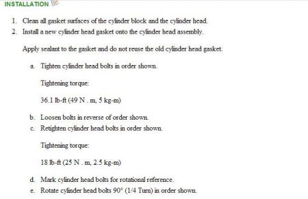

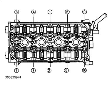

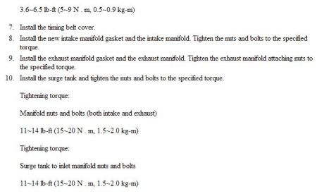

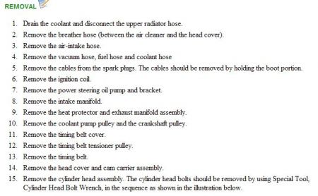

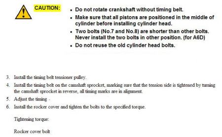

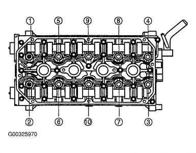

i need to know what all needs to come off of the head and what the torque specs for the bolts are on removal and install of the head

https://images.2carpros.com/forum/automotive_pictures/261618_Noname_1011.jpg
https://images.2carpros.com/forum/automotive_pictures/261618_Graphic_182.jpg
https://images.2carpros.com/forum/automotive_pictures/261618_Noname2_284.jpg
https://images.2carpros.com/forum/automotive_pictures/261618_Noname3_107.jpg
https://images.2carpros.com/forum/automotive_pictures/261618_Graphic2_21.jpg
https://images.2carpros.com/forum/automotive_pictures/261618_Noname4_56.jpg
https://images.2carpros.com/forum/automotive_pictures/261618_Noname5_25.jpg
https://images.2carpros.com/forum/automotive_pictures/261618_Noname6_16.jpg
