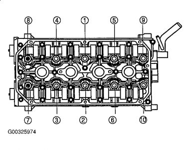

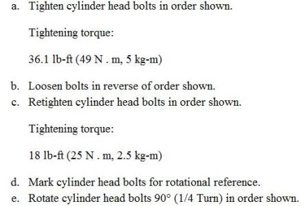

2004 KIA RIO
Engine Mechanical problem
2004 Kia Rio 4 cyl Automatic
cylinder head torque and sequence for 1.6 liter kia rio
