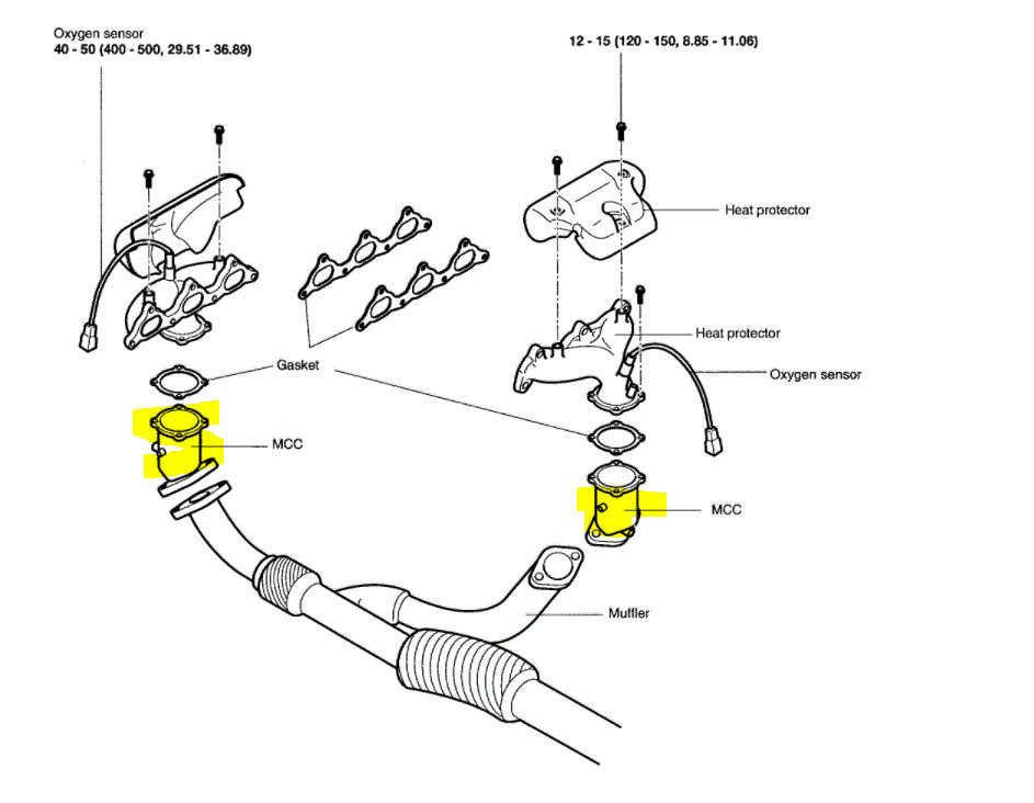

The check engine light came on the codes were for the rear catalytic converter, so we had it replaced along with the sensors, and the light came back on. What could be the problem?

Hello again, I finally got the code "P0431" and it says "secondary DTC is P0455.
Maybe that will help on my part, get back to me please.

The P0431 indicates a failed catalytic converter, bank 2. If that is the one that was replaced, it should have a warranty. I attached a pic below showing the converters.

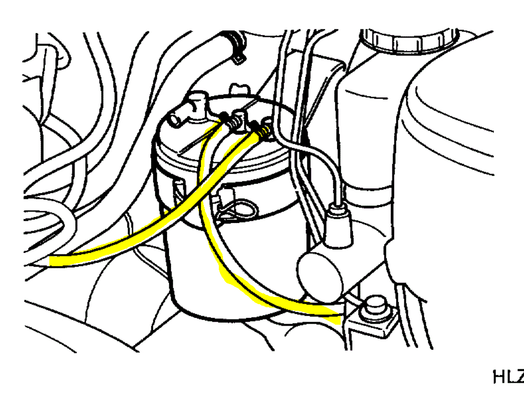

Now the P0455 indicated a large evap leak. This is in the evaporative emissions system. Since it is a large leak, it shouldn't be too hard to find. Make sure the fuel cap is tight, check the fuel filler tube for rust damage, Also, open the hood and locate the EVAP charcoal canister. It is near the brake master cylinder. Check the vacuum hoses attached to it for damage. Also, follow the hoses to the engine and one to the fuel tank and check for issues.
Pic 2 shows the charcoal canister.
I can't be sure, but there is a chance if we can get this leak fixed, the converter will be fine. A large leak is causing an engine vacuum leak. If the fuel mixture is lean enough, this could be throwing the oxygen sensors off causing the code.
Let me know what you find. Also, here is a link you may find helpful. It explains how to test for an engine vacuum leak.
