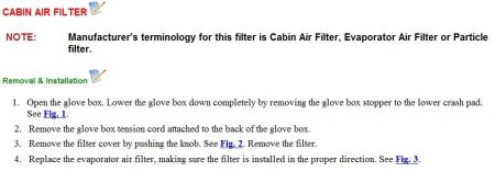

At your convenience will you tell me how easy it is to do and where I can get step by step instructions. I was told the dashboard would need to come out, but I've seen online that that other cars are done from under the hood. I was unable to find an answer for my Amanti. Thank you so much
Rosemary
Oct 19, 2010 at 2:14 PM
BLUELIGHTNIN6
  • 16,542 POSTS
https://images.2carpros.com/forum/automotive_pictures/261618_Noname_2805.jpg

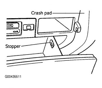

FIG.1
https://images.2carpros.com/forum/automotive_pictures/261618_Graphic_740.jpg

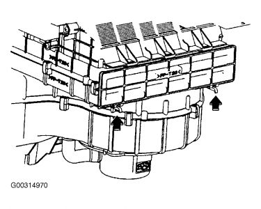

FIG.2
https://images.2carpros.com/forum/automotive_pictures/261618_Graphic2_101.jpg

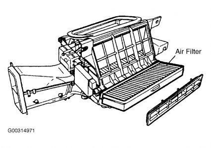

FIG.3
https://images.2carpros.com/forum/automotive_pictures/261618_Graphic3_17.jpg
