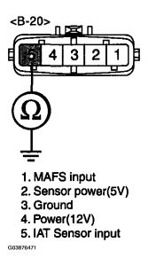

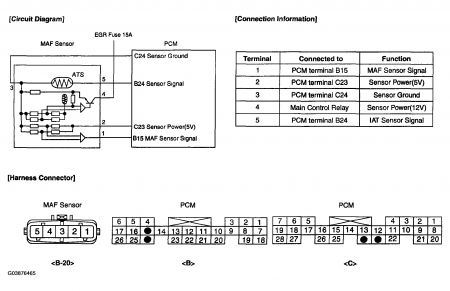

My air intake tube has a 5 pin wiring harness connected to it. What are the colors of the 2 wires in the harness that goes to the iat sensor?

Check voltage in harness 1.Ignition "OFF" Disconnect IAT sensor connector. Ignition "ON" & Engine "OFF" Measure voltage between terminal 5 of IAT sensor harness connector and chassis ground. Specification: Approx. 5V
https://images.2carpros.com/forum/automotive_pictures/62217_kia_1.jpg
https://images.2carpros.com/forum/automotive_pictures/62217_kiab_1.jpg
