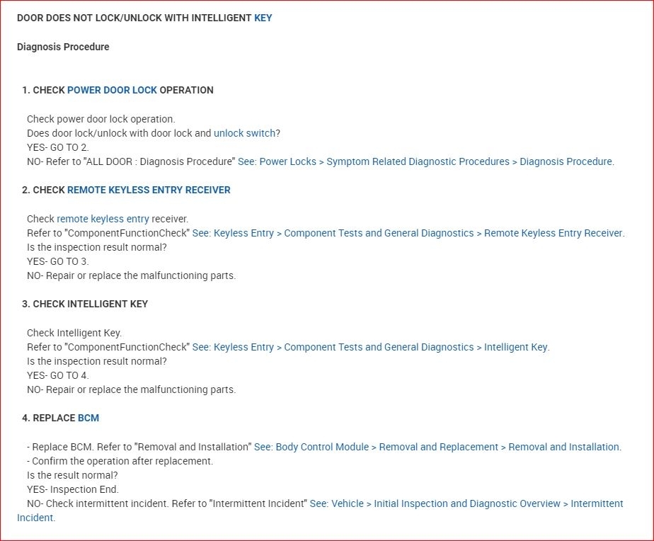

My intelligent key works to open the doors remotely and to remotely start the car. However, the push buttons on the door handles (proximity) sporadically don’t work and the key-less ignition doesn’t work all the time (need to push button several times and sometimes get message incorrect key ID). I’ve replaced batteries with good batteries many times, reprogrammed the remotes, and even bought a new remote but the problem continues. Help!

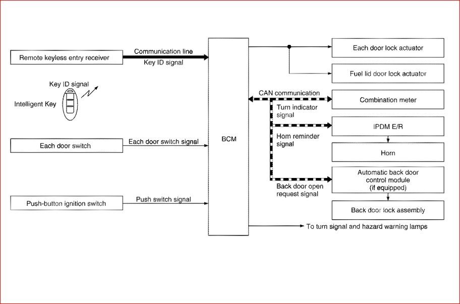

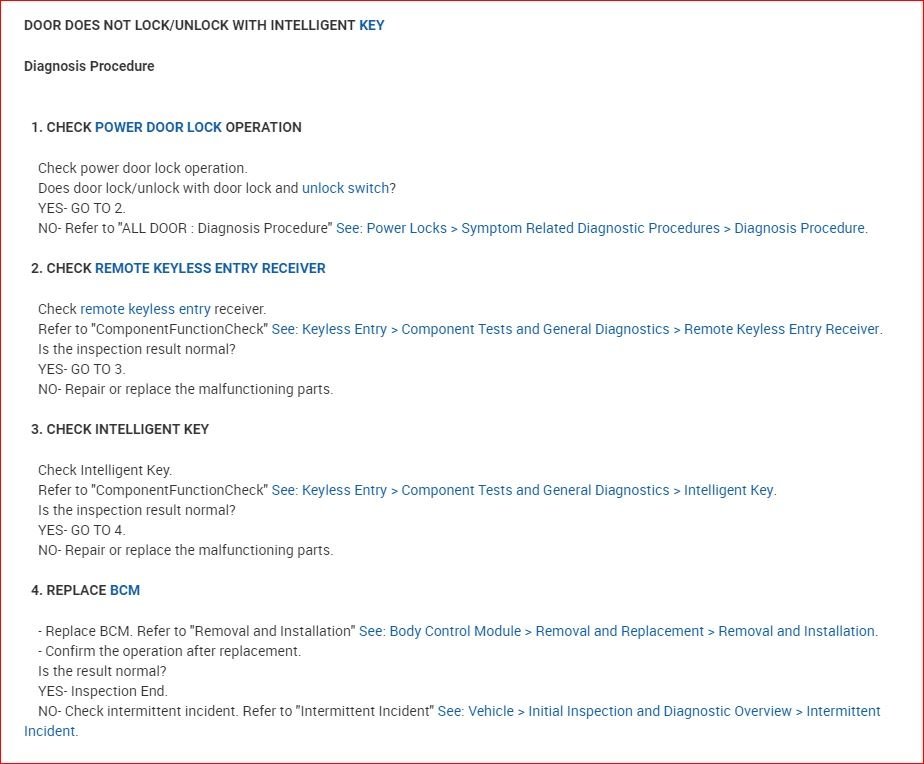

I attached the test if the door locks did not work all the time. I know this is not the case but it helps explain what the issue could be. Then take a look at the diagram of how your system works.
If the key is good, then the issue appears it could be the remote receiver or BCM itself.

1. Yes. A different key, even though the buttons are not being pushed can interfere with your signal. Any electrical device will interfere. It is usually not notable but it can contribute to the issue.
2. The remote key-less entry receiver is different than the key-less ignition. You technically have 3 systems at work here.
First, the remote key-less entry. When you press a button on your remote, it sends that signal to your remote key-less entry receiver which sends the message to the BCM.

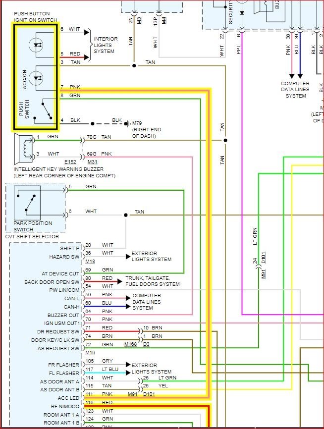

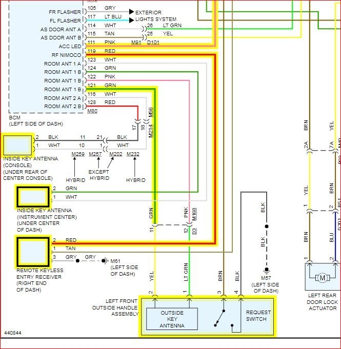

Second, the passive entry system for your door handles. This has an antenna inside the handle so that when you are close enough with the key, it will sense the proper key is there and when you press the button on the handle, it sends a signal to the BCM that it is okay to unlock the door.
Third is your key-less ignition system. This uses the antennas placed around your vehicle to sense if the correct key is inside the vehicle. If it is, then it sends a signal to the BCM to start the vehicle.
3. I may have misunderstood which was not working. The fact that all operation with your remote are working shows that the remote key-less entry receiver is functioning. However, the two systems that relay on your proximity and the antennas placed around the vehicle to locate the key seem to be your issue. If you look at the third attachment, these inputs to the BCM are separate and direct inputs. This would point more to the BCM.
Also, the fact that you are getting a message that says incorrect key and not Key Not Detected points a corruption issue in either the BCM or caused by interference. This is where you need to confirm this with a scan tool and see what the BCM is seeing when you are getting this message.
The easiest way that I have found to determine if this is interference or not, is when you get this message normally pressing the button a couple more times makes it work. Instead of pressing it multiple times until it picks it up, just pull the key out after the first time it tells you incorrect key ID and hold it in the hand that you are pressing the button with. If it starts the next time or unlocks the next time then you have an inference issue. If it does not start or unlock with the key right next to the button, I would suspect you have a BCM issue.
Hopefully this helps. I apologize for any confusion.

Haha. Okay. Key not detected is usually always an interference issue or the antenna on that side as an issue. If the antenna is faulty on that side of the vehicle then the other antennas have to pick up the difference and basically the BCM thinks the key is further away then it actually is. These antennas can be tested with a scan tool.
