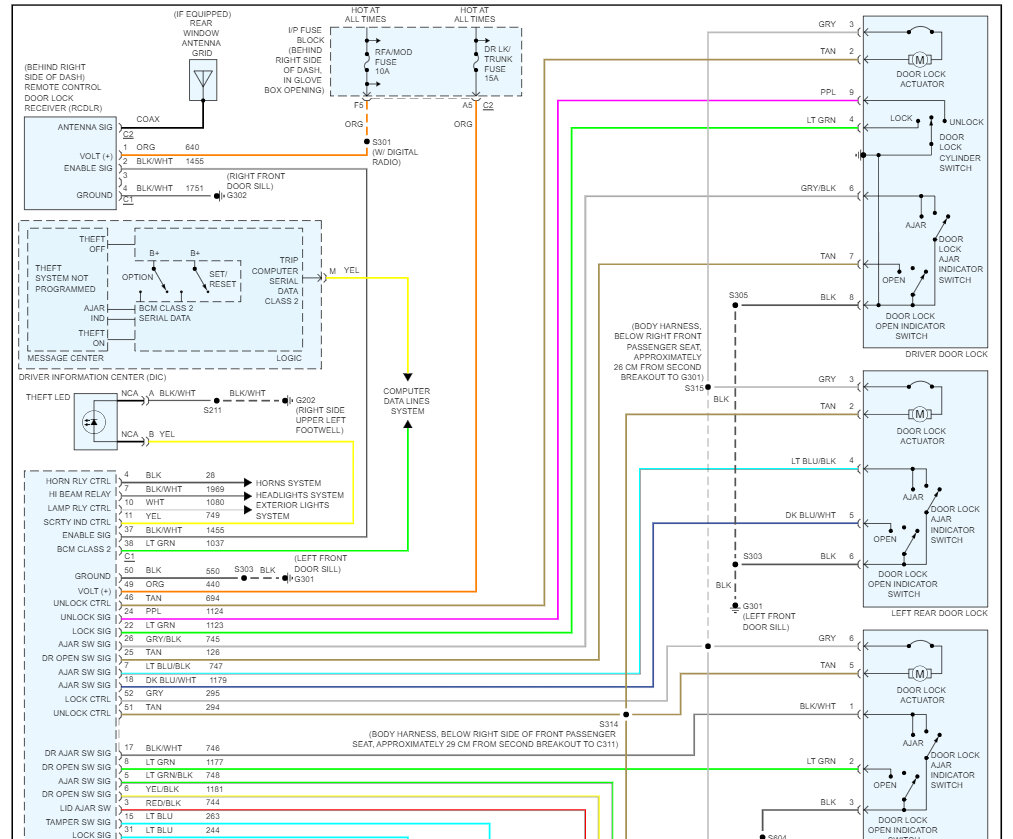

I purchase this car without any key fobs. I purchased two new fobs and plugged in a diagnostic tool and is unable to program the remotes. It keeps saying programming failed. My question is, could it be a faulty ECU or wrong type of key fob because there is one with remote start and one without. Also, could it be some type of controller in the car that is faulty?

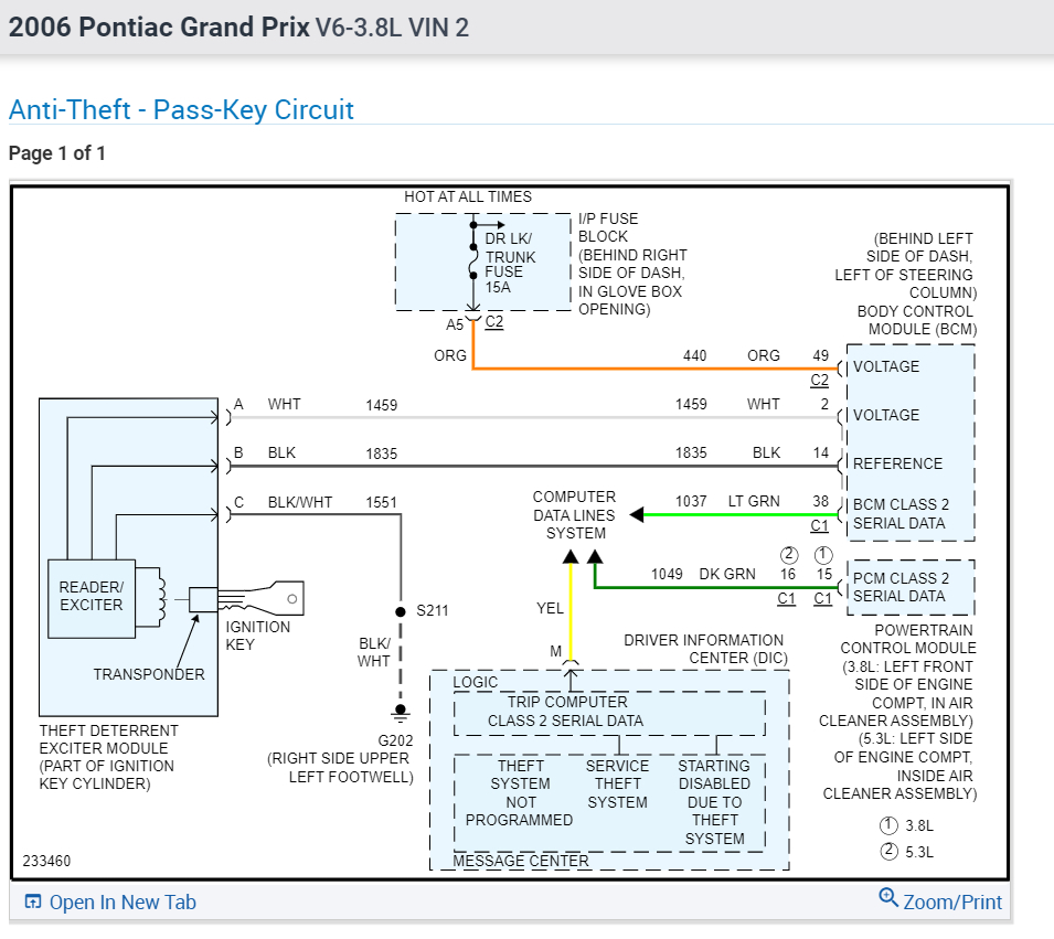

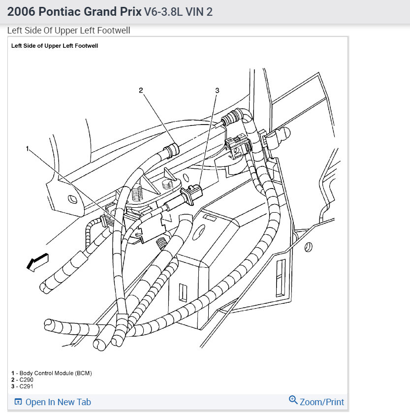

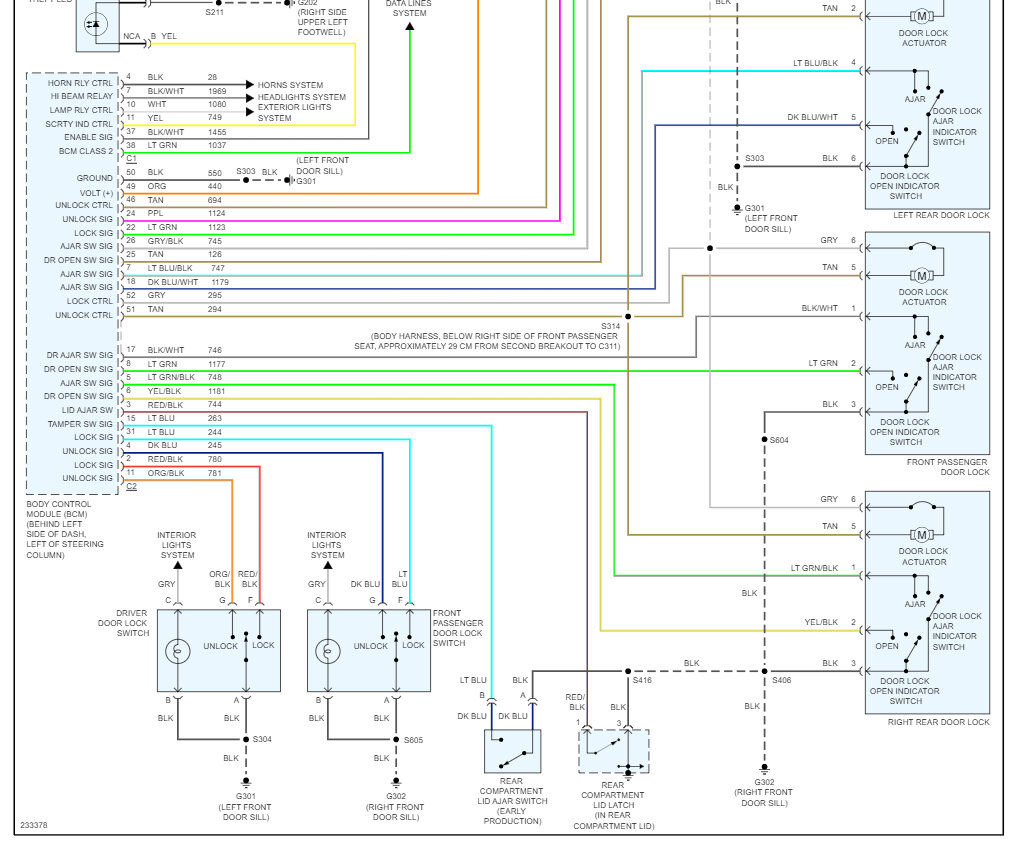

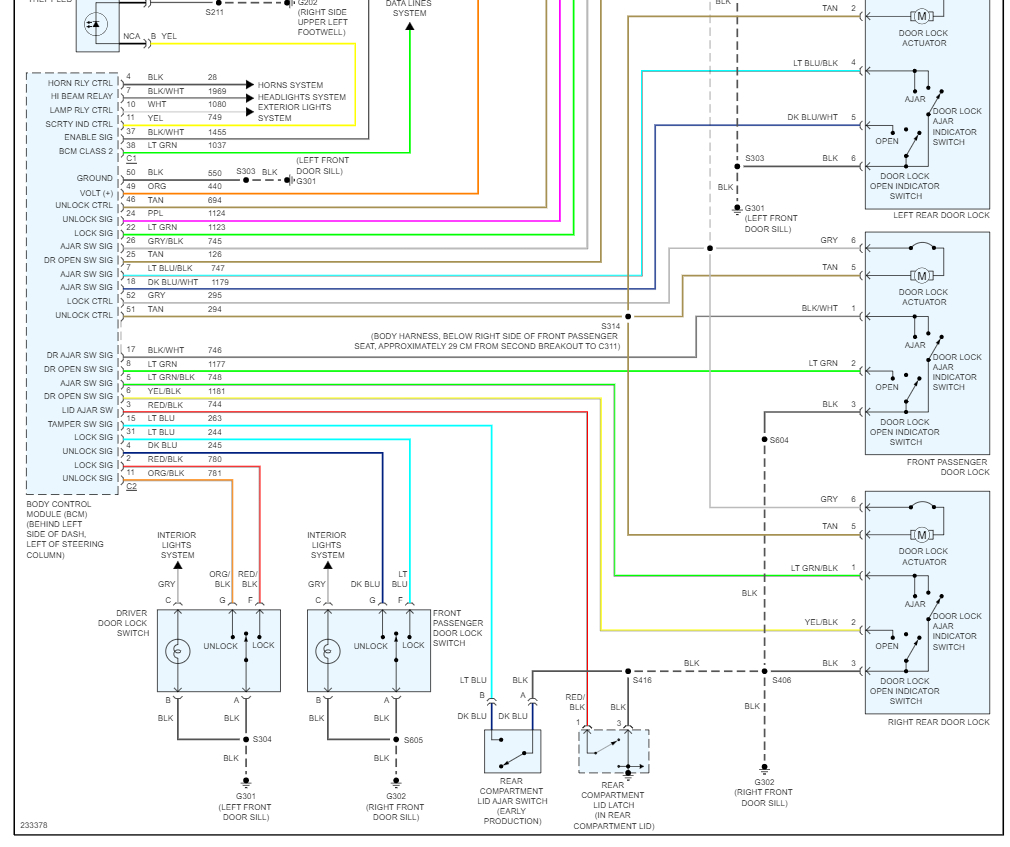

Yes, it could be the fobs or the BCM needs to be replaced, I would start with a CAN scan, you can get a CAN scanner (Controller Area Network) which will work on most cars from Amazon.
https://youtu.be/u-4syLc-ifQ
Here is how to change out the BCM in the images below in case you need it. Also, I have included the security system wiring diagrams so you can see which fuses to test and how the system works. Check out the images (below). Let us know what happens and please upload pictures or videos of the problem so we can see what's going on.

I had also reprogrammed the ECU using GM Tech online software and still no luck.
Or is it the BCM?
Aug 2, 2023 at 8:35 PM
  • 55,433 POSTS
Yep, the BCM is what holds the key and fob programming. Let me know what happens please.
