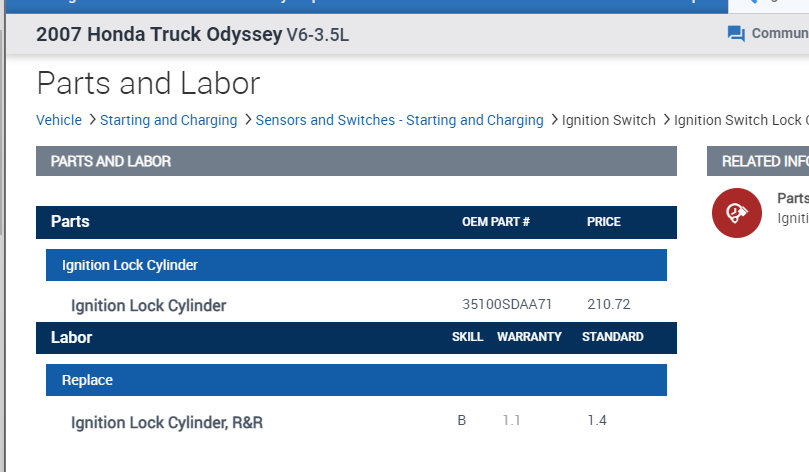

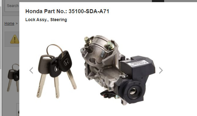

I tried to go start up my van this morning, and the key went into the ignition easily but wouldn't turn. I tried moving the gear shifter from park to neutral and back to park, then from park to drive and back to park, but it still wouldn't work. I then tried to move the steering wheel, but it just turned a tiny bit and then locked, and nothing has worked that I've tried since.

There are a couple more things worth trying. Let's start with using a small amount of spray silicone on the key and then insert it and work it back and forth.
Sometimes these metal keys get stuck due to picking up lint and first and putting it in the switch.
Here is a guide that will give more details about this:
https://www.2carpros.com/articles/ignition-switch-wont-turn-stuck
Worst case we will have to replace the ignition switch but let's try this first and go from there.
