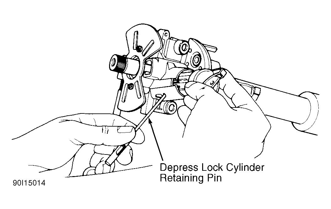

Need to disable airbag pull fuse in engine compartment box . remove covers around column may need to loosen colum bolts then inset 1/8 drill bit in hole on ignition remove cylinder look at switch can operate with screwdriver. if it has positions and start s and stops then replace cylinder see diagram

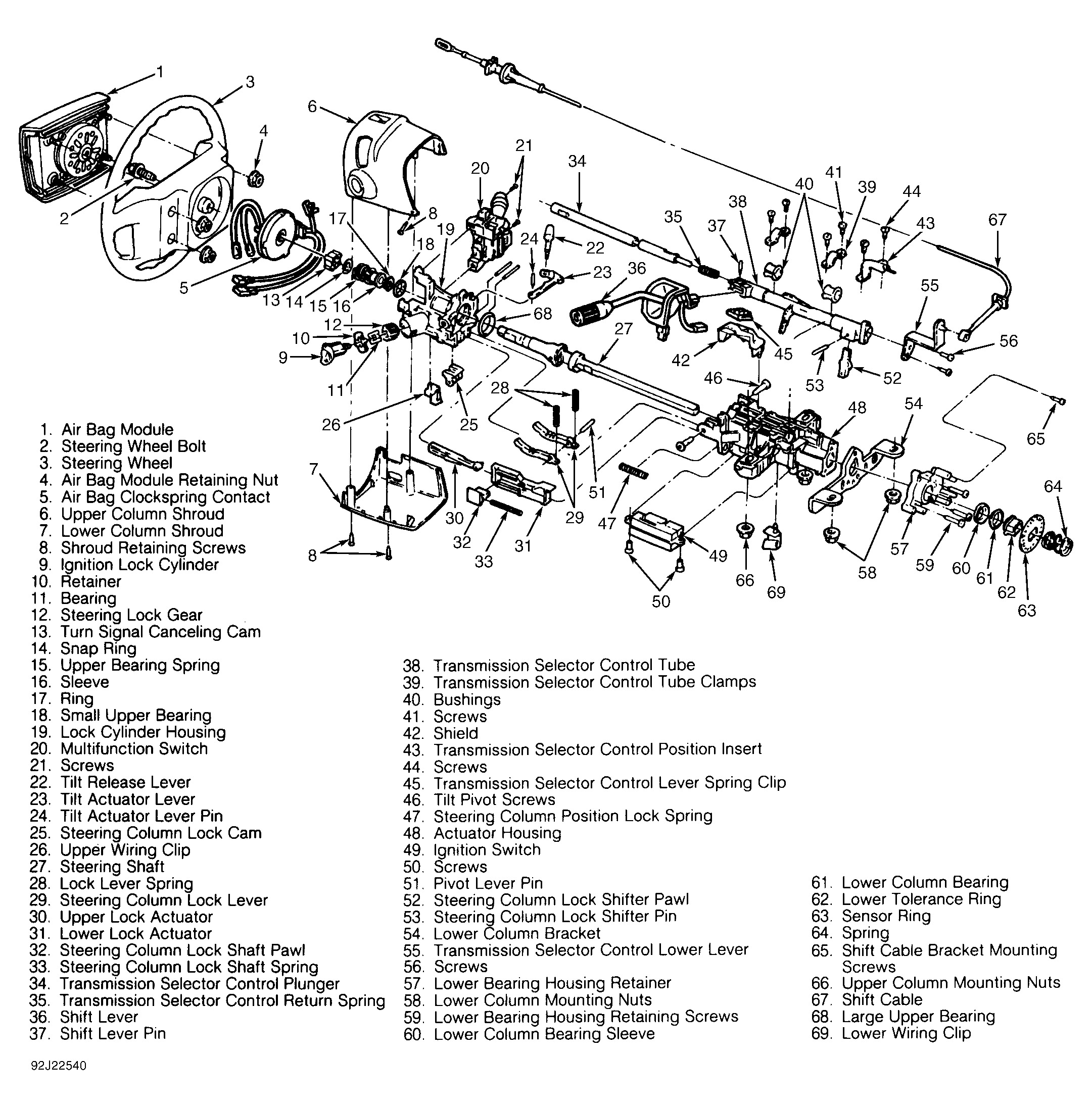

DOCFIXIT
  • 18,828 POSTS
Try sending exploded view of column maynot be that big but may need to enlarge with different program.
Think maybe damage to actuators , slider or cam lock going to be a seak and find mission. if switch works manualy the problem in actuators
