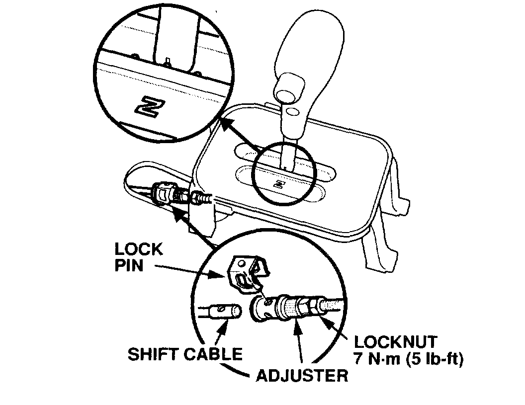

Hello, my car key is currently stuck in the on position. I have tried all the listed options and is still stuck. My father had me remove the fuel pump fuse to turn the car off. After doing so the car has turned off. However, the shifter won't budge and power steering is inactive. Should i just go ahead and replace the ignition cylinder?

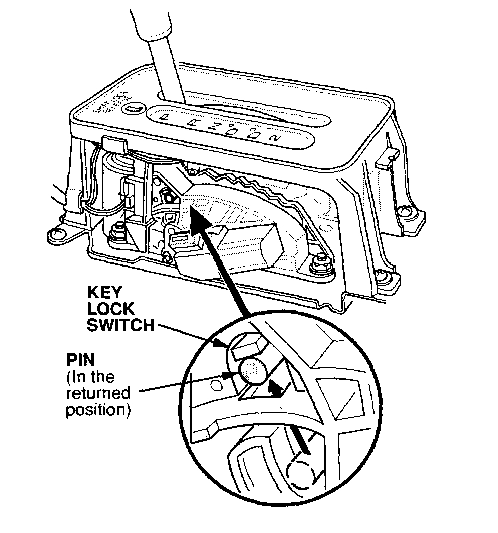

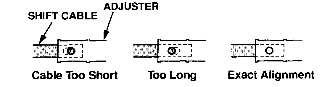

I don't think the key cylinder is the problem, but instead, the park interlock is out of adjustment. I dug up a technical service bulletin that I want you to look through. It discusses the issue you are having and how to repair. All attached pictures correlate with these directions.

1. Make sure the shift lever is in Park.
2. Remove the center console.
Picture 1
3. Inspect the key lock switch. If the pin is not in the switch, jiggle the shift lever back and forth without taking it out of Park.
^ If the pin does not return and the key cannot be removed, continue with normal troubleshooting.
^ If the pin returns and the key can be removed, go to REPAIR PROCEDURE.
REPAIR PROCEDURE
1. Move the shift lever to Neutral.
Pic 2
2. Remove the lock pin from the shift cable adjuster.
Picture 3
3. Check the alignment of the hole in the adjuster with the hole in the shift cable. The holes should exactly align.
4. Loosen the locknut on the adjuster. Turn the adjuster in or out until the holes exactly align. Torque the locknut to 7 N.m (5 lb-ft).
5. Reinstall the lock pin. If the lock pin binds as you install it, the shift cable is still out of adjustment.
6. Move the shift lever to all the gear positions. Make sure the shift lever position indicator shows each gear position.
7. Move the shift lever to Park. Make sure the key can be removed from the ignition switch.
8. Insert the key in the shift lock release slot, and make sure the shift lever releases.
9. Reinstall the center console.
