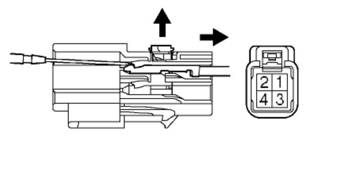

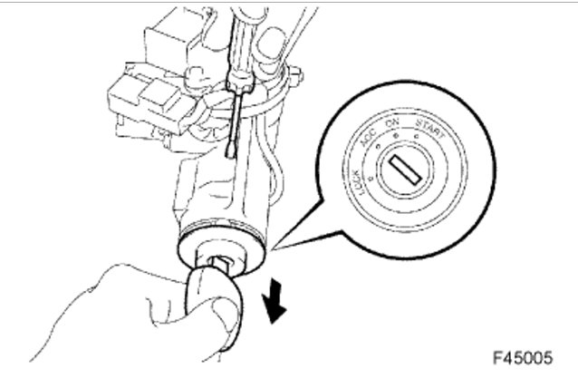

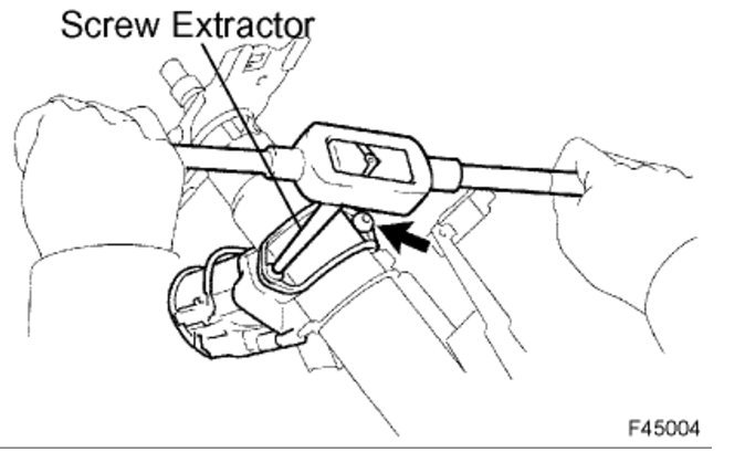

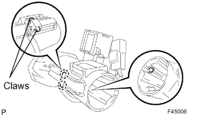

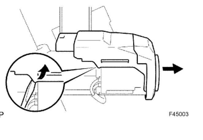

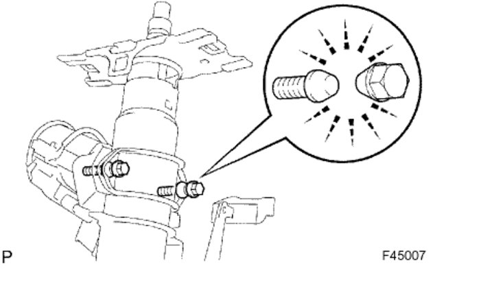

Here is a guide that will help you replace the the unit with a new one:
Please let us know what happens and upload pictures of the problem.
