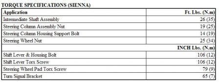

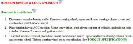

How do you install one on a 2000 toyotta sienna, or where can I find that information? Is it difficult?
