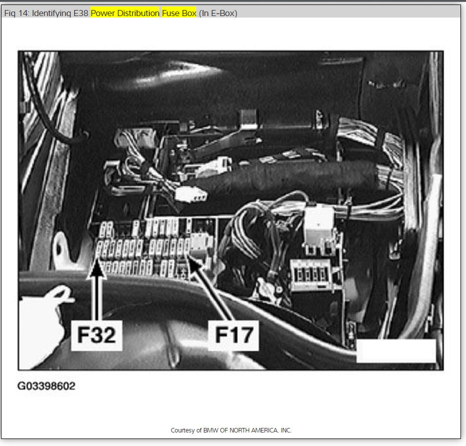

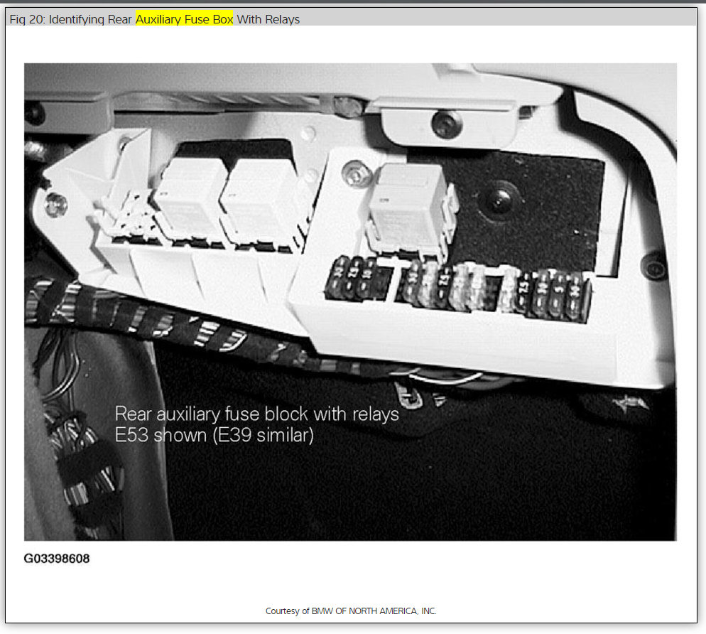

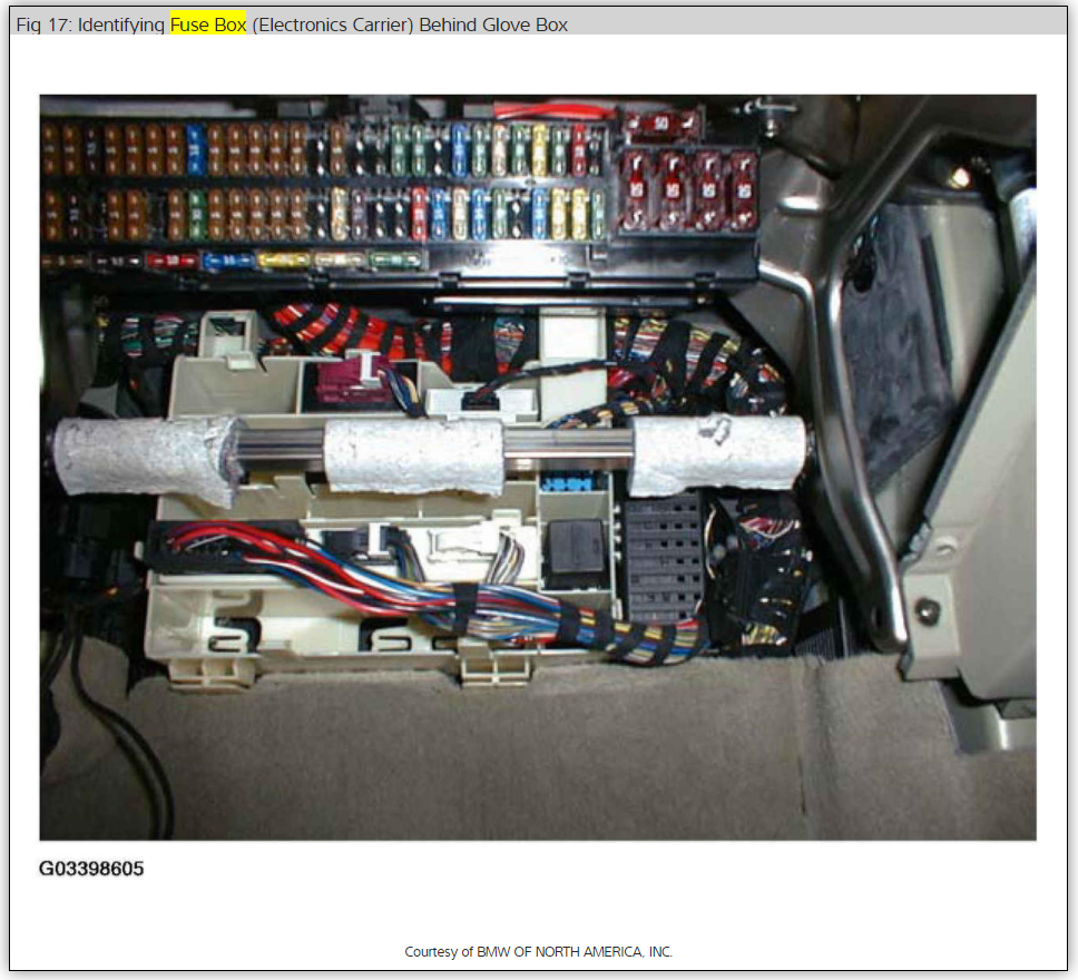

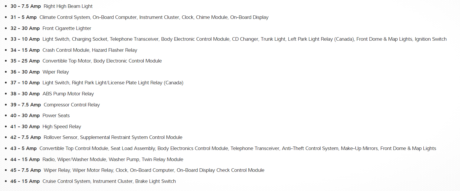

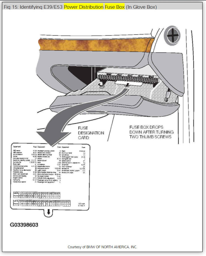

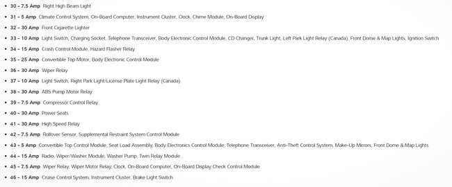

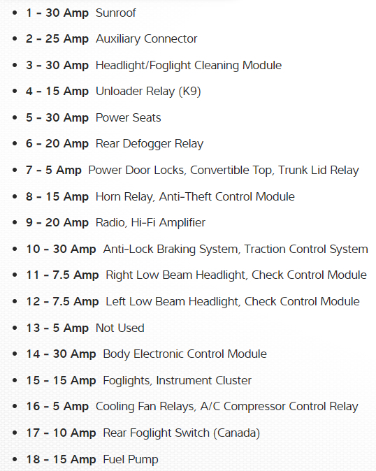

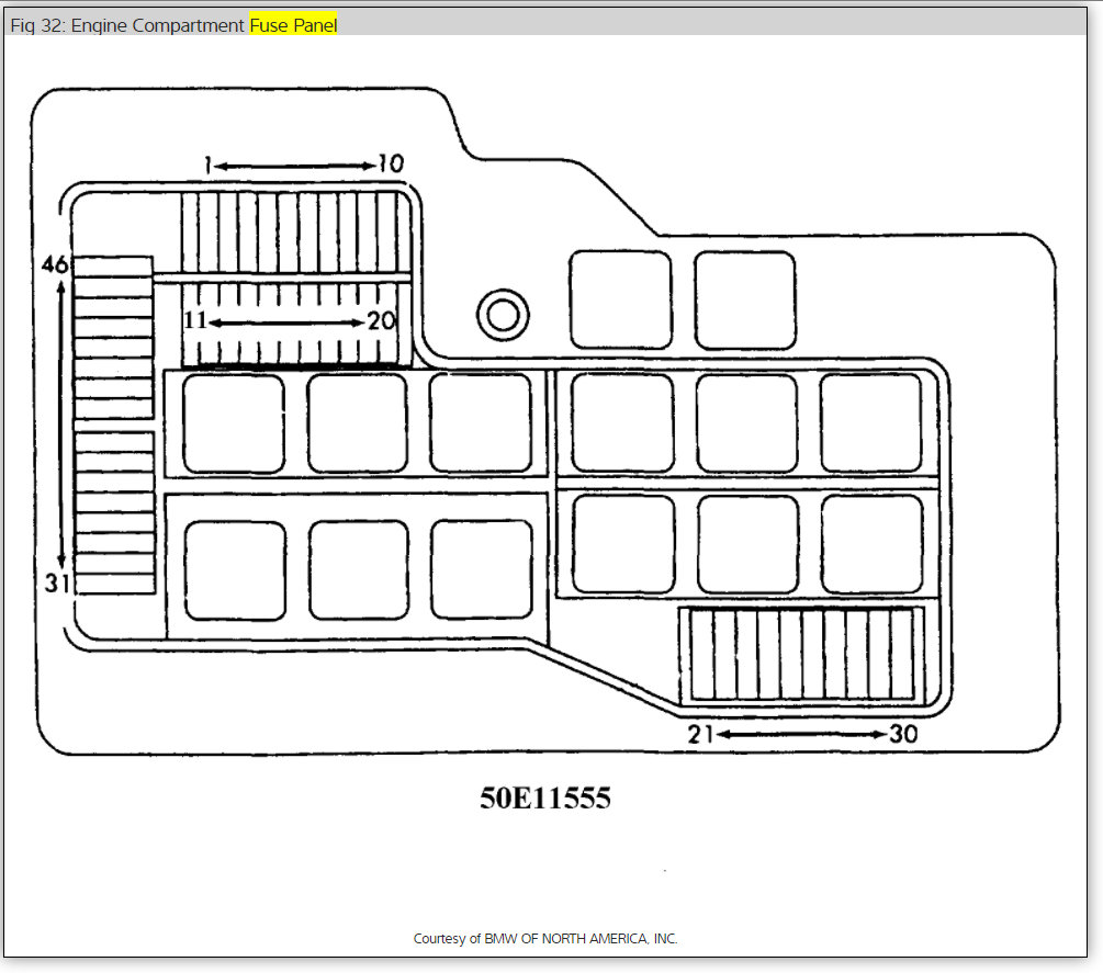

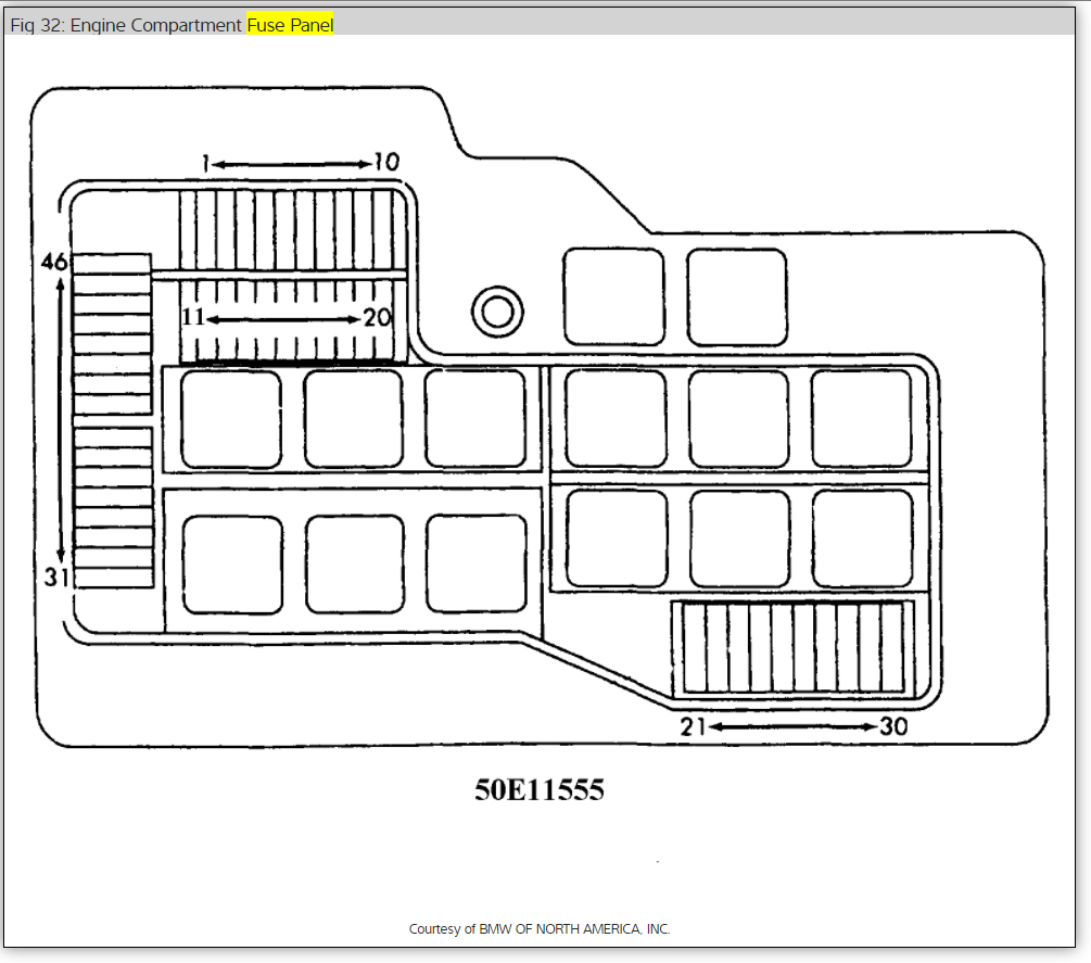

I have a second fob and it arms and disarms the alarm as well, but does not lock or unlock the doors. I have also checked all fuses and they appear good.
Sep 7, 2017 at 8:55 PM
  • 55,433 POSTS

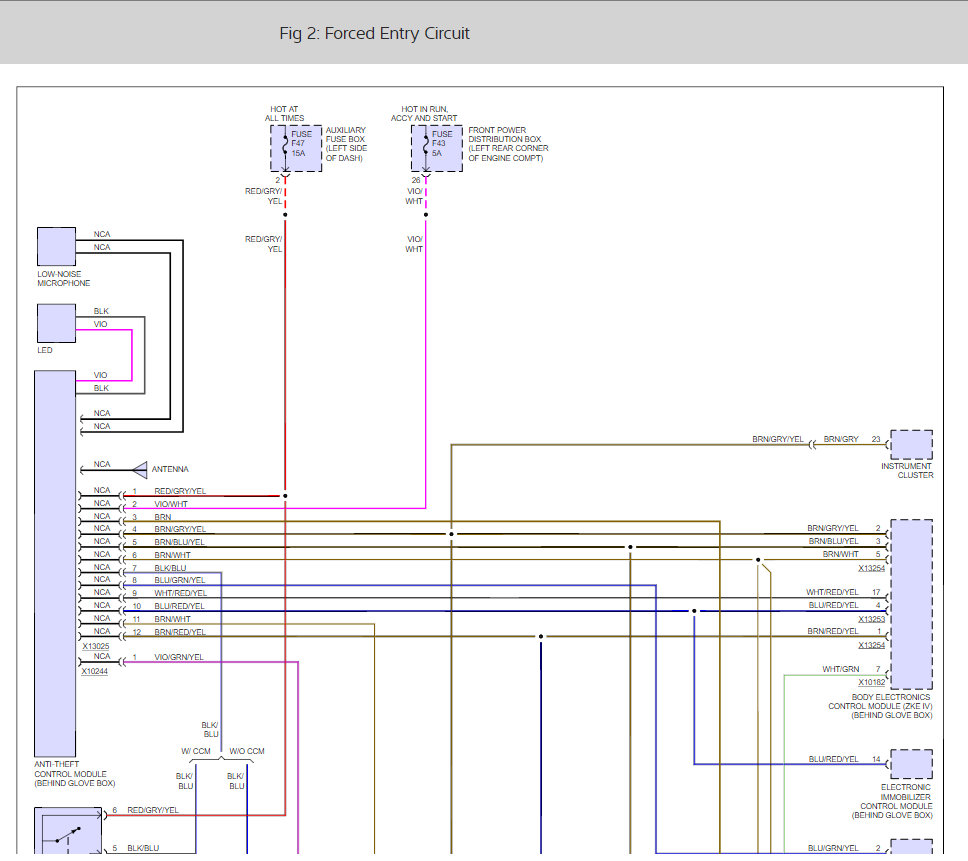

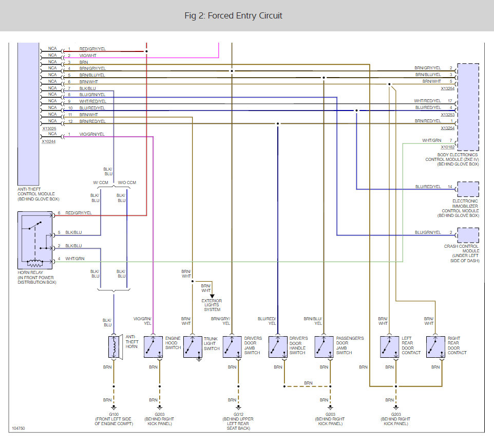

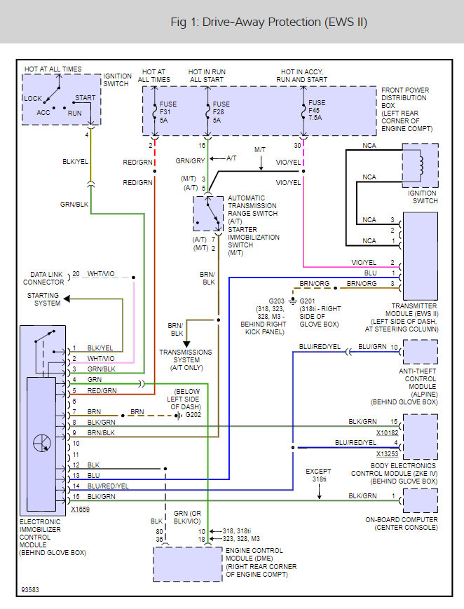

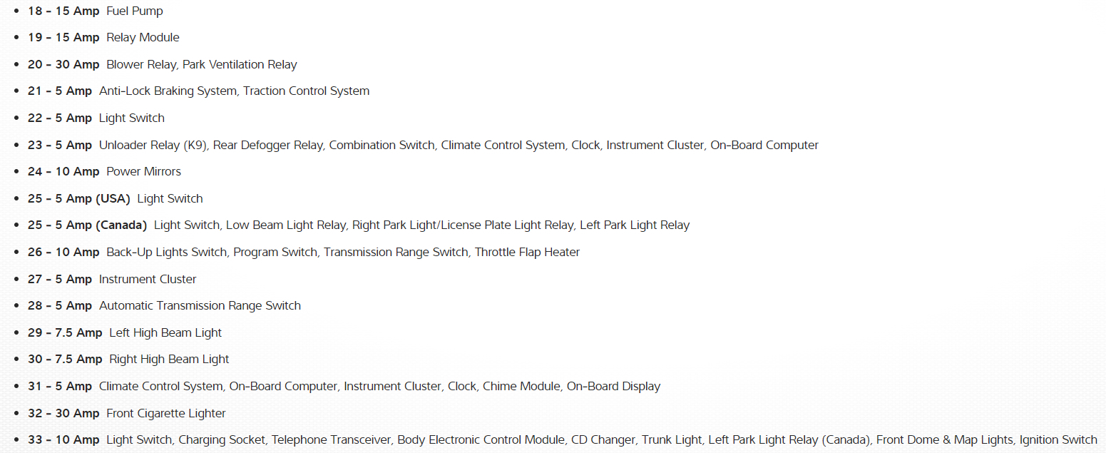

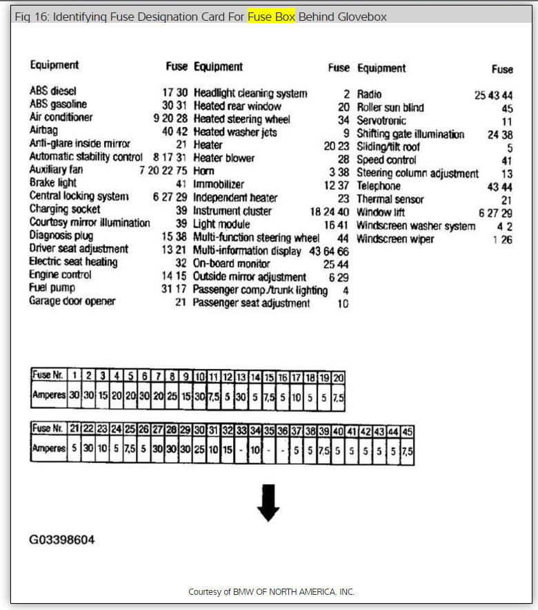

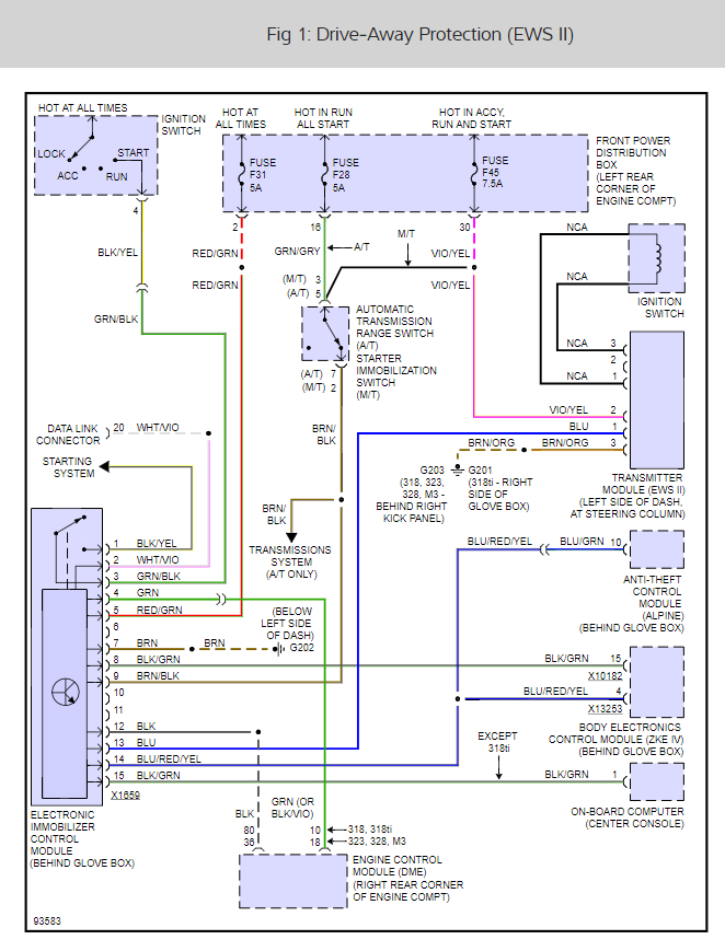

It sounds like you have an alarm module going out but to be sure I would double check all of the system fuses becasue that is more than one.
Here is a wiring diagram to help you see what fuses need to be checked.

If I remember correctly the BMW alarm module is a dealer installed unit. Plug and play as the wiring is already there. A 3 button remote with lock/unlock, panic and alarm arm/disarm on it.
Do you hear 3 chirps when you try to lock/unlock the car?
If so it is likely to be a bad actuator sense switch, there are switches in the door locks as well as the hood and trunk. They tell the BCM and alarm system if the doors/hood/trunk are closed. If any of them fail the locks will not respond.
The problem is determining which switch is the problem. Normally the doors and trunk will show a "door ajar" warning. If you don't see that it is probably the hood switch. They are a common issue. The test is to disconnect it, if the door locks start working you found the problem.
You can also look at the switch status on a factory scan tool. It would tell you which one is bad real quick.
