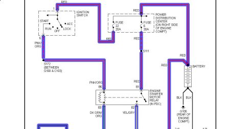

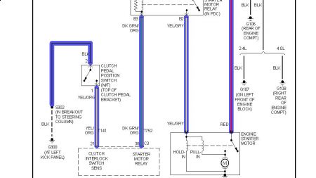

ALAN FORSTER
I jumped into my jeep to run an errand and it wouldn't start, lights and all electricals worked fine but there was no response from the engine at all when I turned the key. It was just like when you don't depress the clutch all the way. I played with it, shifting it into 4 wheel low and neutral and back again and then it suddenly turned on. I've had to do this 3 times now to get it to start. Any ideas?
Sep 26, 2020 at 5:16 AM (Merged)
  • 75,992 POSTS
Hi Alan Forster, Welcome to 2carpros and TY for the donation. Double check battery condition and connections to include the starter side Do this: Find the clutch switch on the clutch pedal bracket disconnect it and jumper it and also the starter relay in the power distribution center swap it with a like one and see what happens-Also view the Starting system EWD
