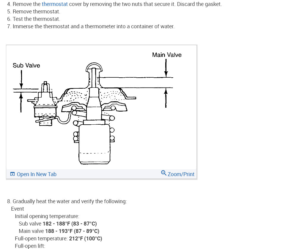

I've changed both coolant temperature sensors. Cleared code, and I'm still getting it again. Checked voltage at the connectors of the temperature sensors and one is reading 12v and the other is reading 5v. I've checked the wiring I can see, and it looks fine. I'm stumped.

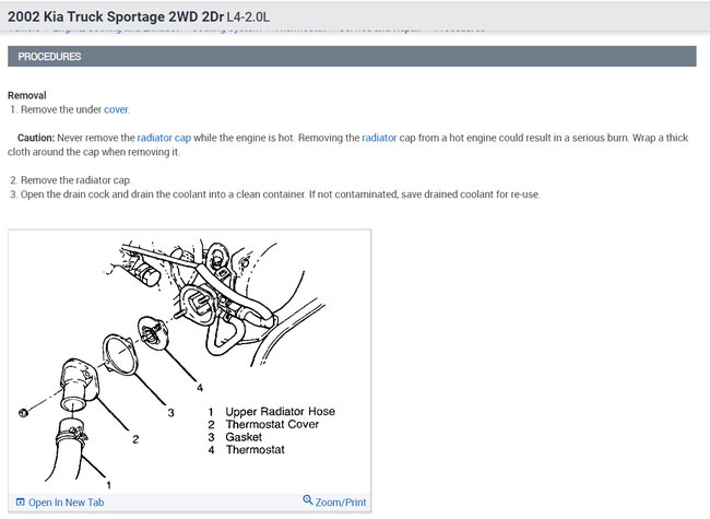

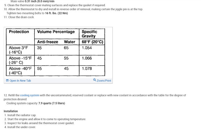

This happens when the engine cooling system thermostat goes out and is stuck open.
Here is a generic guide to help you step by step with instructions in the diagrams below to show you how on your car:
Clear the codes once completed, check out the images (below). Please let us know what happens.
