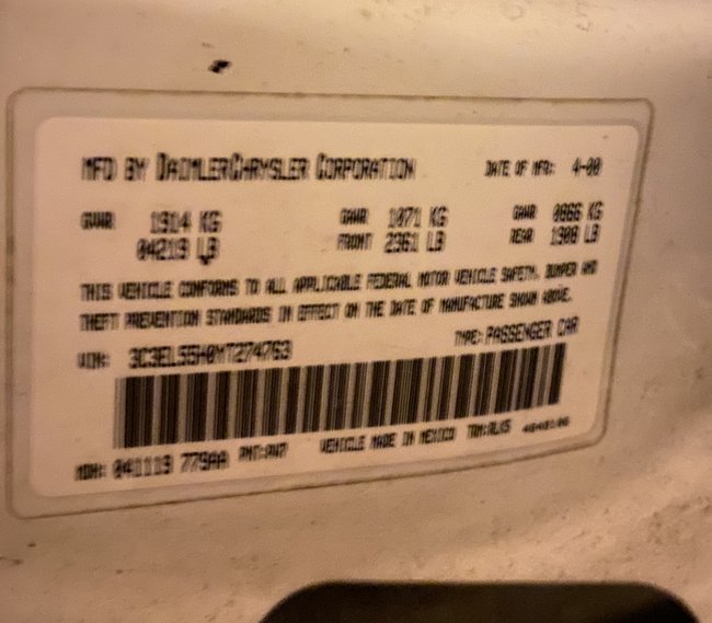

Assembled in Mexico April of 2000 series 1. The other sticker says it was put on the door in USA.

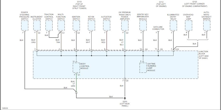

Hi:

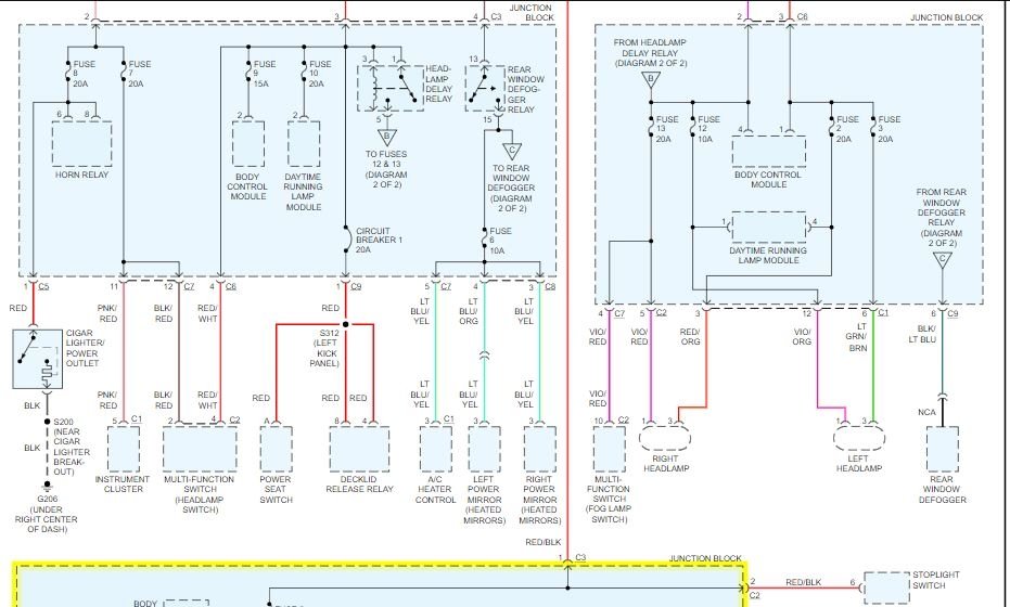

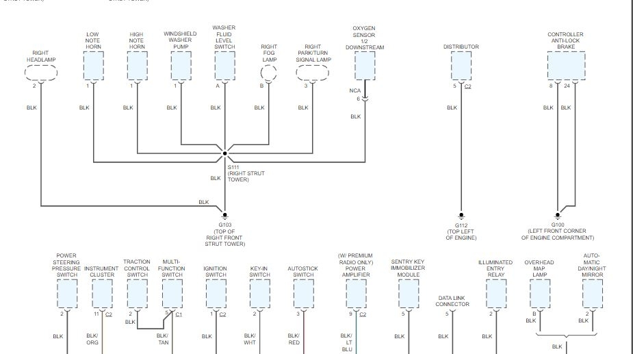

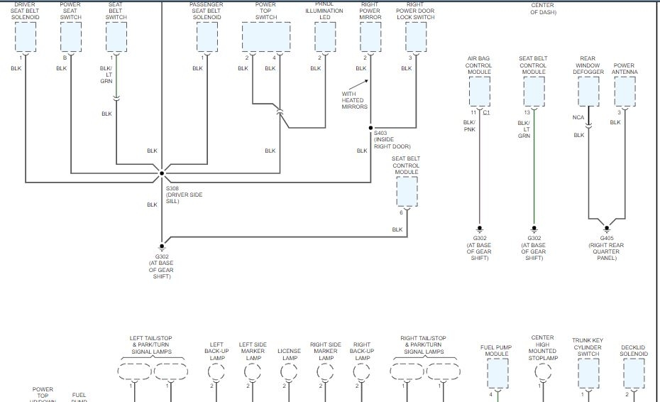

You have your hands full. However, I am a bit concerned regarding the smell at the steering wheel. Keep an eye on that. It, in every way, sounds like a ground or bad connection issue. I can upload schematics of the grounds or power system if it will help

Do you need the VIN because it’s within that gap? It should be on the picture of the door sticker; finicky and no user manual to see.

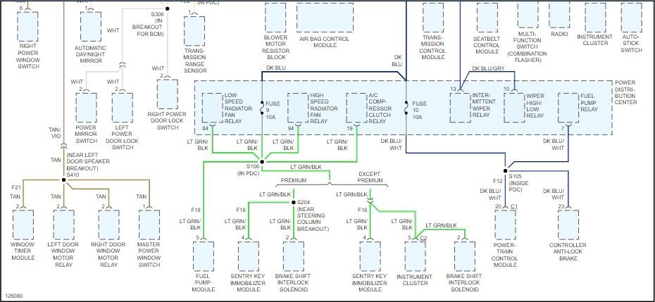

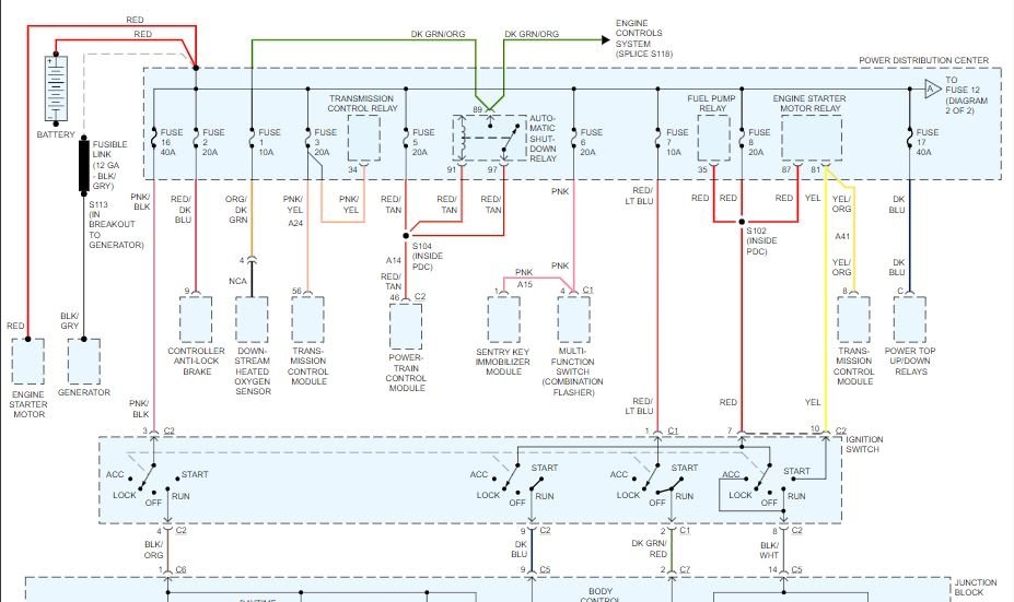

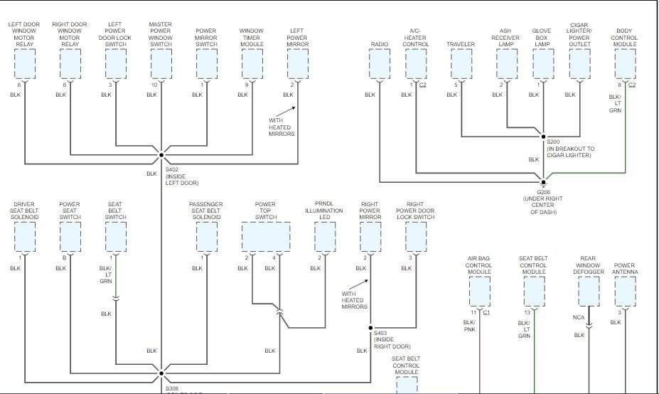

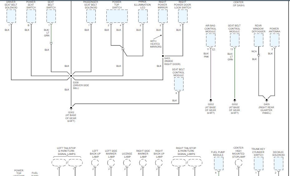

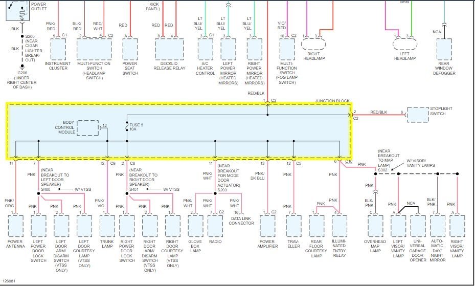

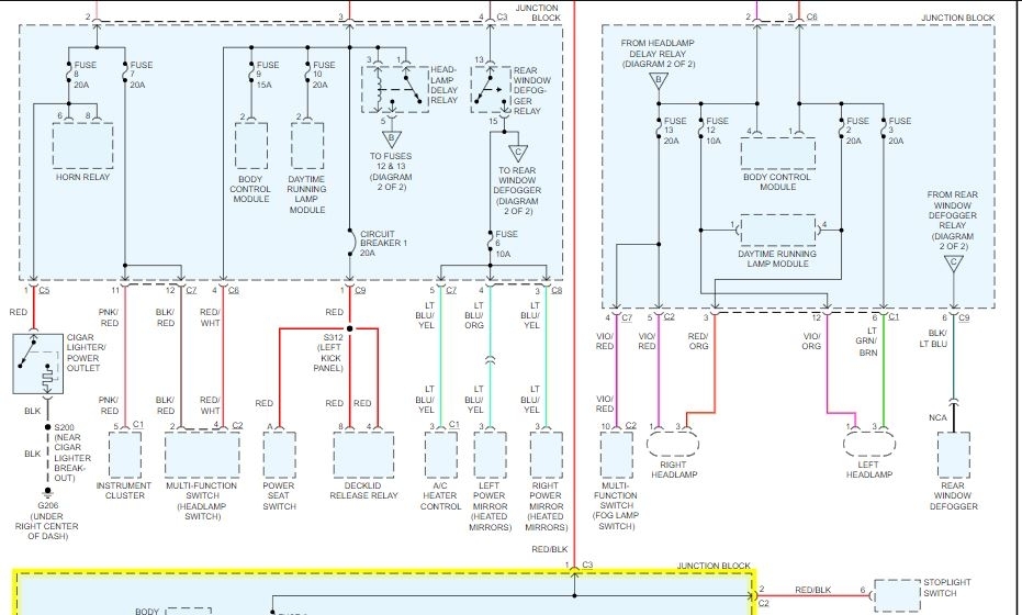

  • 109,896 POSTS

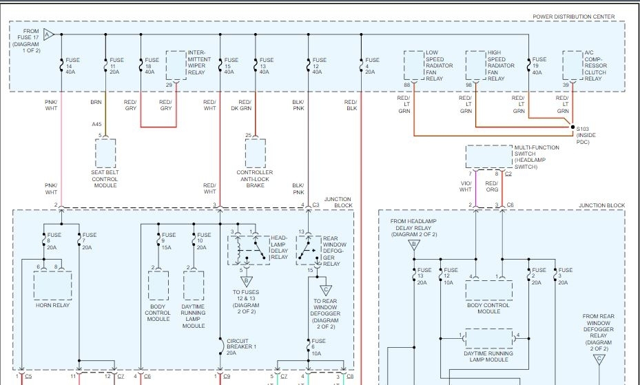

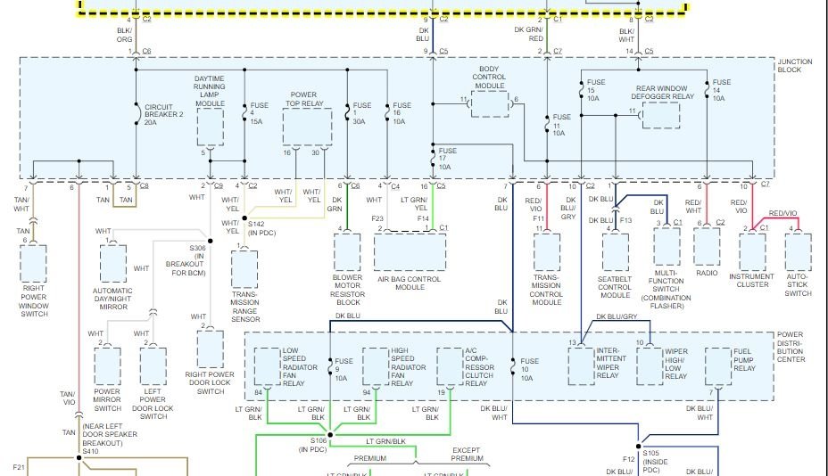

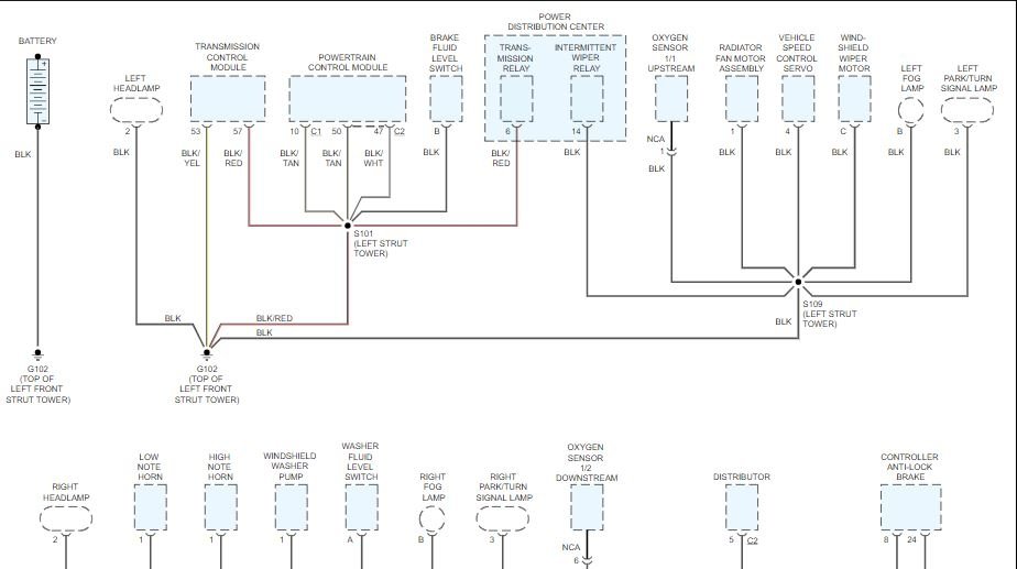

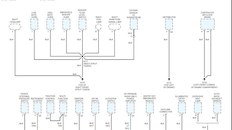

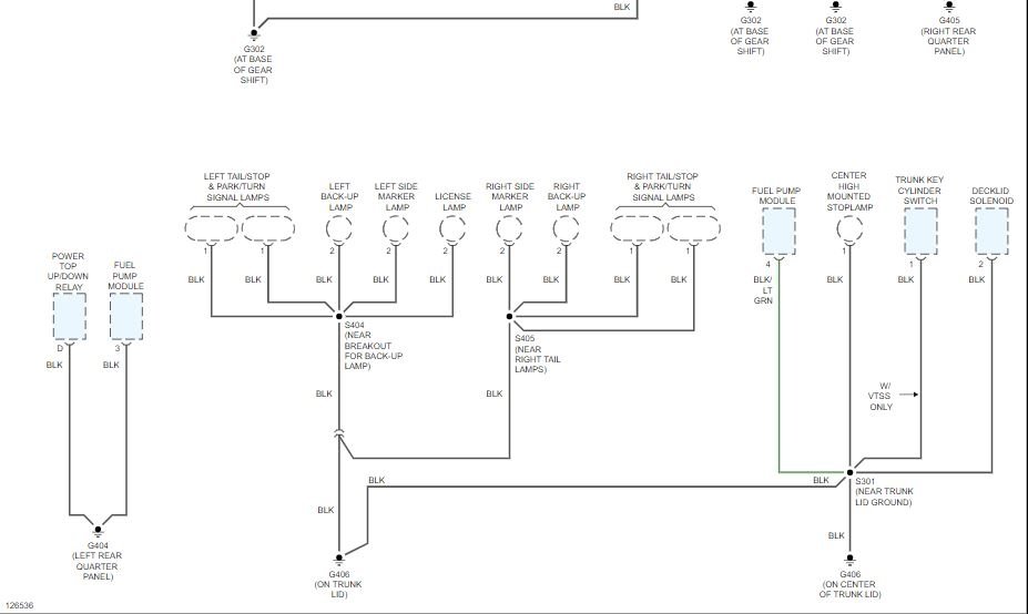

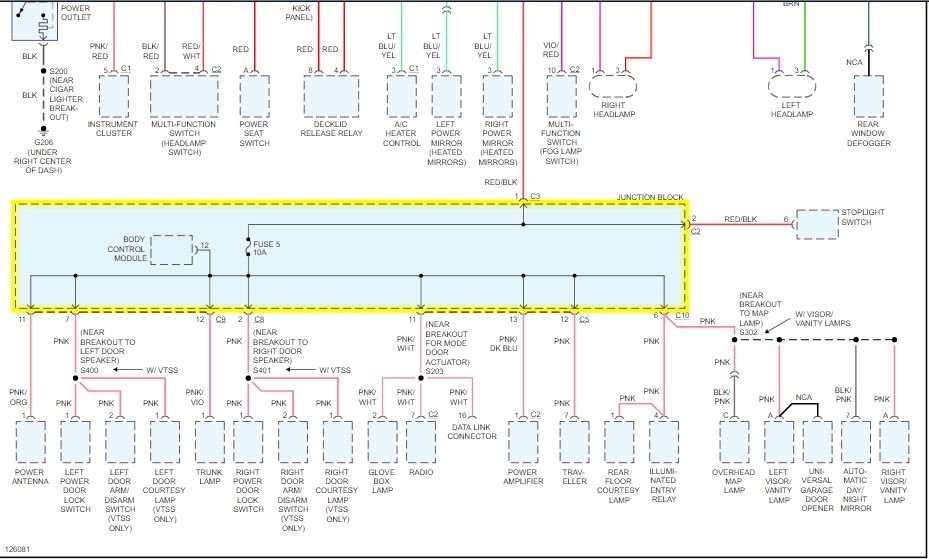

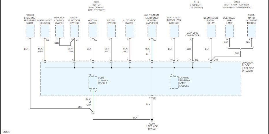

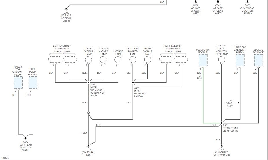

I attached the power and ground schematics for you. The first six are of the power. The second six are ground. I had to enlarge them for you to read and then break each page into three sections. I overlapped them so you can follow them.
Let me know if this helps.
