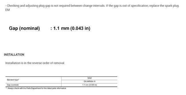

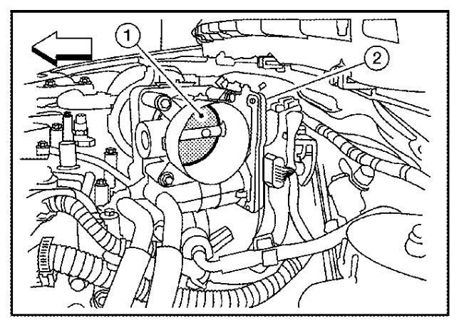

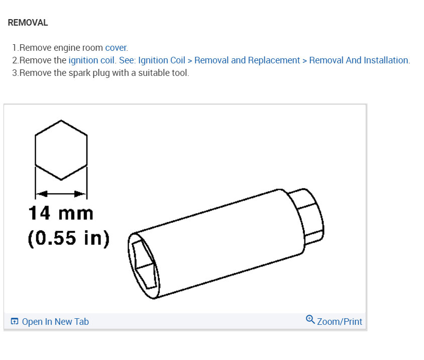

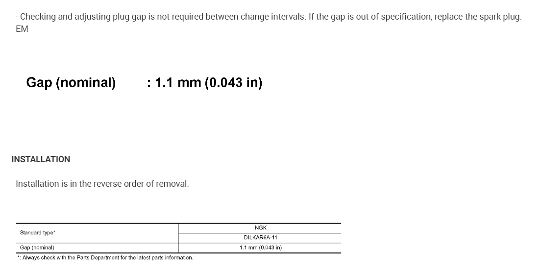

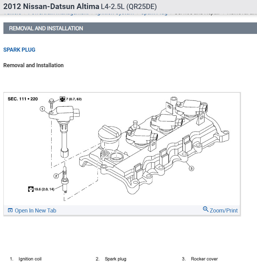

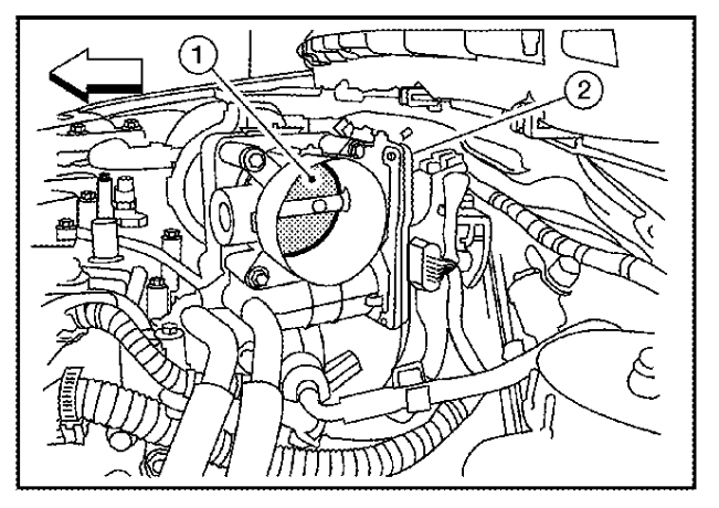

This happens when the engine starts to misfire. I would do a full tune up with a throttle body service. here are two guides to help you fix the problem:
https://www.2carpros.com/articles/how-to-tune-up-a-car-engine
and
