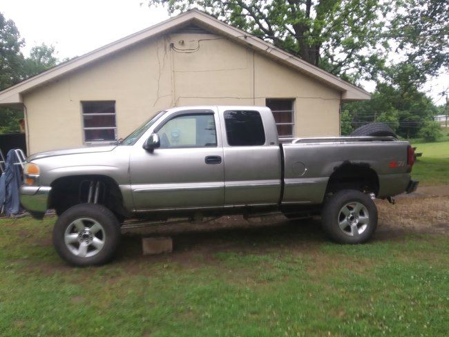

I have a jingling sound coming from somewhere in my truck. I only hear it when I pass a wall of any sort or road divider. Not getting louder and gets slower or faster depending on whether acceleration or deceleration. I replaced my front wheel bearings and all other components in the area. And I put a used rear on about 14 months ago. The noise started for the first time 2 weeks ago and doesn't seem to be getting worse. Seems to be on both sides far as I can tell and I'm not sure if it's the front or the back, but I've done so much up front I would expect it to be in the rear. I did install new rims but didn't have them balanced my self. They came off another truck that was wrecked but the tires receives no damage. What should I do?

Changing rims changed nothing. I tightened a few things, but no change at all in that either. I'm really not sure as to what else I could do to alleviate this sound/issue. Also if I didn't mention before, tnis truck is lifted 11 inches and has lots of extra parts under it.

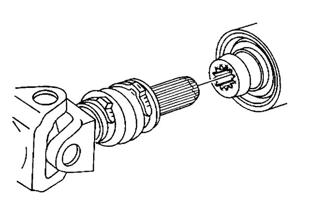

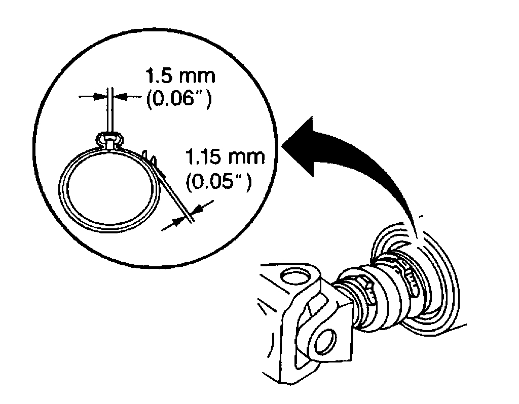

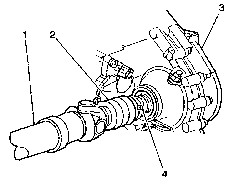

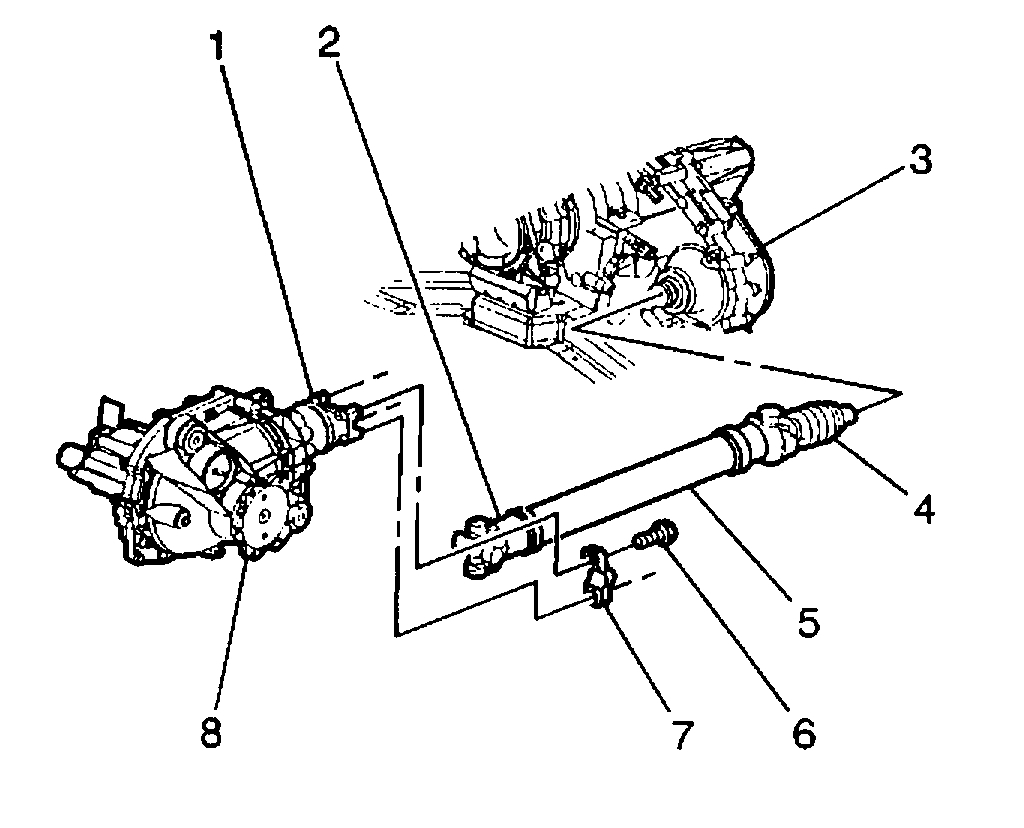

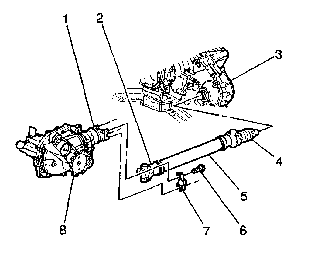

You have to remove the clamp on the rubber boot that attached the driveshaft to the output shaft on the transfer case. Here are the directions. The pics attached correlate with the directions.

pic 1
1. Raise the vehicle on a hoist. Refer to Vehicle Lifting.
2. Remove the transfer case shield. Refer to Shield Replacement.
3. Remove the clamp (4) at the transfer case (3) by prying up the exposed end of the clamp (4) with a flat bladed tool.
Important: Observe and accurately reference mark all driveline components relative to the propeller shaft and axles before disassembly. These components include the propeller shafts, the wheel drive shafts, the pinion flanges, the output shafts, etc, All components must be reassembled in the exact relationship to each other as they were when removed. In addition, published specifications and torque values, as well as any measurements made prior to disassembly must be followed.
4. Reference mark the relationship of the propeller shaft (5) to the front axle flange (1).
Pic 2
5. Remove the bolts (6) and the yoke retainers (7) from the front axle flange (1).
Important: Do not pound on the propeller shaft when trying to disconnect the propeller shaft.
6. Slide the propeller shaft rearward enough in order to disengage. Move the propeller shaft forward.
Important: Avoid dropping the bearing cap assemblies of the yoke end.
7. Remove the propeller shaft (5).
8. Inspect the propeller shaft (5) for any evidence of damage.
Installation Procedure
pic 3
1. Verify that the splines of the transfer case are coated with sufficient grease. If not, use special Teflon grease (GM P/N 9985830). Refer to Fluid and Lubricant Recommendations.
2. Place the new clamp in the groove of the propeller shaft boot.
3. Install the propeller shaft splines into the transfer case output shaft.
4. Install the boot onto the transfer case output shaft until the boot snaps into the groove on the OD of the output shaft.
Pic 4
5. Crimp the clamp using the J 43218 according to the crimping specifications.
Pic 5
6. Install the propeller shaft (5) to the front axle flange (1).
7. Line up the reference marks made previously.
Notice: Refer to Fastener Notice in Service Precautions.
8. Install the yoke retainers (7) and the bolts (6).
Tighten the yoke retainer bolts to 25 Nm (19 ft. Lbs.).
9. Install the transfer case shield. Refer to Shield Replacement.
10. Lower the vehicle.
___________________
Let me know if this helps.
