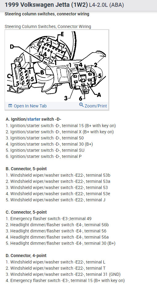

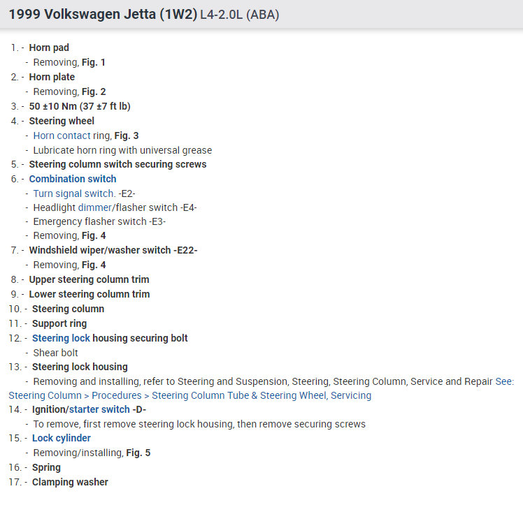

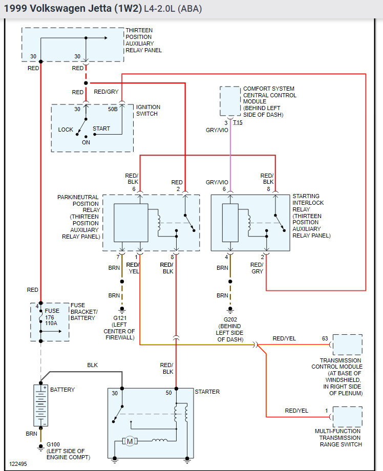

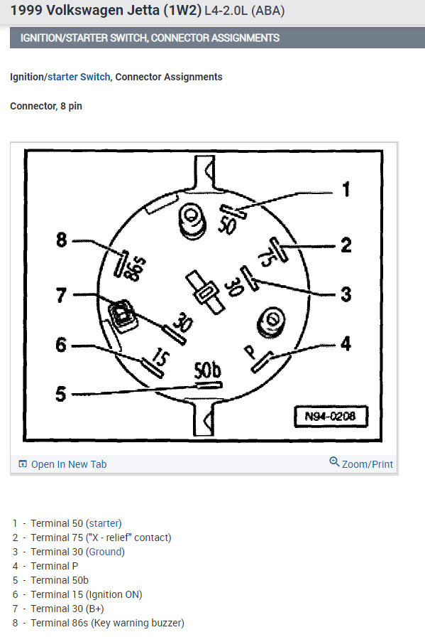

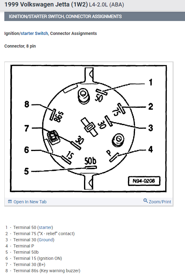

If you are not getting anything when you turn the key. The it could be the ignition switch or a short in the wiring to the starter.
The ignition switch is the electrical component that the lock cylinder attaches to.
It has a several pins and the pin for the starter could be loose or corroded.
This might require checking few items like the wiring, fuses and the switch.
