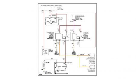

Car has brand new battery, lights go on, radio works, but the engine will not turn over.

Do you mean it won't crank at all/nothing or it cranks and w/n start.
Monday, August 27th, 2018 AT 8:01 PM
VINACCO
The car will not crank at all
  • 75,992 POSTS
Test the ignition switch/park and neutral position relay/starting interlock relay both is in the thirteen position auxiliary panel
https://www.2carpros.com/forum/automotive_pictures/12900_start_circuit_3.jpg
+3
VINACCO
I just want to make sure that I am looking in the right place, could you please tell me where the pannel is located, also could a bad starter do the same thing.
  • 75,992 POSTS
Sir-I tried my very best to come up with the location of the panel but to no avail in my references. For the starter-get a helper to hold key at cranking position and tap on the starter if it engages the engine replace it.
Monday, August 27th, 2018 AT 8:02 PM
VINACCO
Finally got the car to start it was the starter, then could not get car to go into gear, (automatic), no brake lights. Replaced the brake light switch which had a recall, still no brake lights and the car will not go into gear.
  • 75,992 POSTS
Get the shift interlock system checked out
