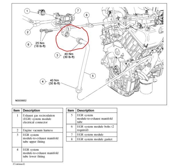

My SUV sounds like a jet engine after I had the radiator replaced 2 weeks ago. Today I replaced the fan clutch but that did not solve the problem. The thermostat was also replaced about a month ago too. Is it the coolant temperature sensor?

Can you upload a video of the noise?
I have heard this before and found a clogged cat converter forced exhaust back through the EGR valve. I would remove the line from the EGR valve and see if the noise goes away.
This has nothing to with the cooling system.
Exploded View
Removal and Installation
1. Disconnect the exhaust gas recirculation (EGR) system module electrical and vacuum connectors.
2. Disconnect the EGR system module-to-exhaust manifold tube upper fitting.
To install, tighten to 40 Nm (30 lb-ft).
3. NOTE: When installing the new EGR module gasket, install with the side with the raised circle facing the intake manifold.
Remove the bolts, the EGR system module and the gasket. Discard the gasket.
To install, tighten to 25 Nm (18 lb-ft).
4. NOTE: The EGR system module sealing surfaces are soft metals.
Carefully clean the EGR system module sealing surfaces.
5. To install, reverse the removal procedure.
Install a new EGR system module gasket.
