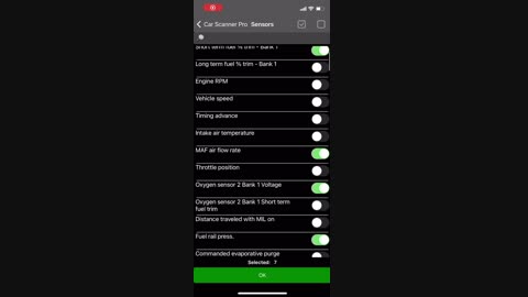

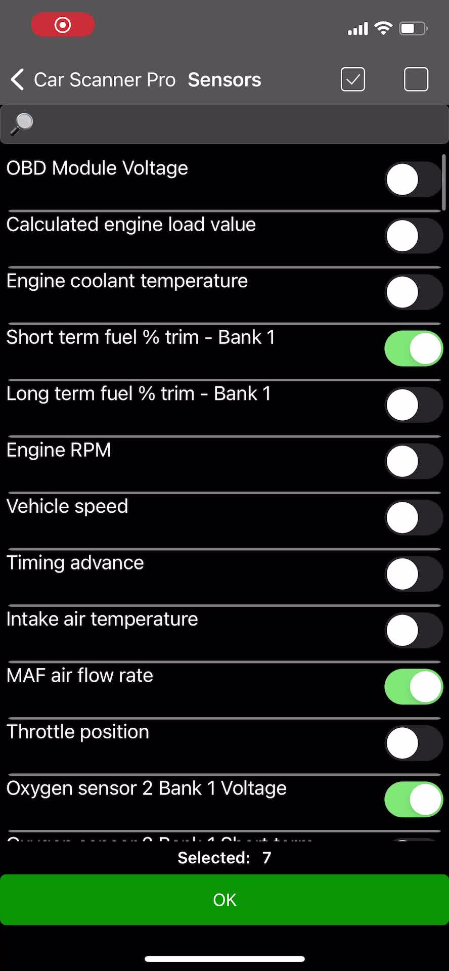

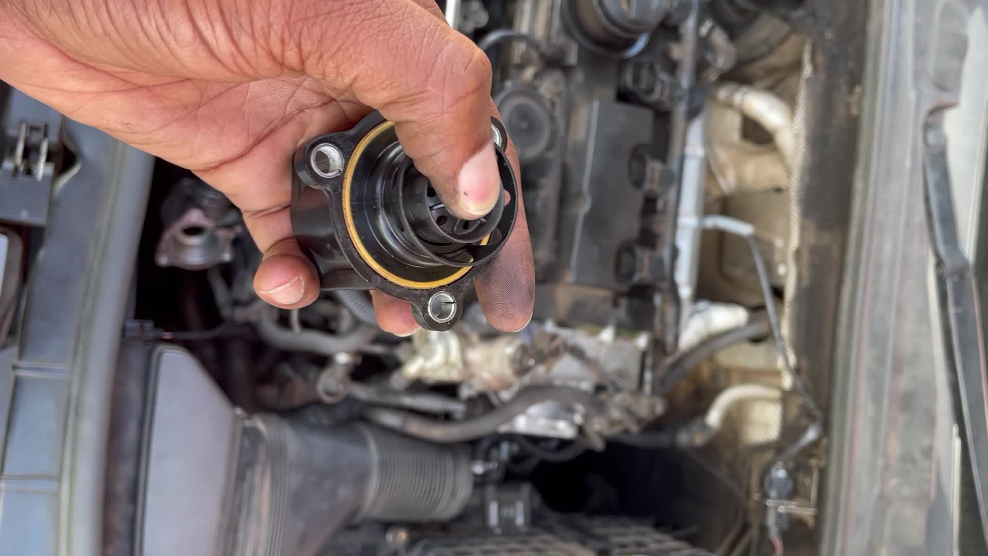

I have recorded a couple of videos which I have attached below. I have examined the diverter valve and it seems to be in good working order. Plus it's a D revision which has a piston as opposed to the G revisions which had a diaphragm.
I have also made a recording of some live data which includes MAF airflow rate, OS sensors current and voltage, fuel rail pressure as well as STFT(No audio though). I added a video that shows hunting revs at idle (this is intermittent)

I have recorded some vides which i have attached below. These include a video of live data for MAF airflow rate, O2 sensors' current (Pre-cat) and voltage (post cat), fuel rail pressure as well as STFT.

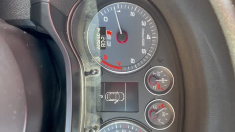

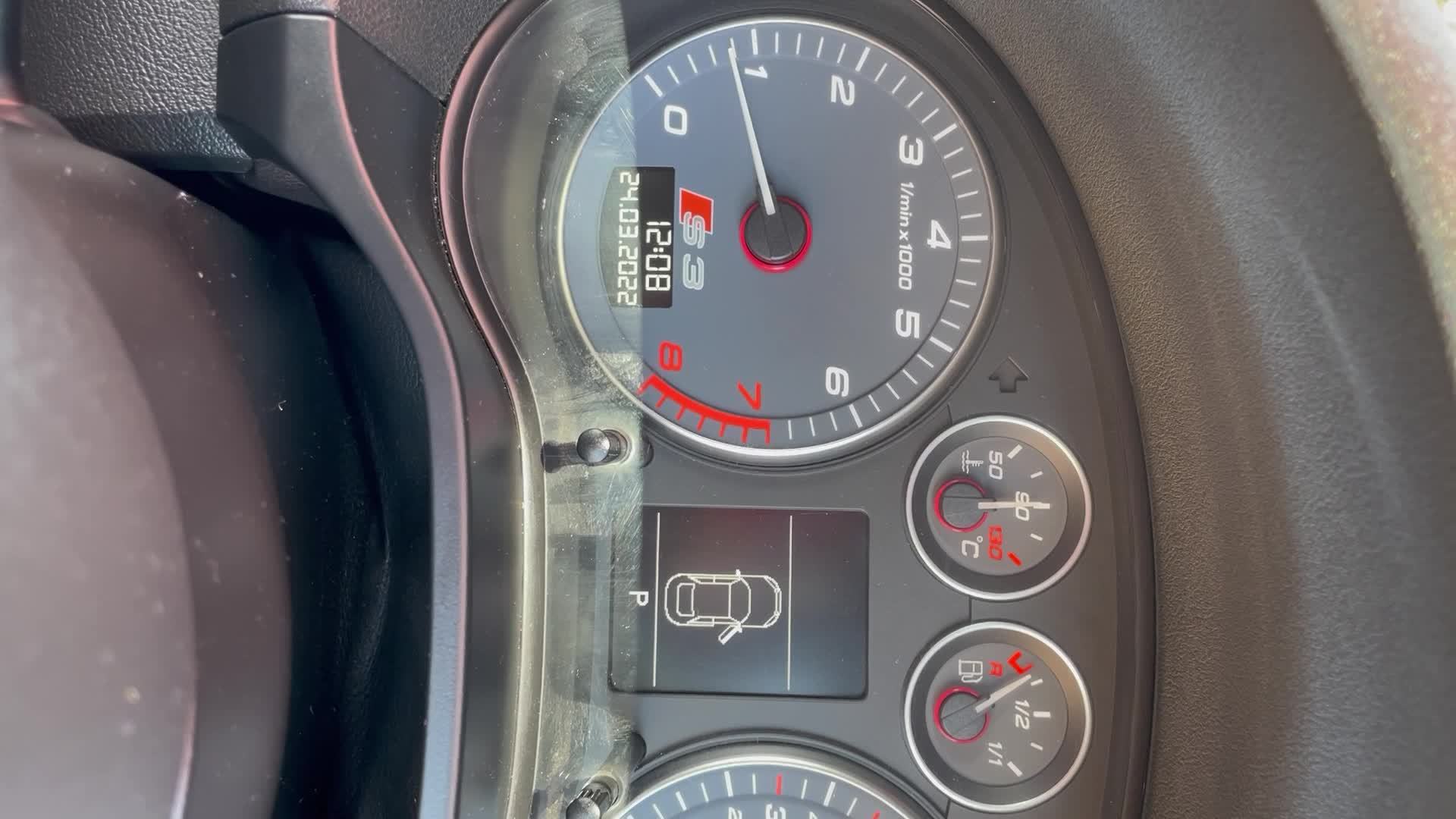

Another video shows revs hunting a bit at idle (this is intermittent). I have inspected the diverter valve and it seems to be in good working order (plus it's revision D with a piston and not a diaphragm).

When I inspected the diverter valve, I noticed that it has two parts that fit into each other and on removal, the two parts came apart. I was wondering if the valve should be one solid unit when in good condition...?

The diverter valve shouldn't be two parts. It is a one-piece unit. Also, the updated one usually has a blue ring at the end.
Also, I did see the videos. In the first one, I noted the jumping of the tachometer. The way that acted appeared to be more electrical than mechanical.
