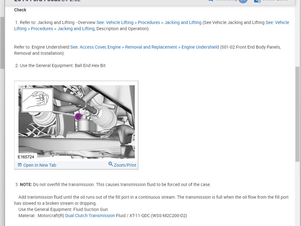

My car is hesitating to accelerate at low speeds, especially from a stop. When it does finally accelerate after stepping on the gas for a few seconds it jerks pretty harshly. No smells or sounds other than a clunk when it jerks. It's fine otherwise.

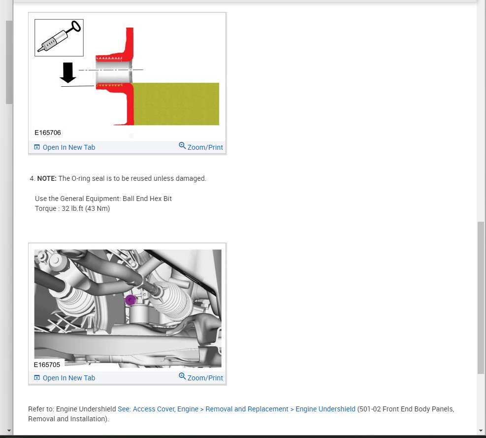

Let's start with checking the transmission fluid and see if it is low or in poor condition. Your unit is what is called a dual dry clutch which is basically a manual transmission that is shifted automatically. So, I attached the info below on how to check that.
https://www.2carpros.com/articles/how-to-check-and-add-transmission-fluid
