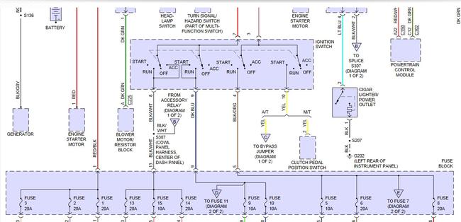

Jeep won't turn over. I already replaced the ignition switch. No power to interior fuse box
Saturday, September 26th, 2020 AT 12:33 PM (Merged)
JDL
  • 16,098 POSTS
Battery has a full charge, both battery cables, good? Did you track the positive battery connections to follow the voltage. I haven't looked at your wiring, yet? There is always the wiring--fusible links--whatever.
SHEILAZ
  • 7 POSTS
Battery good. Battery terminal good. Power good under the hood. No power going to interior fuse box and no fusible link

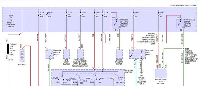

JDL
  • 16,098 POSTS
Just to add, you mentioned ignition switch, note the wiring. The wires going into ignition switch at the top are hot all the time. One wire is red, the other is pink with a black tracer, check for voltage.
The wires coming off the bottom of switch in the diagram go hot with the ignition switch in various positions, start--run--acc--whatever. Note the wire colors, check for voltage.
SHEILAZ
  • 7 POSTS
I disconnected plug from ignition switch, pink wire with black stripe is the only one that has power
JDL
  • 16,098 POSTS
The info I looked at was for jeep wrangler sport. For voltage on red wire, check fuse 3--30amp, underhood power distribution center. Not only check the fuse, check for voltage on the fuse circuit.

SHEILAZ
  • 7 POSTS
F3 fuse is good all power good in fuse box under hood all fuses good under hood where do I check next?

JDL
  • 16,098 POSTS
If the red wire at ignition switch, has no voltage. I'd replace the red wire from underhood fuse box for the proper fuse to ignition switch. Could be problem with wiring from underhood fuse box to ignition switch?
I'd have to check voltage on the red wire, hopefully we're talking about the same wire?
