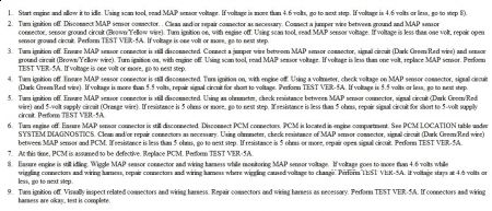

Have code P108 changed map baro- sensor
Wednesday, March 10th, 2010 AT 3:17 PM
BLUELIGHTNIN6
  • 16,542 POSTS
Did you erase the trouble code after replacing sensor? if not, go ahead and do that and see if it comes back. if it doesnt then map sensor was the cause, if it comes back same code then you will need to follow test steps below to pinpoint cause of code.
https://www.2carpros.com/forum/automotive_pictures/261618_Noname_1849.jpg
