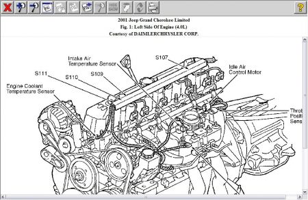

2001 Jeep Grnd Chrkee/59,900 miles 8cyl. The idol on my car is too low and causes the engine to stop especially when you first start it. The car has low milleage as mentioned and no known issues. I do hear something ticking which I think its just the fuel injection. I didn't do the diagnostic yet.

Lets find this IACM remove and clean it and passages and let see what happens.

Locate the idle air control motor (IAC), remove it, and clean the motor and its passages, then retest the idle.
